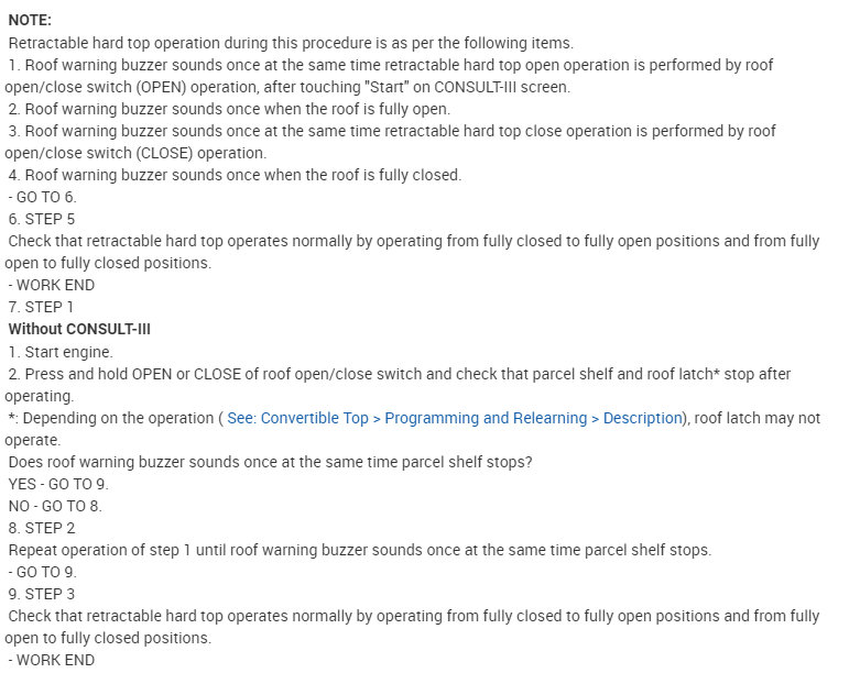

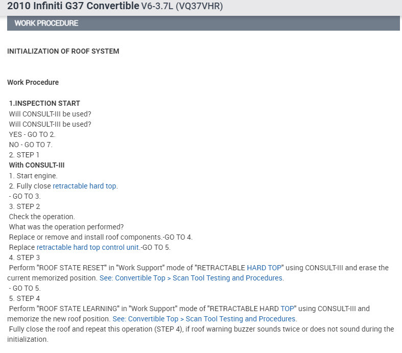

To initialize/reset the convertible top module you will have to use a specialty scan tool.
Infinity does not provide us with any other way to resetting it.
Also, you will need to retrieve the codes for that module. That way the issue is determined.
I have attached attached the procedure below for your reference.

Those instructions are to be used with a scan tool performing these types of reset.
Not sure about the battery cable trick. I have not seen one reset in that manner. It might work, but not something that is listed on the repair manual.
