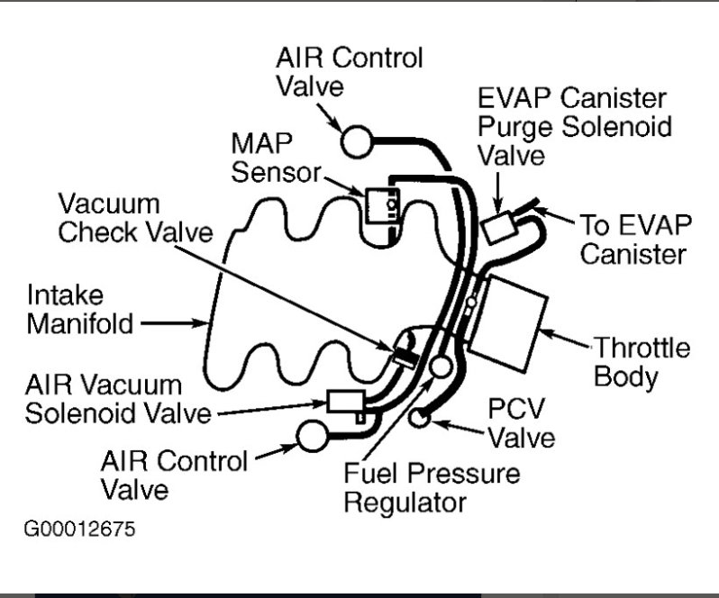

On my upper intake have a vac port connected to a plastic vac line that run in the wire harness where is this line for and where does it go

More than likely this is a line that runs from the EVAP to the intake or the intake to the PCV.
Here is a guide that will help with finding vacuum leaks if you need to find one:
Please see the info below which is a diagram that shows the routing of these lines.
Let us know what other questions you have. Thanks
