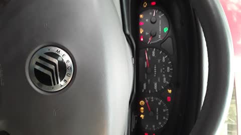

I have the car listed above with a 3.0L 24V Duratec engine. I have changed the spark plugs and it is full of oil. There is a bad engine knock coming from what I believe is cylinder 2. I believe it could be a rod knock due to bad bearing because I drove it too hard. I just need a second opinion before I start taking the car apart to figure out the culprit.

LYON022

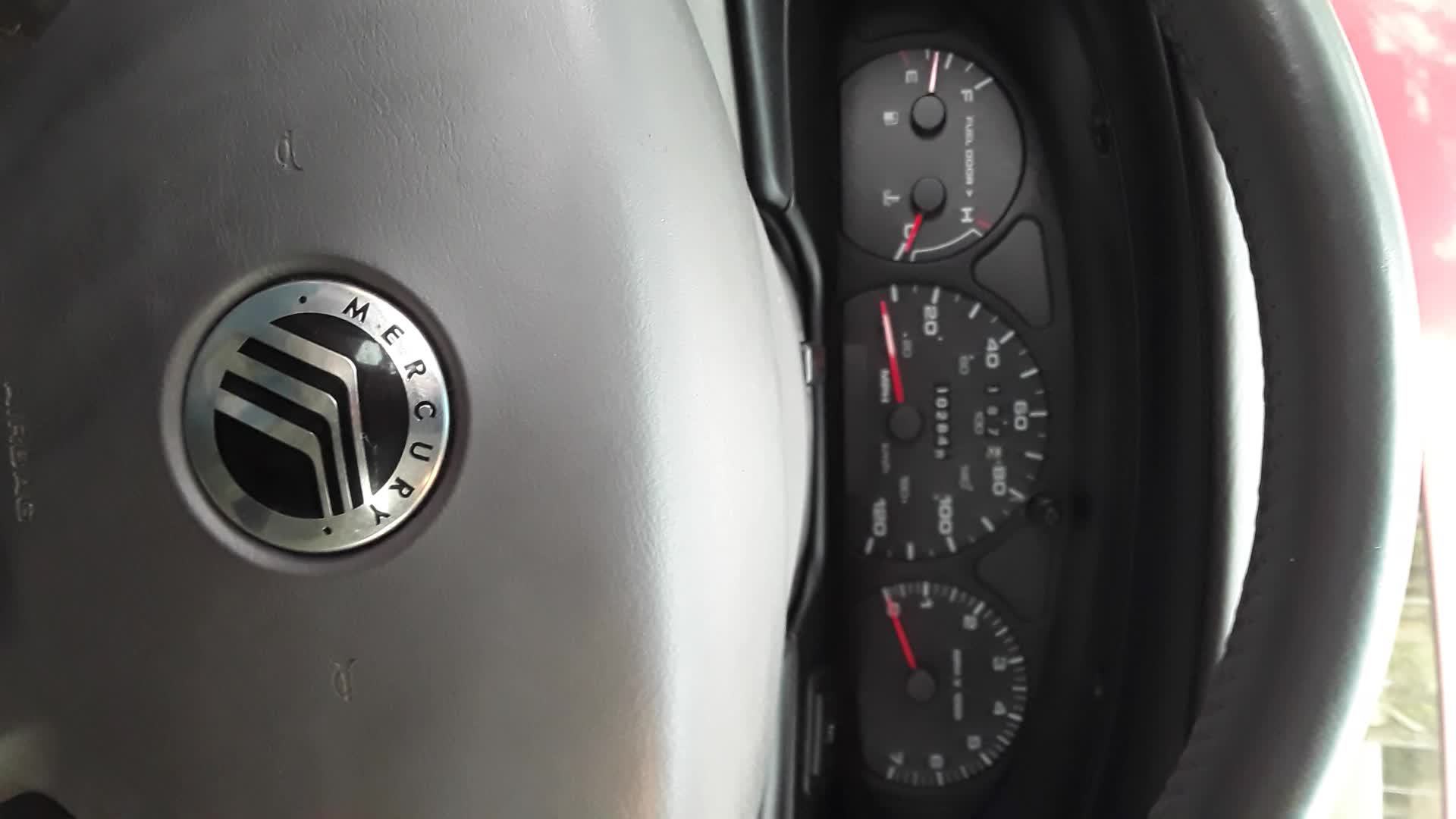

Good morning. I have the video for you. Hope it helps.
Nov 14, 2019 at 6:46 AM
You have either a broken piston, bad bearings or some other failure.
The bottom line is, you need a motor. You can either get a used motor or a rebuilt motor depending on what you want to spend.
