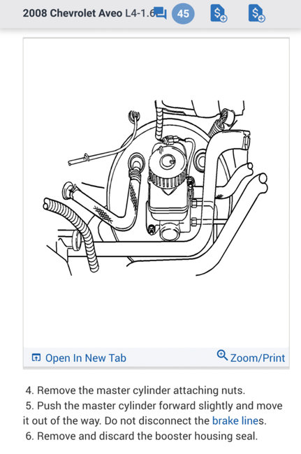

Lately in the morning I have noticed when I start driving and press the brake pedal, it sometimes is stiff. I have to pump it once or twice to get it to go down.
Is this a master cylinder/brake booster starting to fail?
Only happens after sitting overnight in cooler weather. It does not happen any other time.
Thanks for your help, Roosevelt.

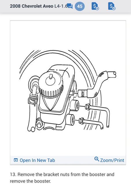

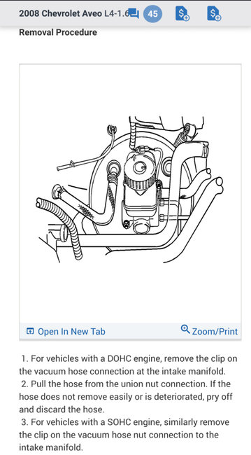

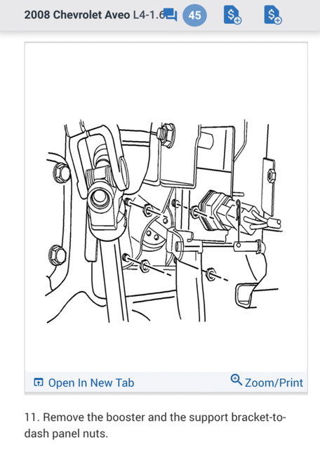

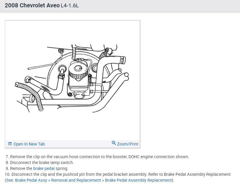

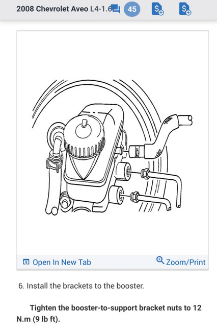

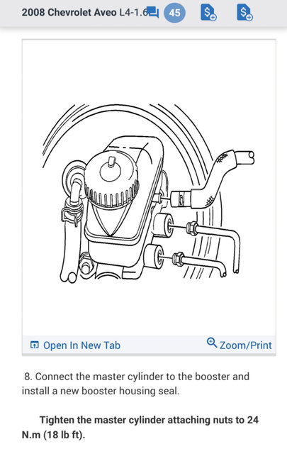

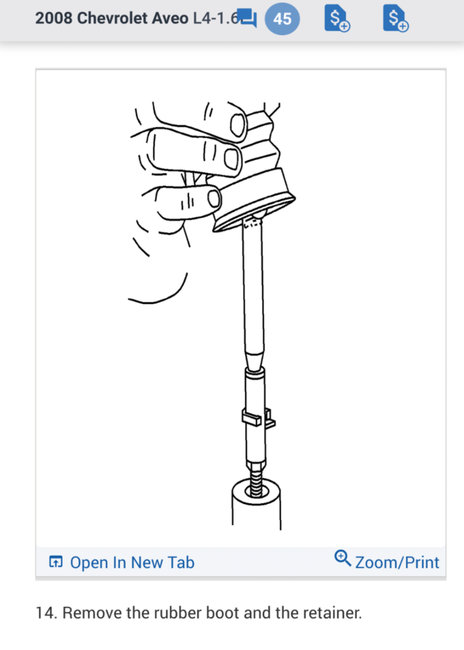

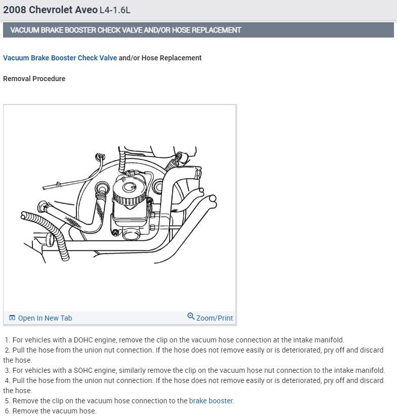

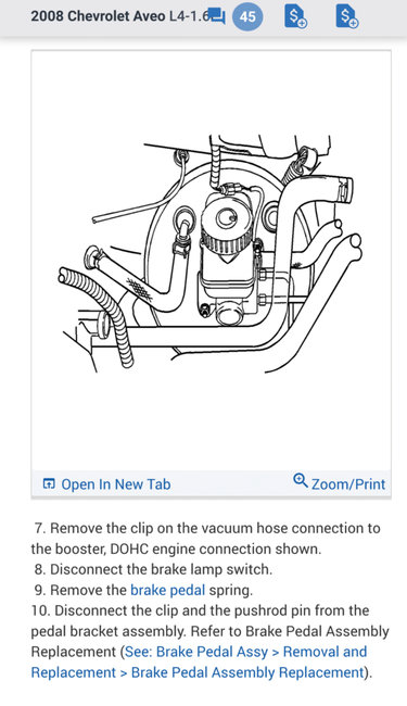

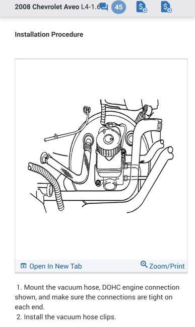

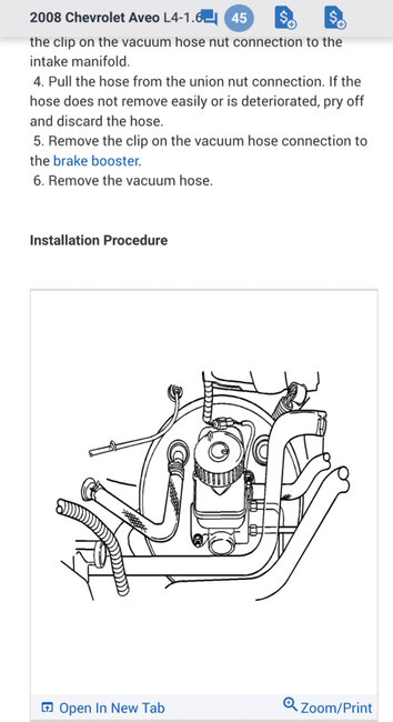

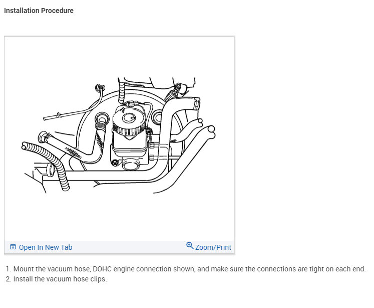

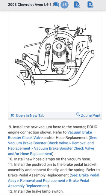

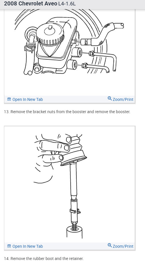

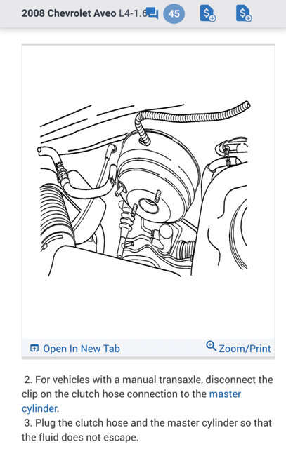

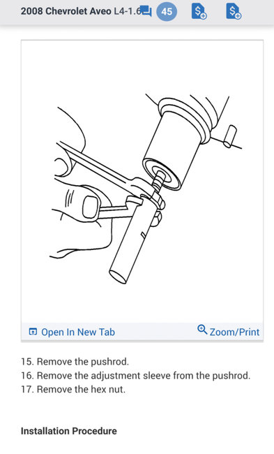

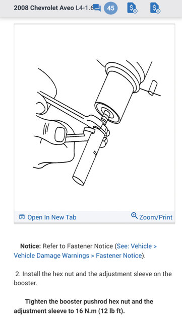

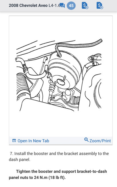

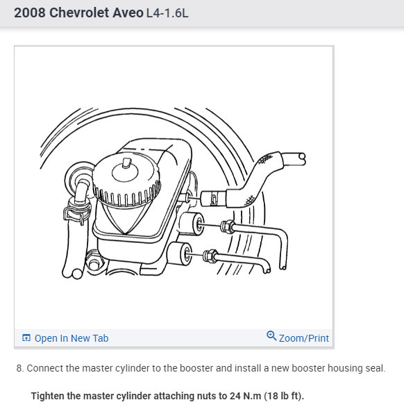

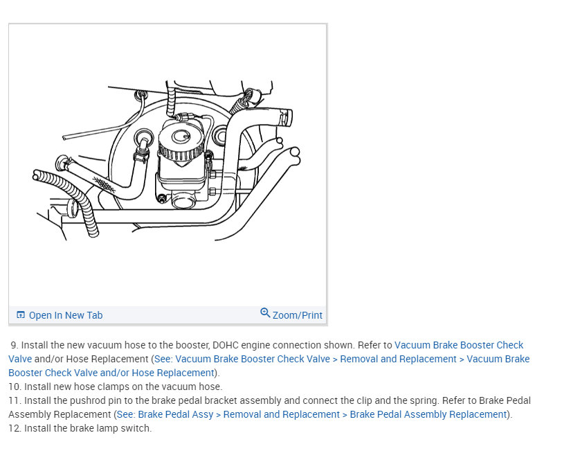

Hello, I'm Harry. Given your description, I would suspect the brake booster is failing. But first I'd check the vacuum lines for leaks. Especially the one going to the booster. Also take a good look at that check valve (mounted to the booster, vacuum hose one the other side of it). If it's allowing any blowback then it could easily be your issue. Replacing it is cheap and should be done even if you need a new booster too. I'm attaching instructions on the check valve to this post. I'll do another post shortly regarding removing and replacing the booster.
May 12, 2021 at 8:14 AM
HARRY P
  • 2,292 POSTS

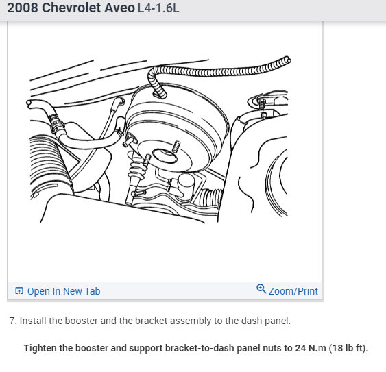

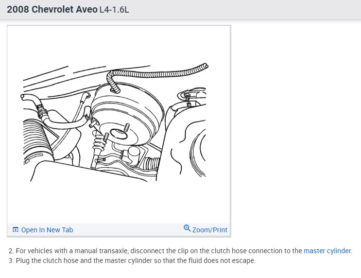

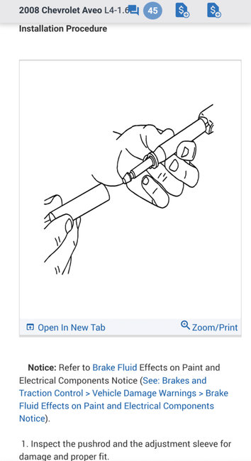

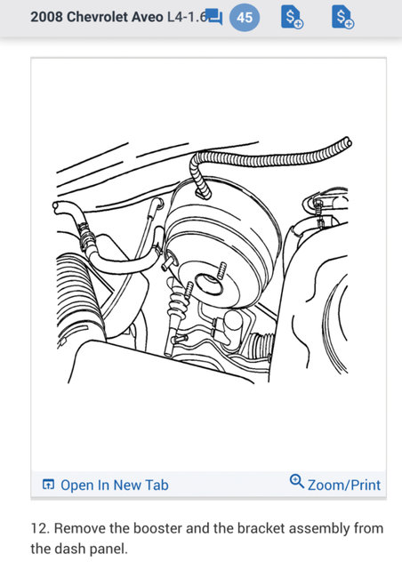

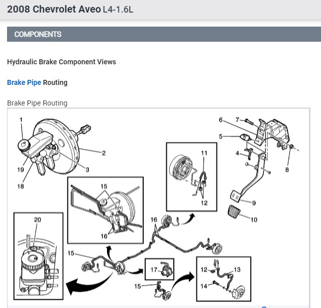

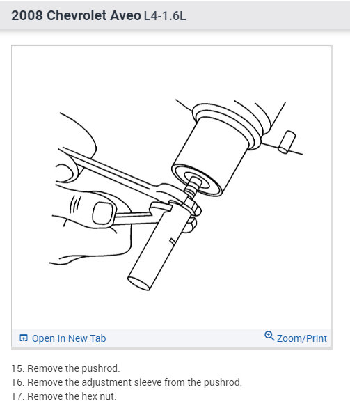

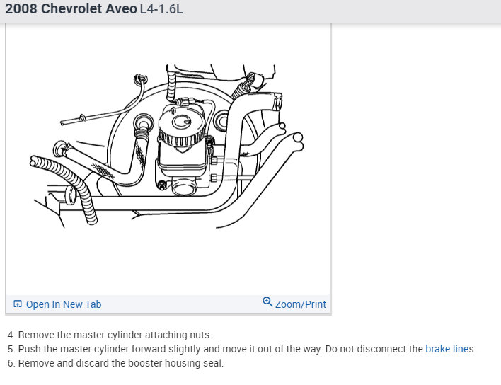

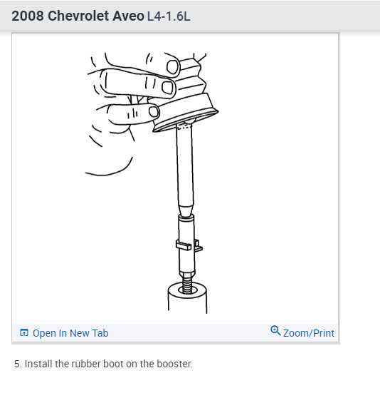

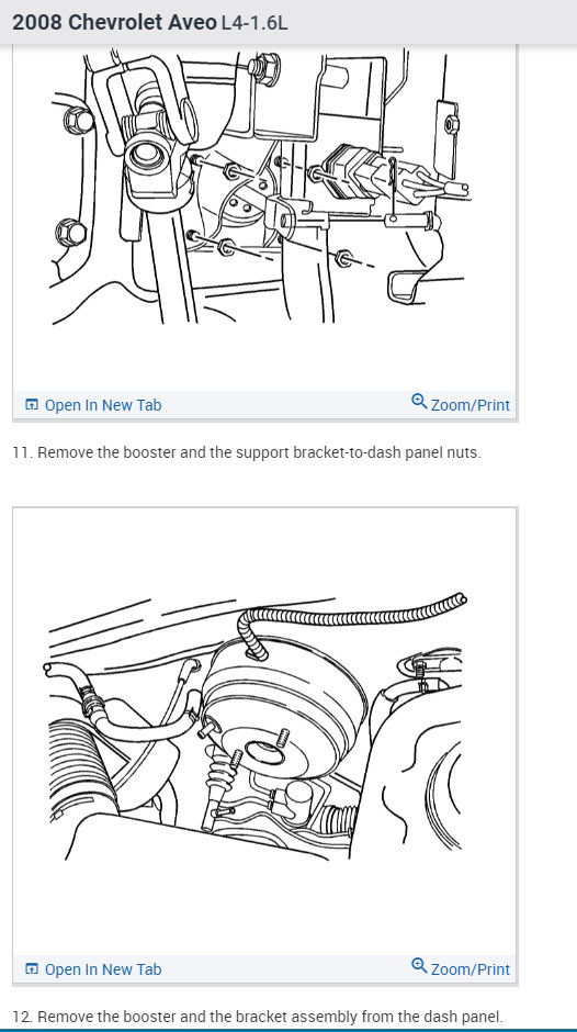

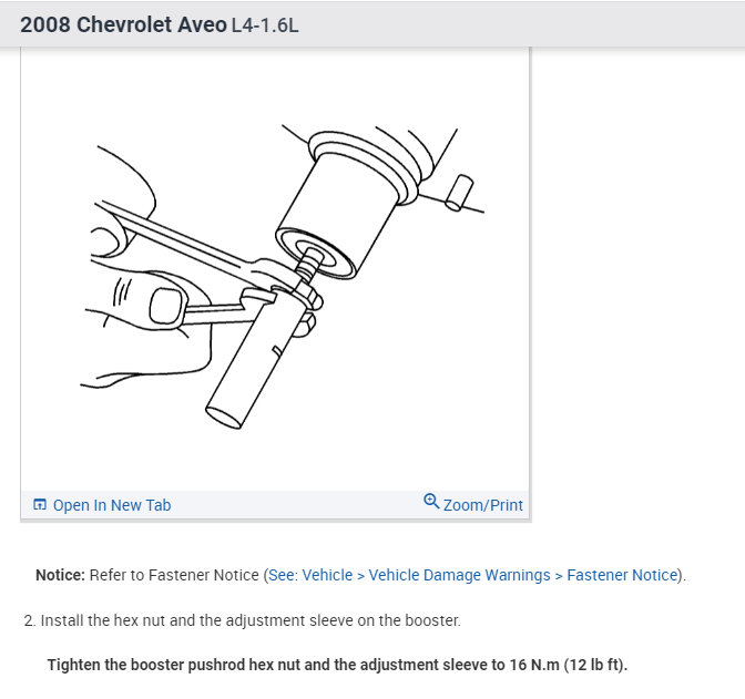

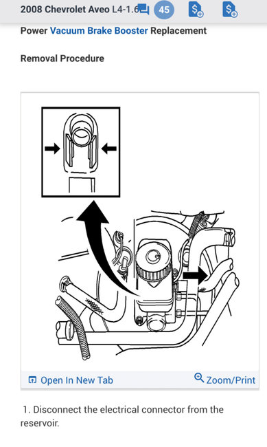

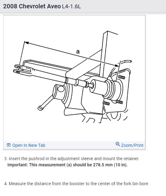

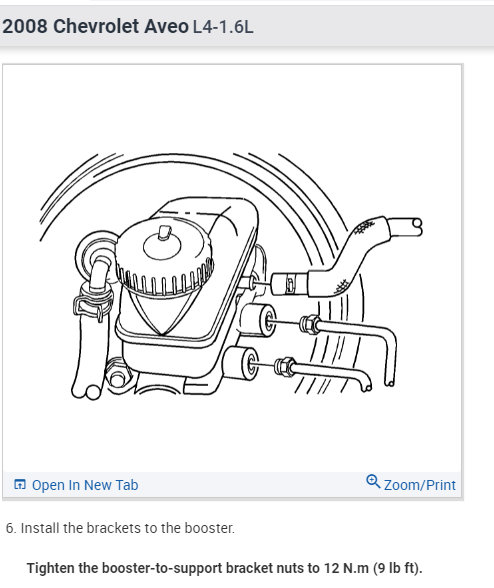

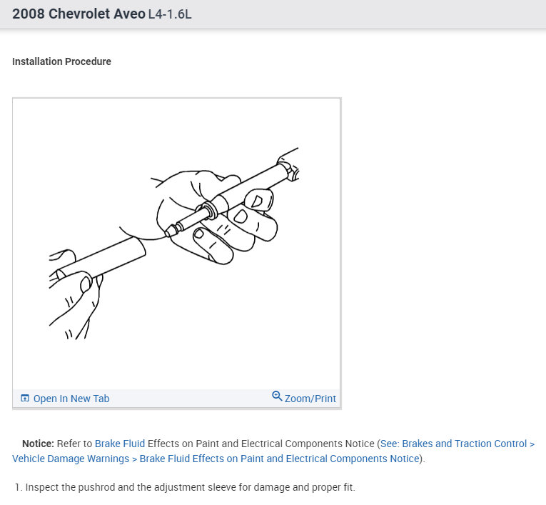

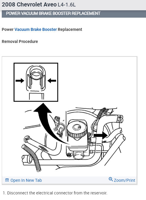

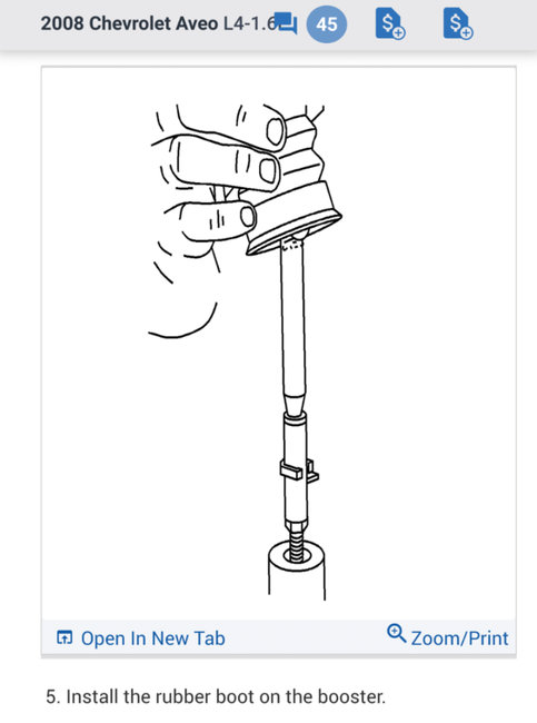

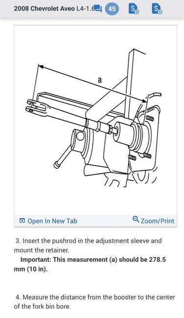

And here's the booster procedure. In my experience, while I haven't done the job on your specific vehicle, I suggest removing the driver's seat. It'll be a little more bearable.
May 12, 2021 at 8:33 AM

If he couldn't duplicate it, then my money is on that check valve. It's sticking occasionally. Eventually it'll get worse. I'd order one off of Amazon or Rockauto while it's not a pressing issue and either go ahead with replacement or at least have it on the shelf and ready. It'll be cheaper that way.

Hard brake pedal typically means a vacuum issue for the brake booster. It could due to a sticking check valve for the booster, especially when it's cold.
So yes, change the check valve and also make sure the hose does not have any cracks or leaks.

Hello, just wanted you to know it was the Brake Booster Check valve that was the problem on the vehicle. After keeping the vehicle overnight, my mechanic was able to duplicate the problem and replaced the part.
