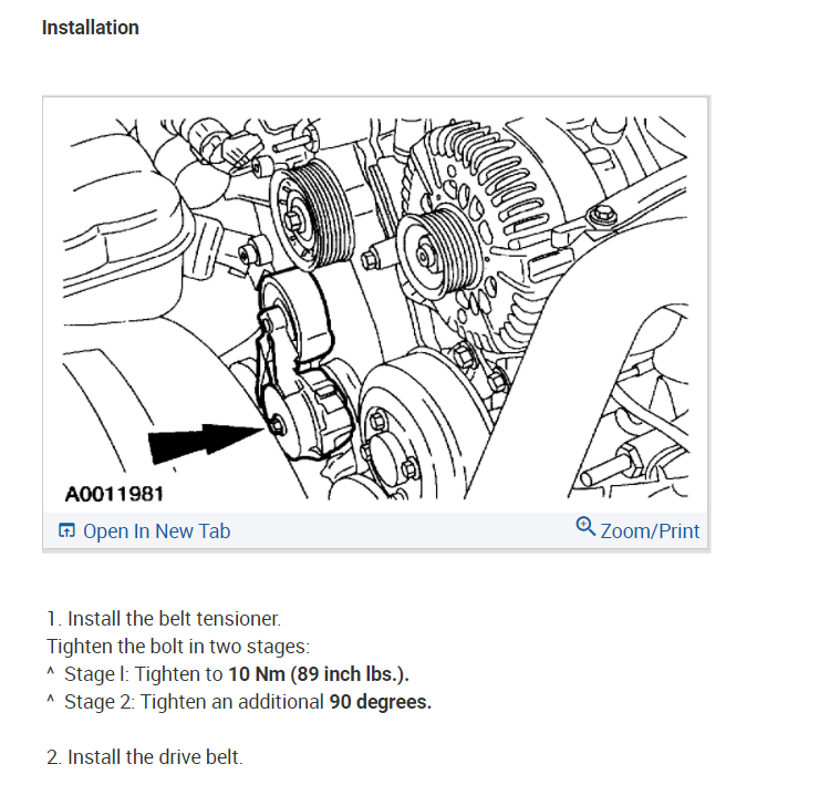

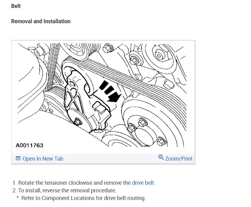

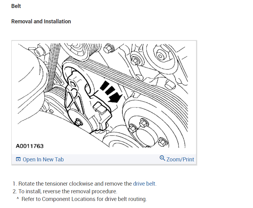

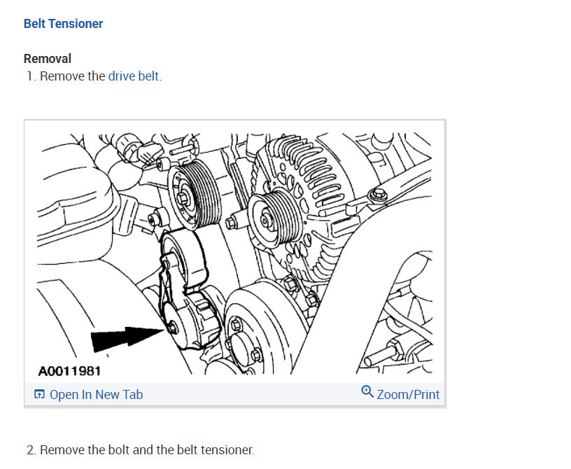

Also, check the drive belt as well. A loose or worn tensioner that keeps the belt tight may be causing the issue as well.
https://www.2carpros.com/articles/serpentine-belt-tensioner-replacement

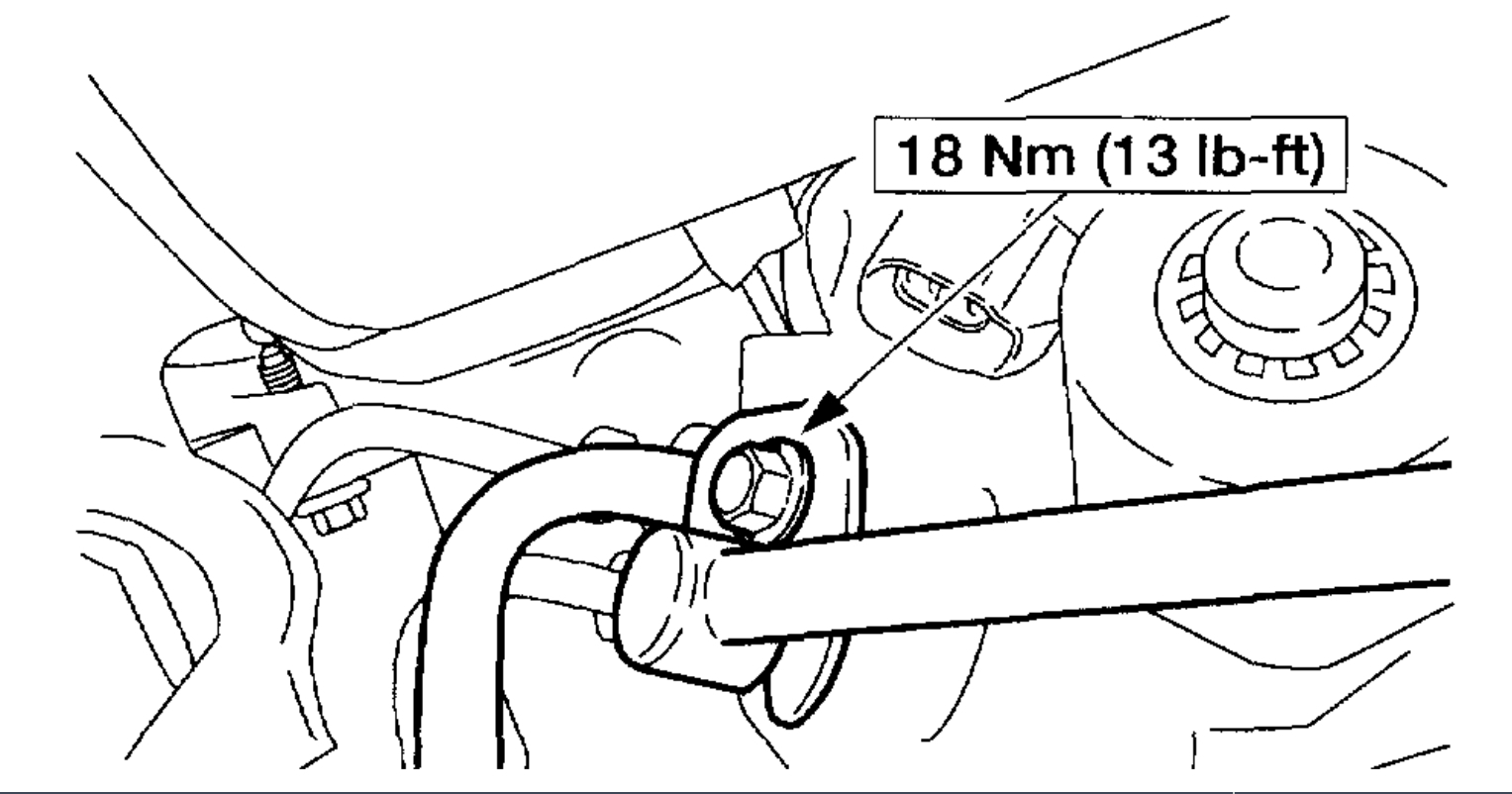

Before I flush the fluid, would unplugging the variable assist sensor help in diagnosing problem?
If so, where exactly is that sensor located?
Apr 22, 2021 at 6:51 AM
No, not at all.
If you have the sensor, it would be where the steering shaft from the car meets the steering gear. I attached the location of the sensor for you.

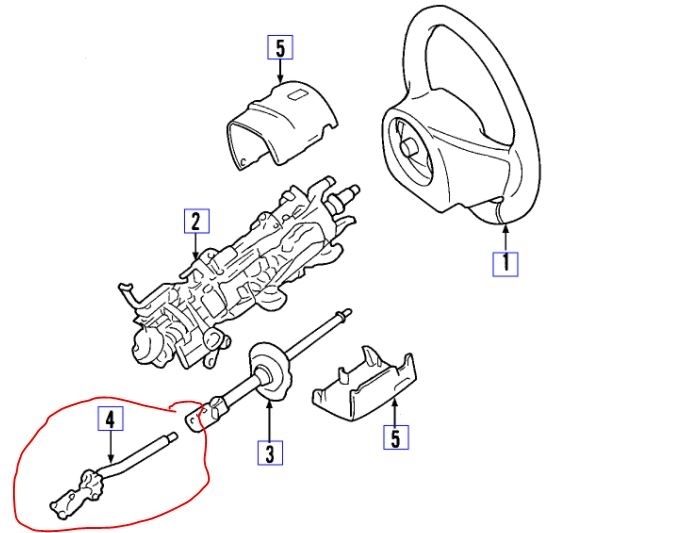

Thanks for the reply. I did not see the sensor, but squirted motor oil on the lower intermediate shaft , and steering was about 80% better but now is getting binding again, I believe that's the problem? Unfortunately Ford won't cover 2003 with its recall, only 2005 and up models. Is there such a thing as a silent recall that I can get them to change for free? If not is there a step by step procedure to remove this? Thank you
Apr 24, 2021 at 4:17 PM
Okay, you need to go under the dash and release the bolt that secures the shaft to the column.
then go to the rack where the shaft meets the rack and release the pinch bolt. Then the shaft will slide up and you can pull down and remove it.
