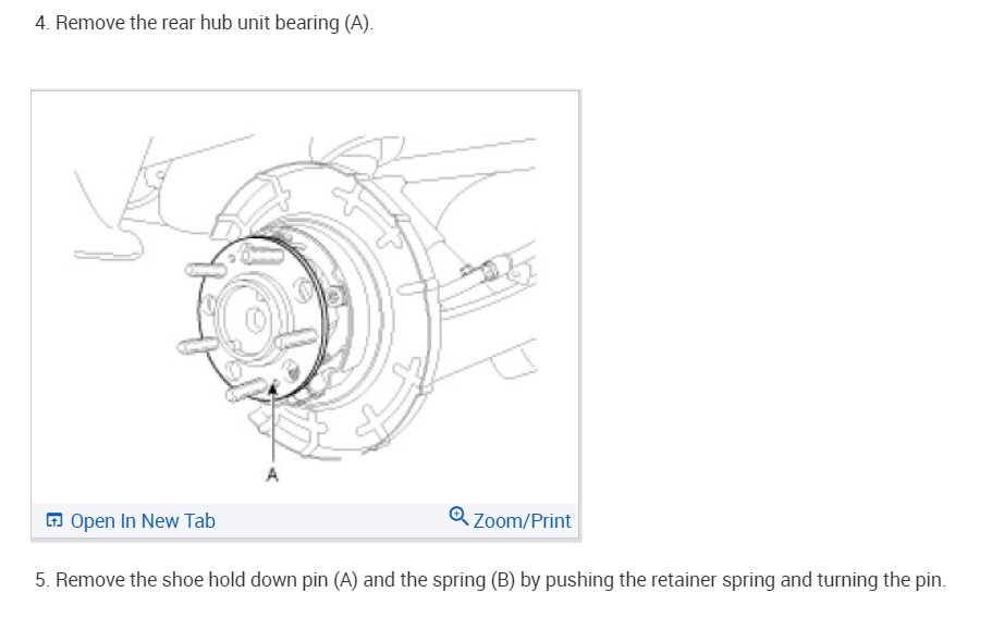

Handbrake shoes replacement guide needed?

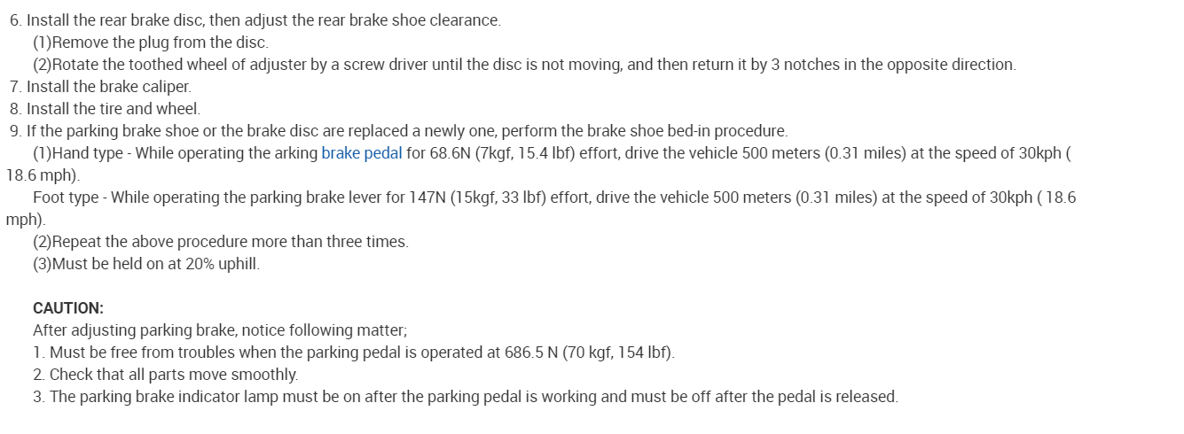

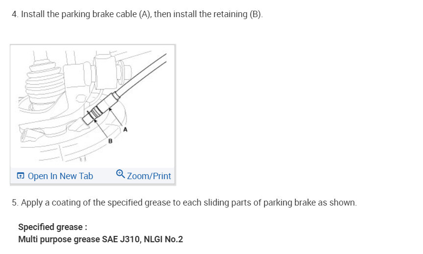

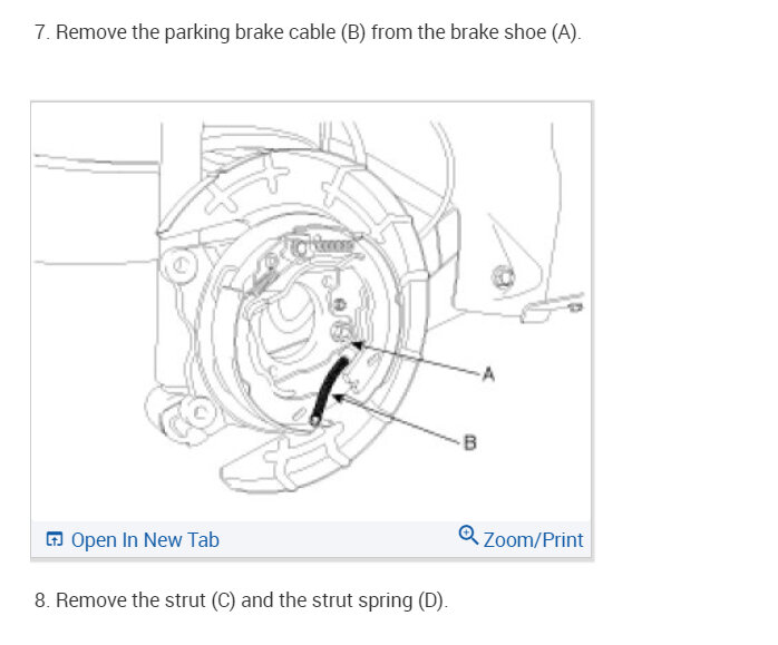

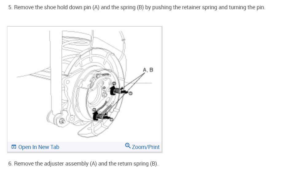

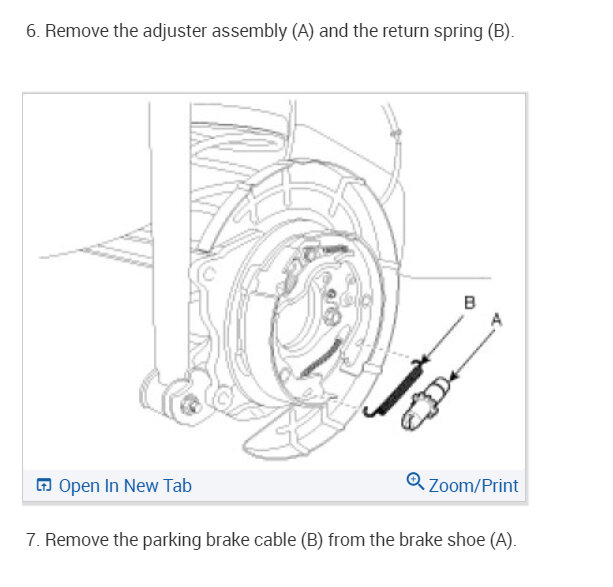

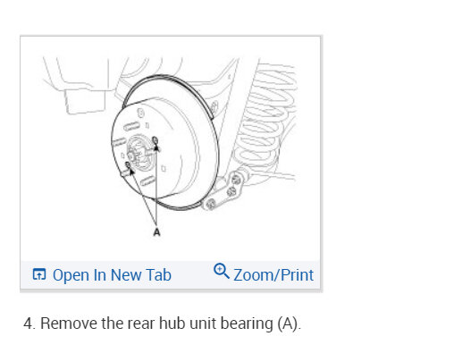

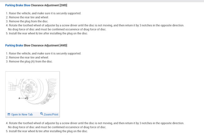

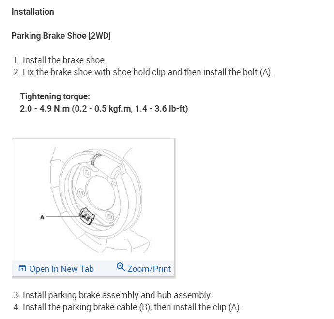

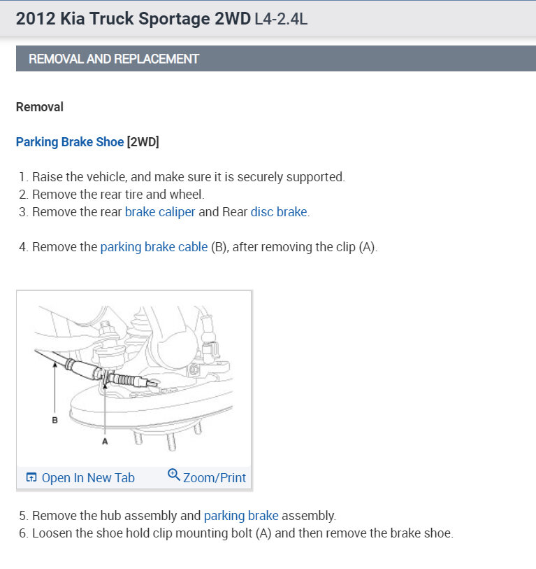

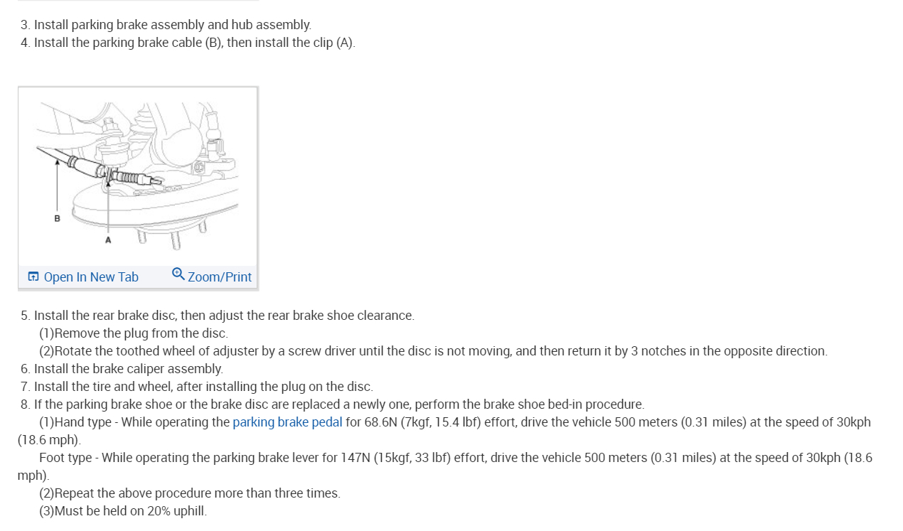

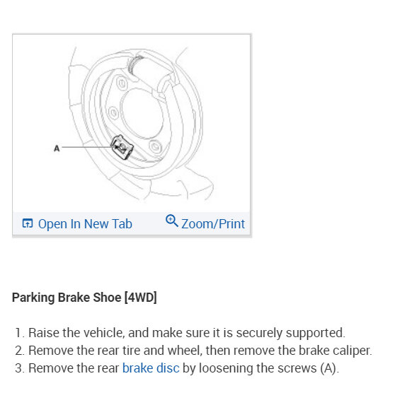

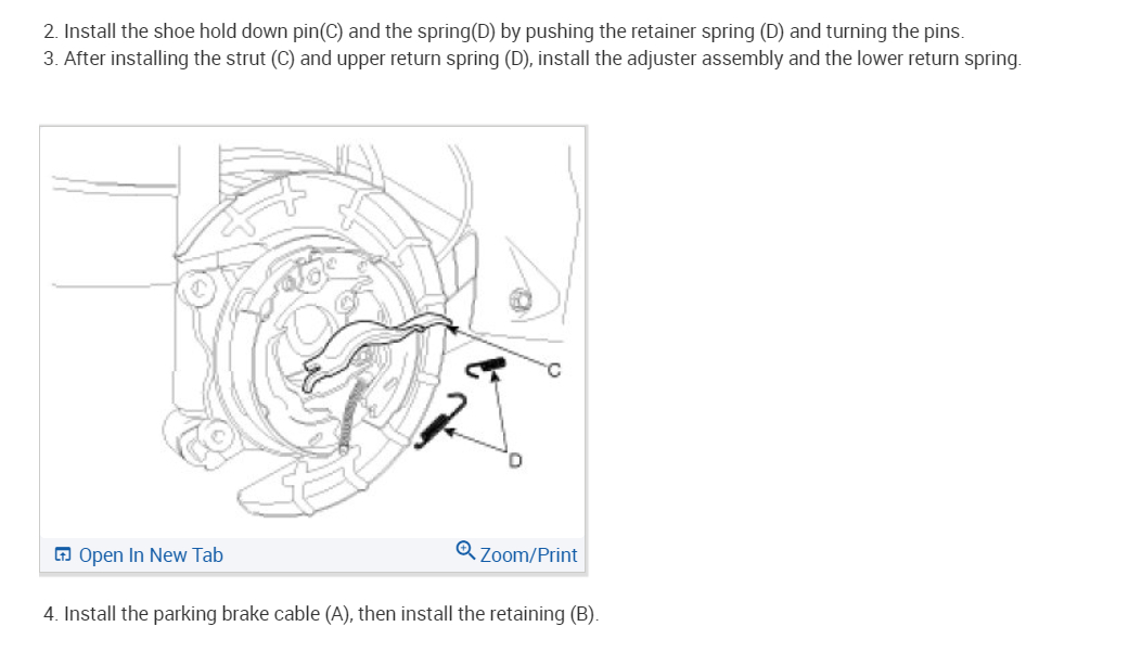

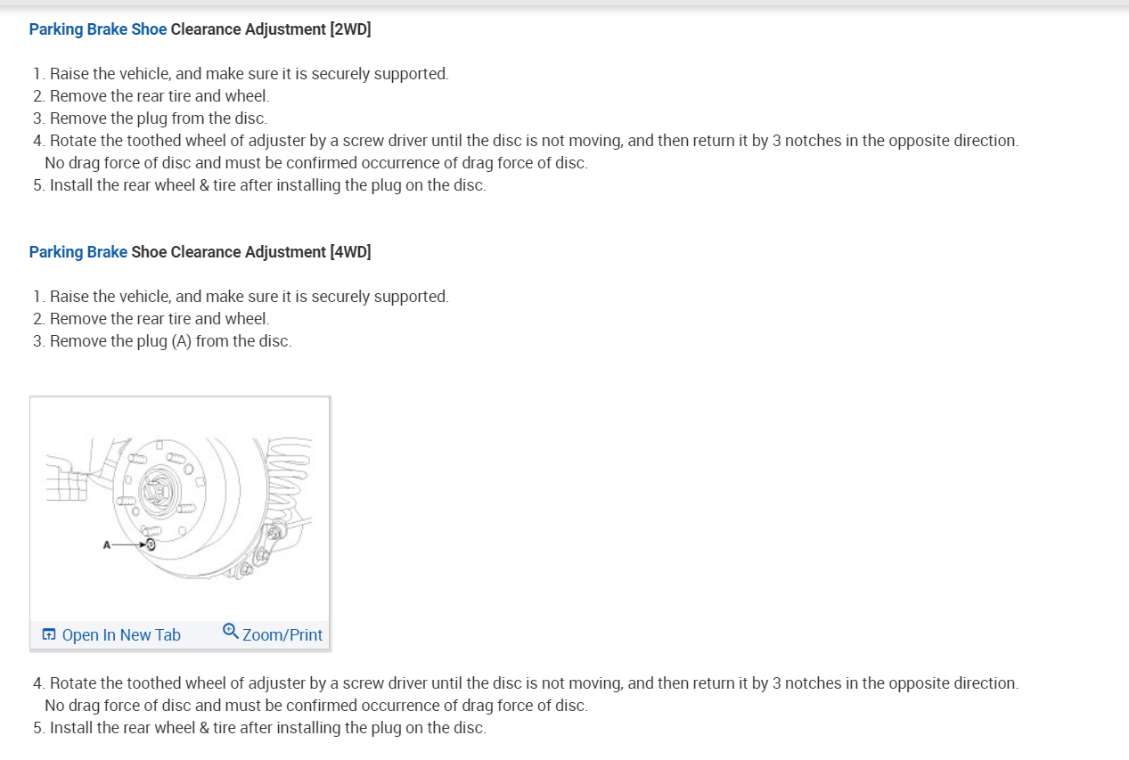

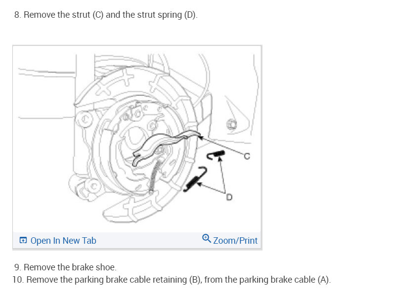

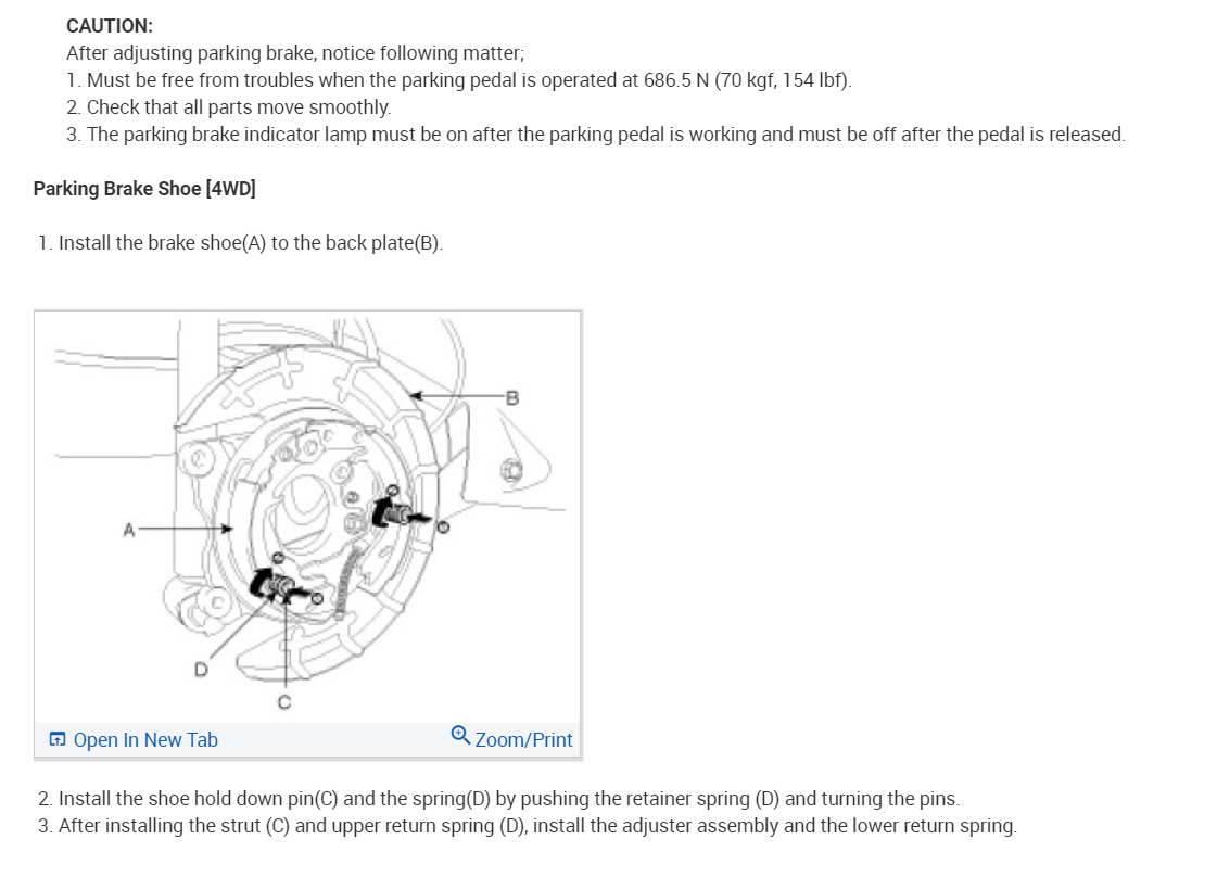

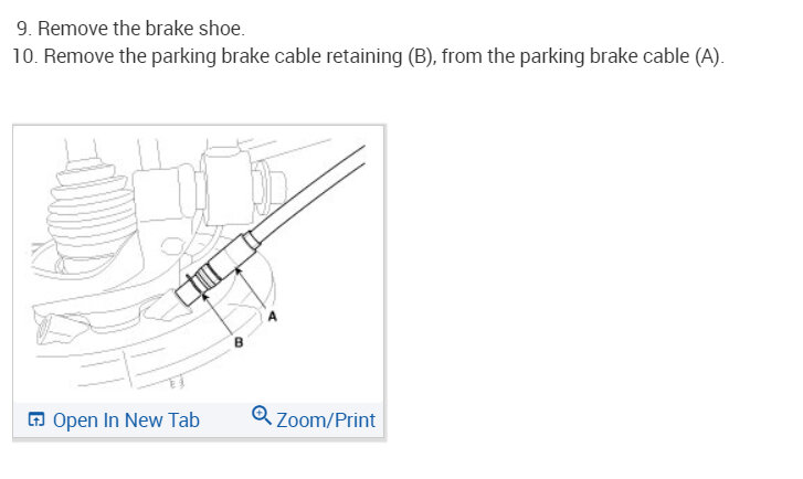

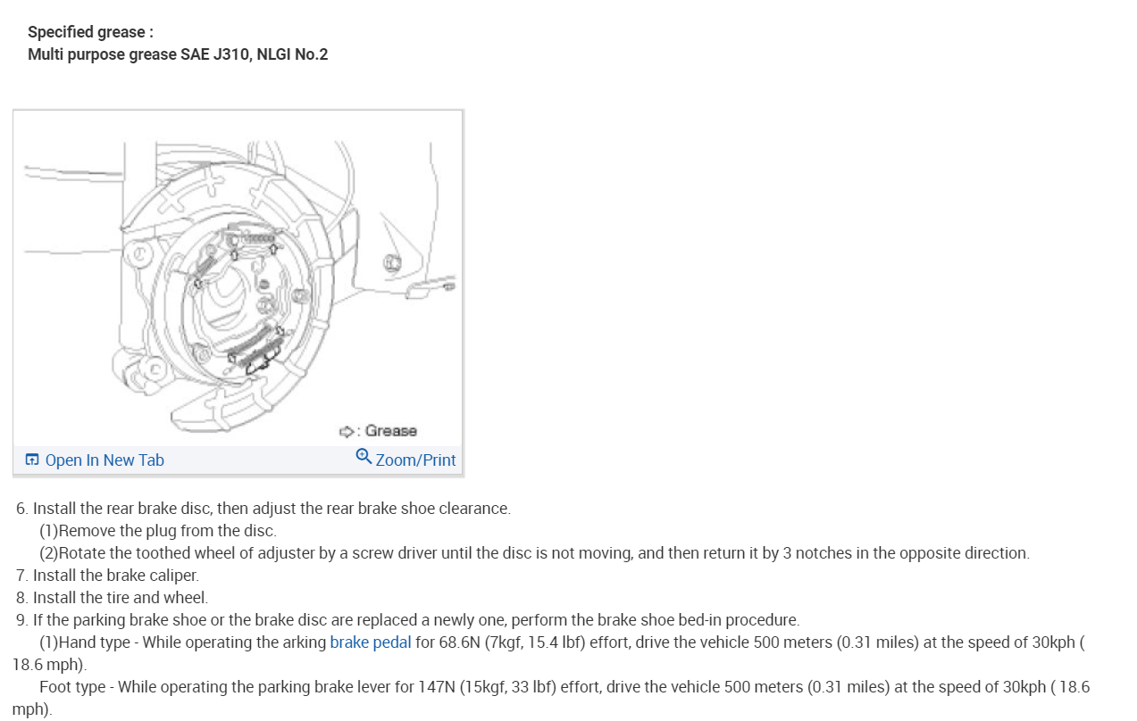

Hello, tomorrow I have to change the handbrake shoes on this car, can you send me a step-by-step guide? Many thanks again.
Jan 11, 2023 at 11:41 PM
  • 55,649 POSTS
Sure, here are the instructions on how to do the job with diagrams of how the shoes are adjusted once you have replaced them. These instructions apply to both sides. Check out the images (below). Please let us know if you need anything else to get the problem fixed.

Very good answerer, as always, thank you very much. I do this work today.
