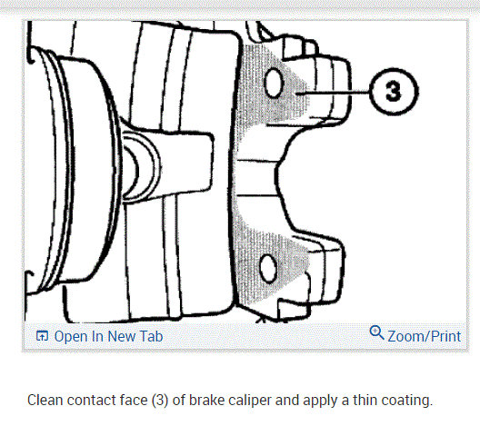

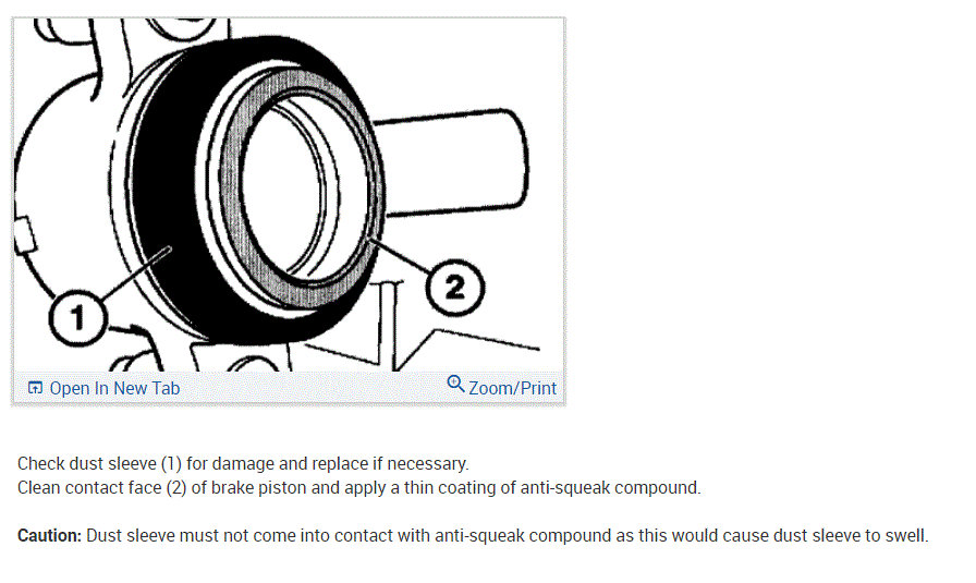

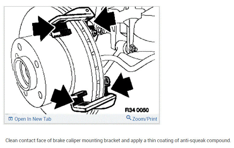

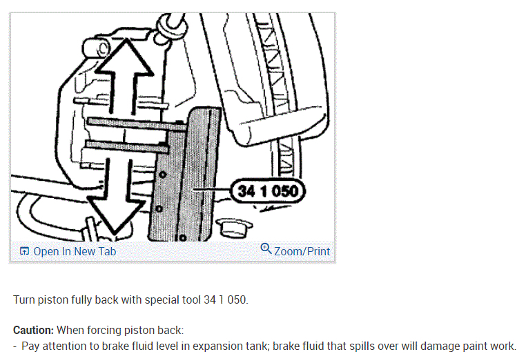

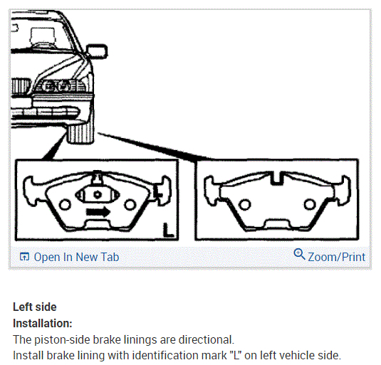

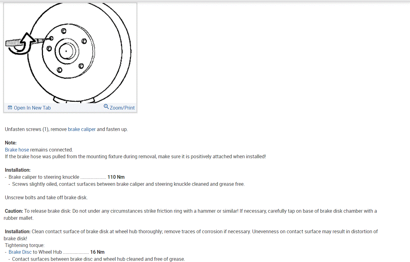

Replacing front brake pads really isn't too hard. When you do it, make sure to get lifetime pads so you never have to pay for them again.
You can expect front pads to last approximately 25,000 miles. However, that can change based on driving habits and terrain.
To get you started, here is a link that shows how it is done in general. You can use this as a guide.

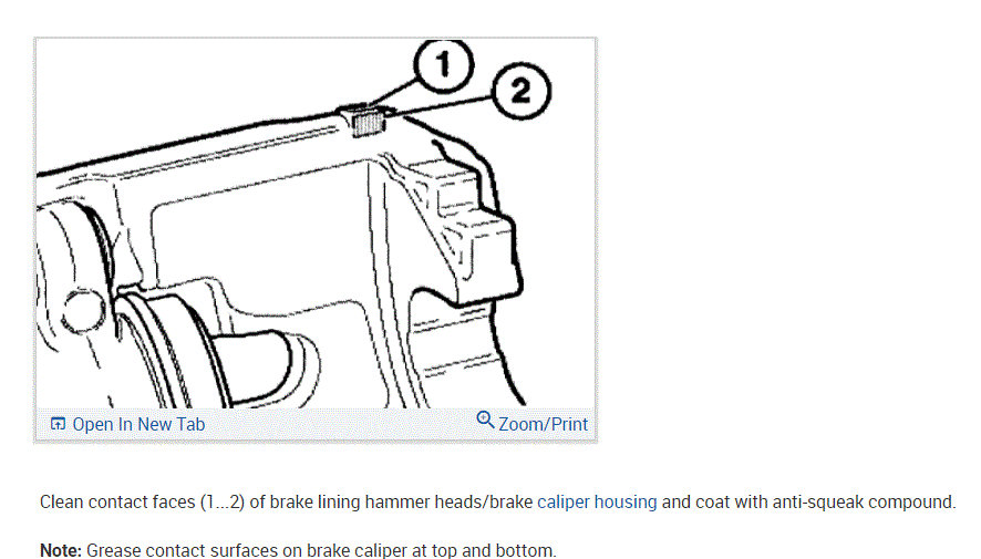

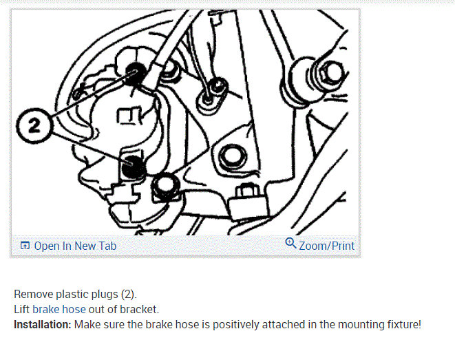

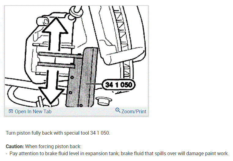

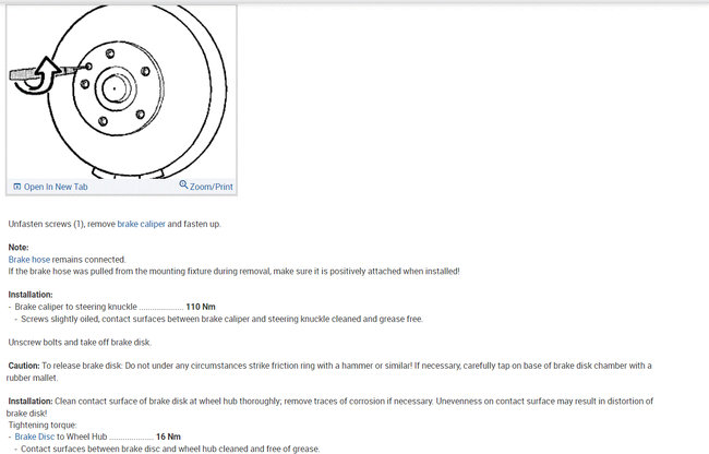

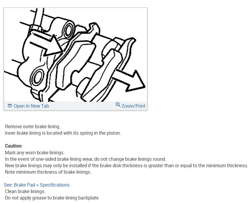

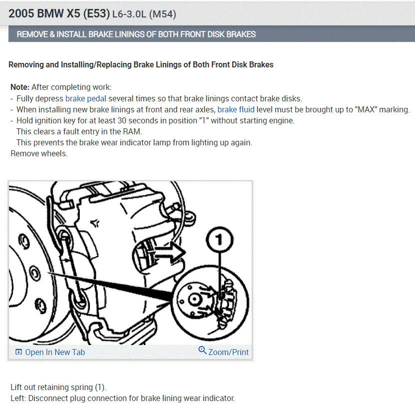

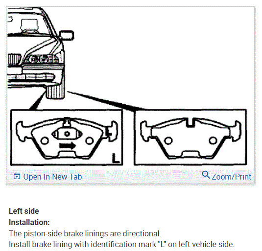

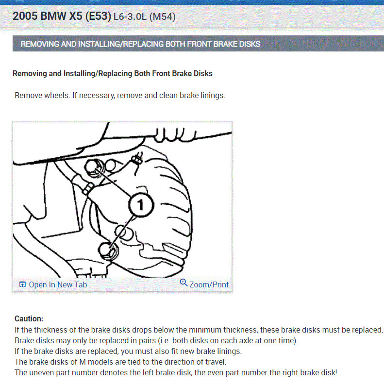

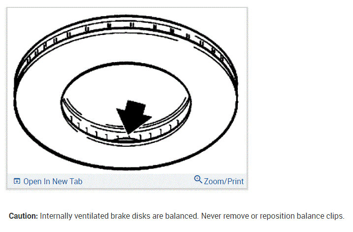

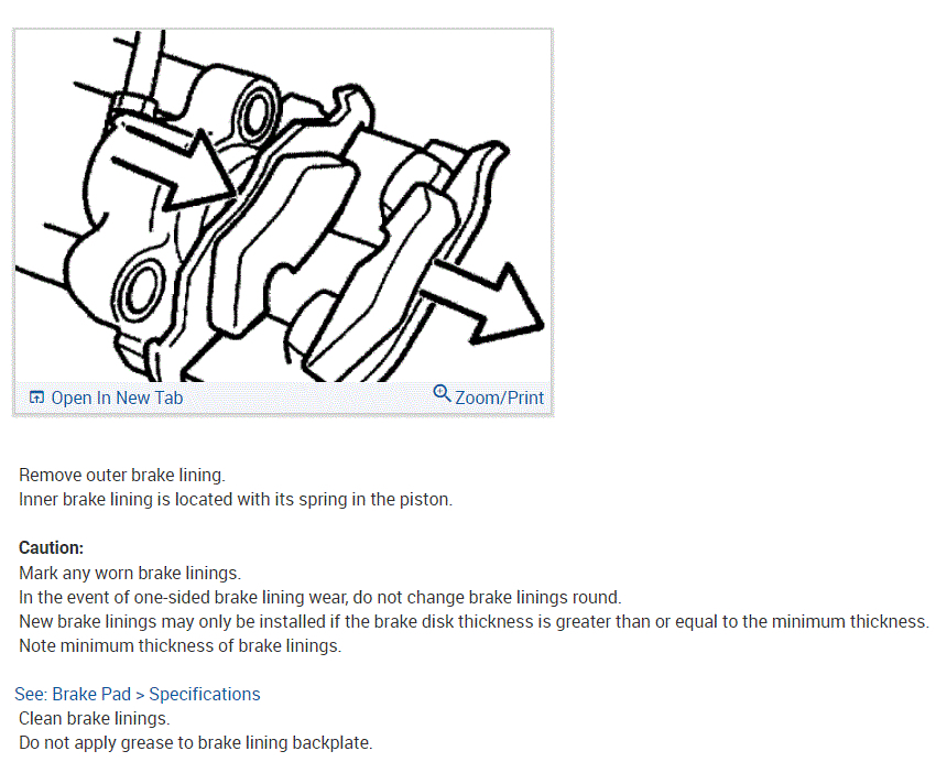

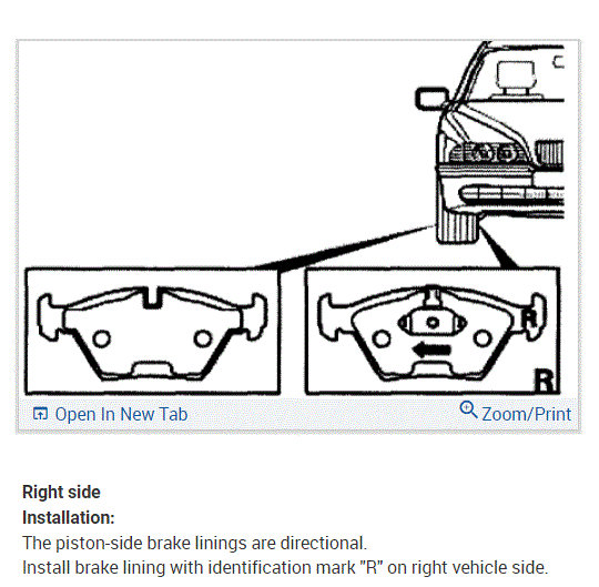

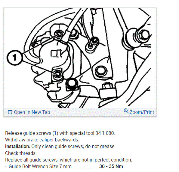

If you look at the attachments, they include the directions and pictures specific to your vehicle for replacement. Use these directions for the procedure.
See pics below
