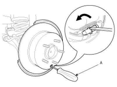

Hello, I bought a car to learn in. It is a manual car with handbrake. While driving when the teacher pulls up the handbrake it just slows down the speed until it stops. Do I have to turn off ABS or something? It is really important for us that it works exactly when the handbrake is pulled so we don't crash into anything.

The hand brake and ABS are two separate components. The hand / parking brake is an adjustable component. On most vehicles, the adjustment is done at the brake lever. However, the actual parking brake shoes may require adjustment as well.
Since this vehicle is very similar to the Hyundai Elantra, which is offered in the US, I will provide the directions for adjustment which should be very similar.

Parking Brake Shoe Clearance Adjustment
Disc Brake Type
1. Raise the vehicle, and make sure it is securely supported.
2. Remove the rear tire and wheel.
3. Remove the plug from the disc.
4. Rotate the toothed wheel of adjuster by a screw driver until the disc is not moving, and then return it by 5 notches in the opposite direction.
pic 1

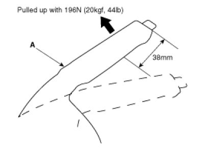

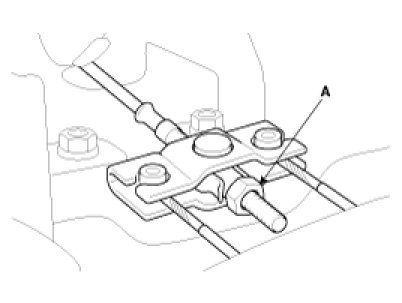

Parking Brake Lever Stroke Adjustment
2. Remove the floor console.
3. Adjust the parking brake lever stroke by turning adjusting nut (A).
Parking brake lever stroke :
7 clicks (Pull the lever with 20kg)
NOTE:
After repairing the parking brake shoe, adjust the brake shoe clearance, and then adjust the parking brake lever stroke.
pic 2
pic 3
4. Release the parking brake lever fully, and check that parking brakes do not drag when the rear wheels are turned. Readjust if necessary.
5. Make sure that the parking brakes are fully applied when the parking brake lever is pulled up fully.
6. Install the floor console.
