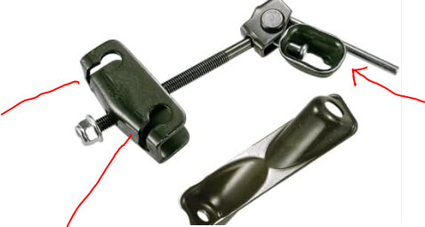

I tried that and still not holding. I noticed that one of the handbrake cables coming from the drums is slightly longer than the other. Could this be the reason?
Aug 21, 2024 at 7:12 AM
  • 110,248 POSTS
Yes, that could cause this to happen. Is it possible for you to take a few pictures of where the cables join together or where the adjuster is? I don't have info for an i800. However, there should be an adjuster.
Most vehicles will have one cable from the park brake lever which will join with two from the rear of the vehicle, one from each wheel. Then, there is normally an adjuster nut used to equalize the pressure to the rear cables. Check to make sure they are attached.
I found a general pic of what I'm referring to. See if it helps.
See pic below
