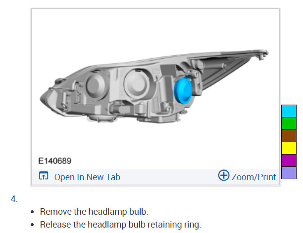

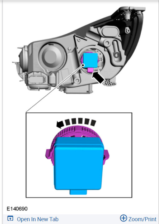

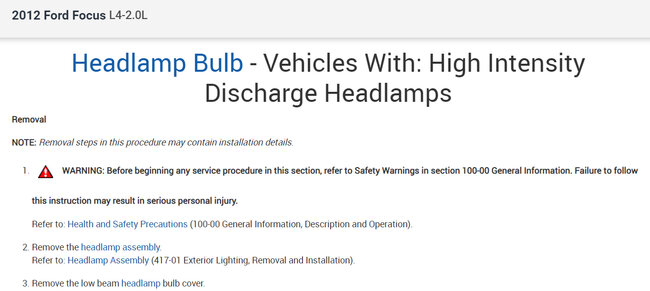

They make bulbs with the resistors built right in the help fool the BCM which I have heard people say they work really well. You can get them on amazon. Make sure you include with your search "with resistor" Here is how to change the bulbs out in case you need it. Check out the images (below). Let us know if you need anything else.

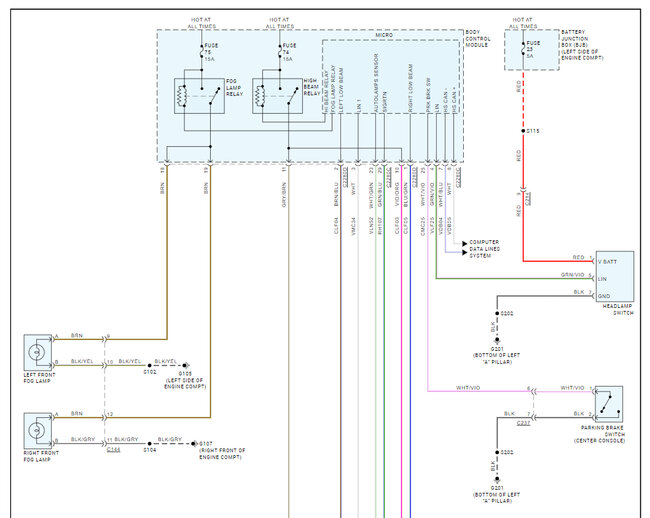

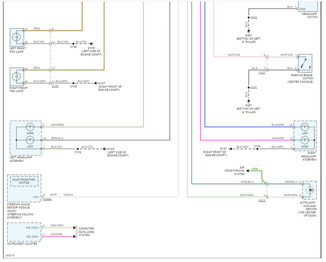

I believe so, the computer can do strange things when new electronics are introduced. The microcontroller inside the BCM can get confused about what to do. Here are the headlight wiring diagrams so you can see how the headlight system works. Check out the images (below). Let us know how it goes.
