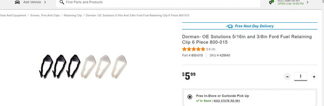

Where can I find them? Ford does not make them and Dorman does not make them. Any suggestions ? I just changed my fuel filter and 2 broke so I purchased a Dorman product # 800-023 and the fuel inlet to filter line blew off twice! Help

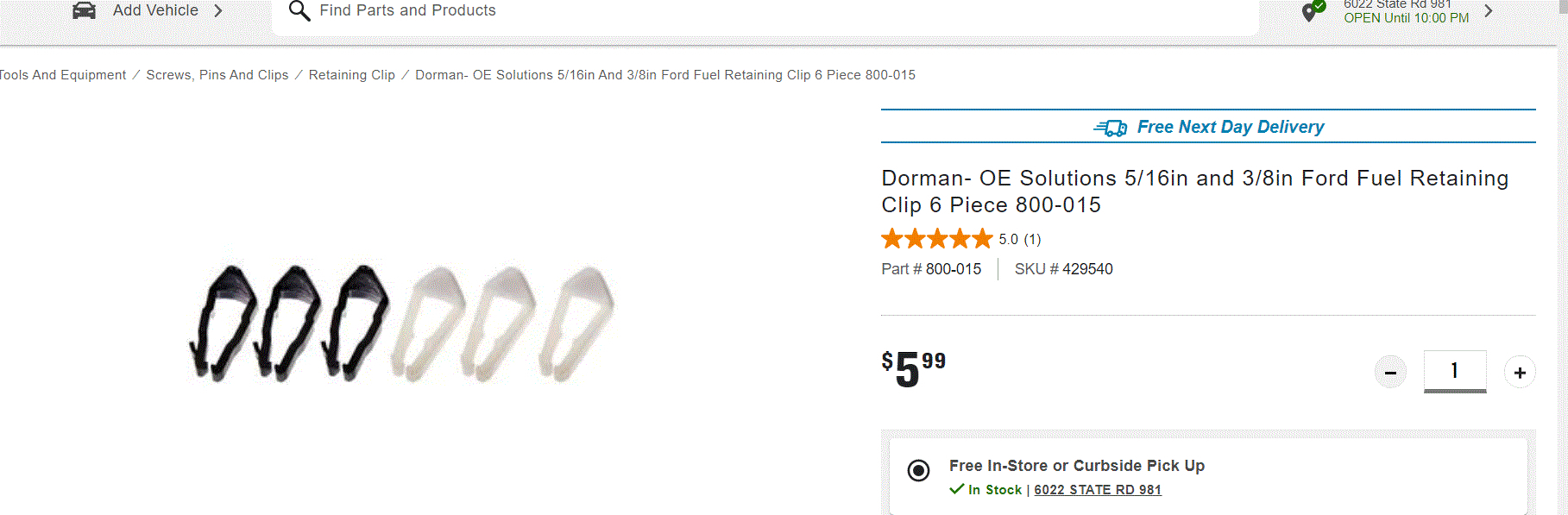

Take a look at the pic below. That is from AutoZone. I believe the ones you got were the wrong design. The clips are referred to as R-clips.
Let me know if this helps. Also, note there are two sets of directions for this vehicle. One is late production and the other early. If this appears wrong, take a pic of what has broken so I can see it.
