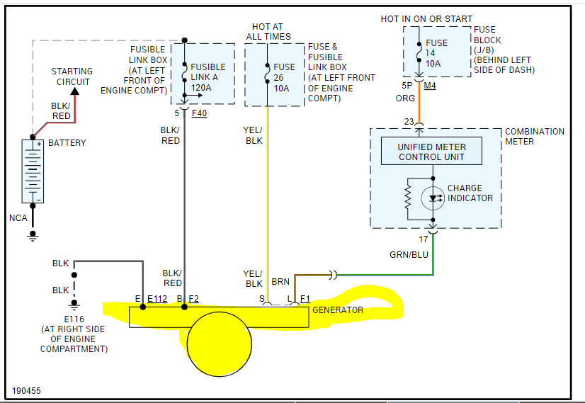

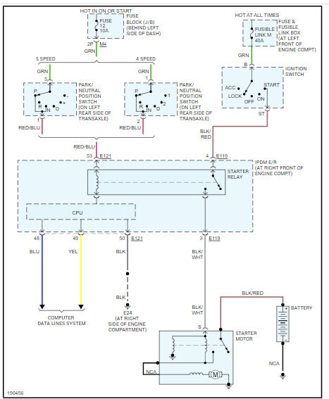

can someone please give me the exact wiring diagram for the alternator starter and battery?
Apr 30, 2024 at 7:17 AM
  • 110,248 POSTS
If you look below, there are two wiring schematic pictures. The first one is for the charging system and the second one is the starter (automatic transmission). Take a look at them and let me know if they help.
Also, let me know what is happening. I should be able to help.
