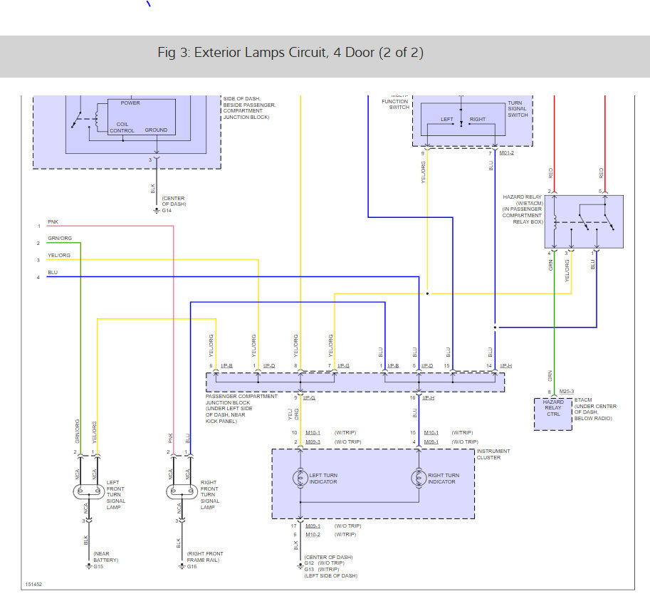

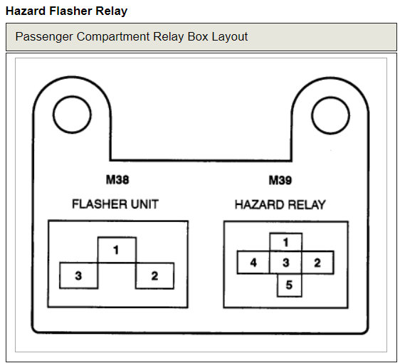

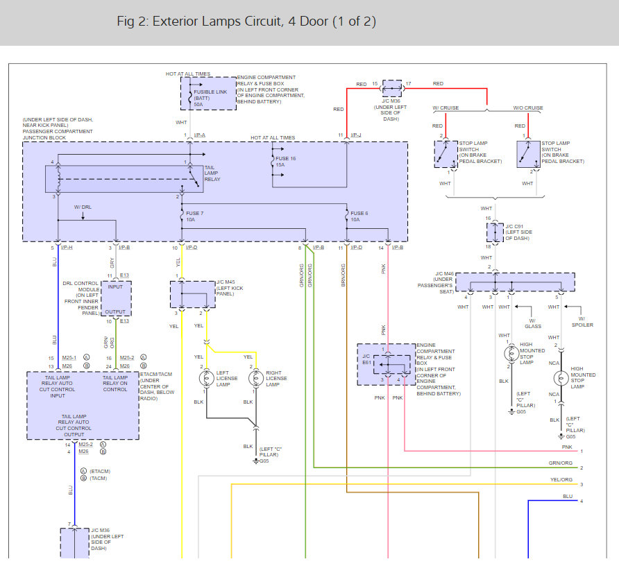

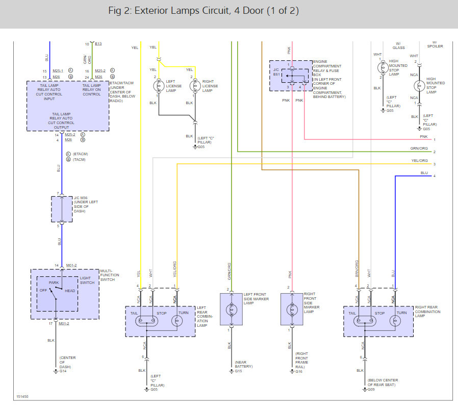

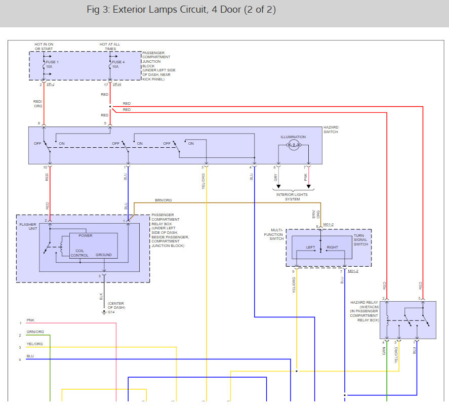

It sounds like the flasher unit is out or you have lost power or ground somewhere. Here are is the wiring diagrams and a guide to help you test the power and grounds:
Please try to move the switch back and forth several time to help clean off the contacts.
Jun 20, 2018 at 4:36 AM
JOTAEME
I Replace the hazard switch for a new one and problem solved.
