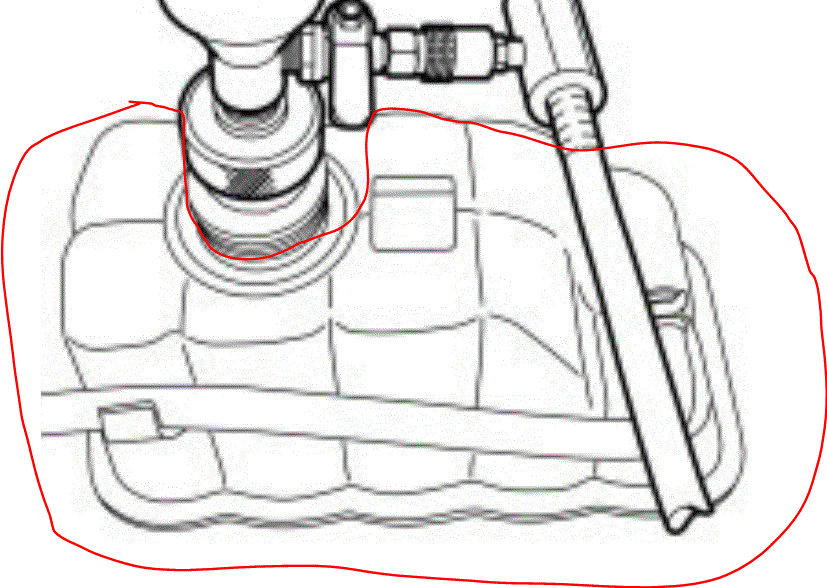

When I start the car and especially when I rev the engine, I can hear a gurgling sound. Unsure what is causing this. The noise stops when I turn the engine off. I can hear it when I'm sitting inside the car. Any idea what's causing this and how to fix it?
May 1, 2022 at 10:11 AM
  • 110,194 POSTS
If the sound seems to come from under the dashboard, there is a chance it is low on engine coolant, and you are hearing the heater core fill with coolant.
What I suggest is to check the coolant level first. If it is full, let me know if this still happens if the AC is not being used.
I will watch for your reply. I attached the only picture I had of the coolant reservoir below. The pic shows the reservoir with a pressure tester attached to the top. Ignore the tester.
Let me know what you find.
See pic below.
