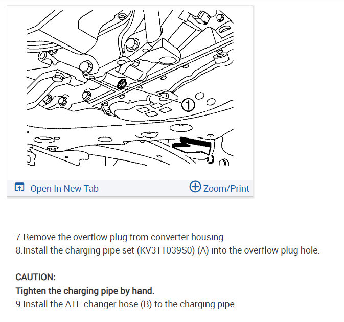

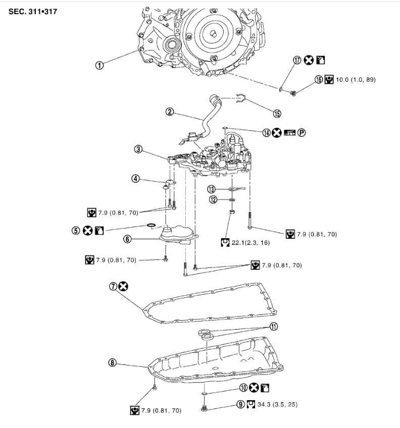

At first start up, when you put car in reverse, I can hear a gurgling noise, or what sounds like, from the passenger's side of the car. Once you shift the transmission into drive, and subsequent times it's placed in reverse, it doesn't make the noise at all.

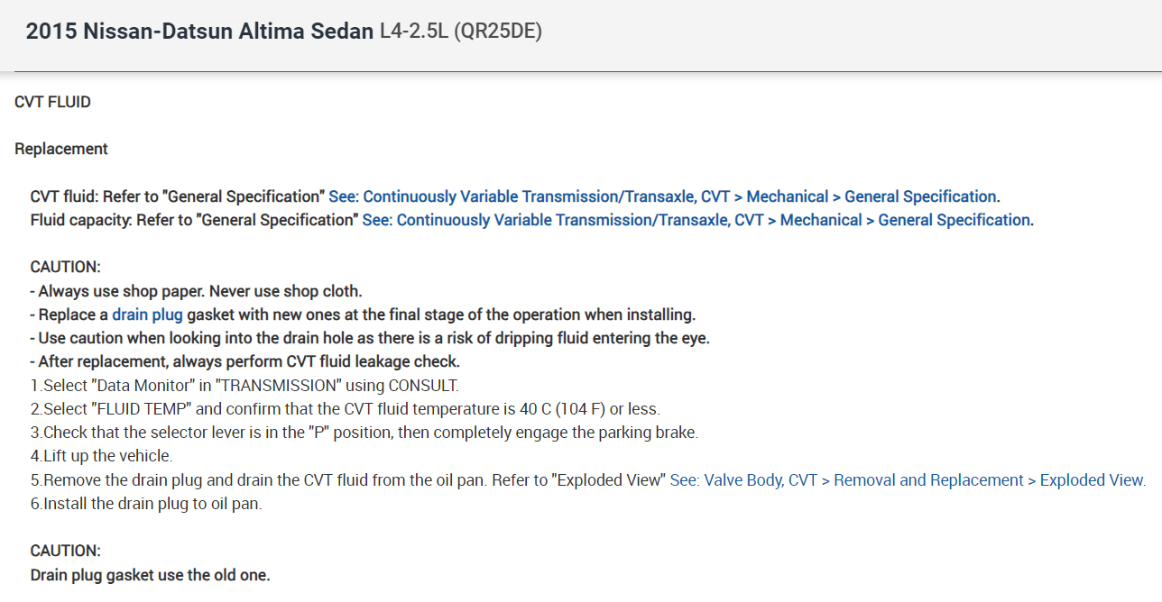

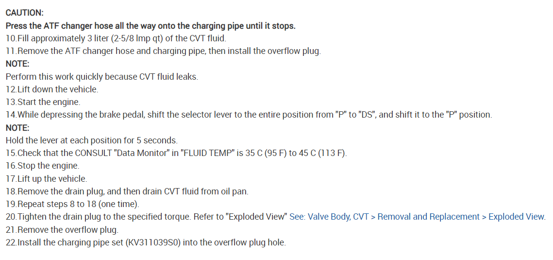

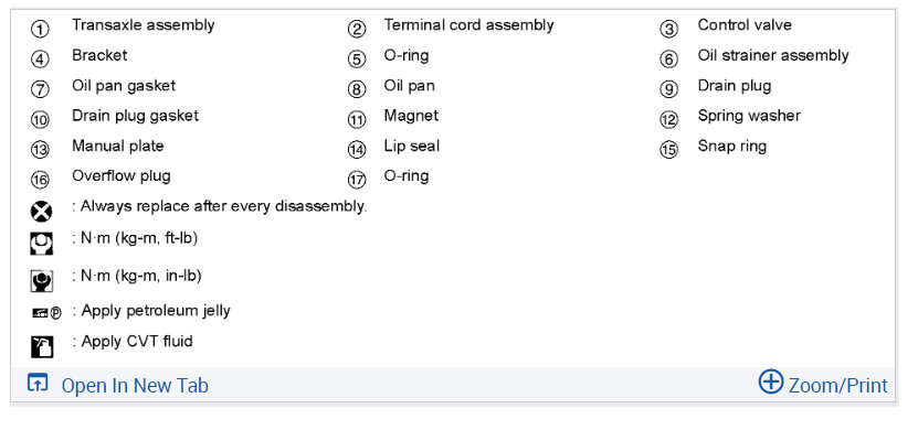

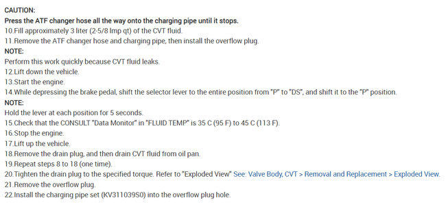

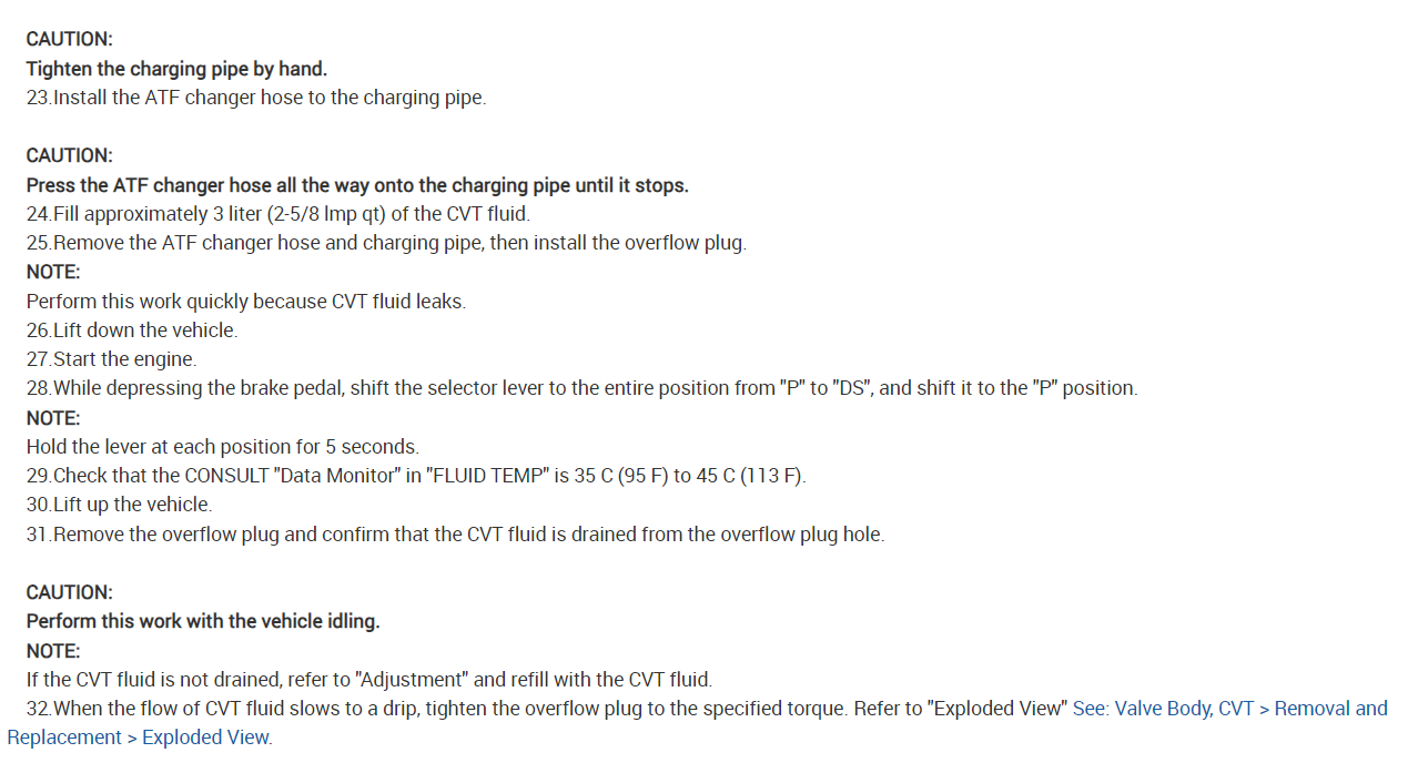

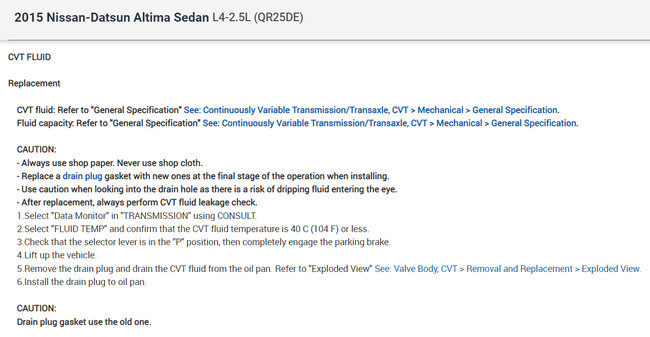

it could be a clogged transmission filter as well. If the noise is coming directly from the transmission, I would swap the filter on and install fresh fluid. Check out the images (below). Please let us know what happens.
