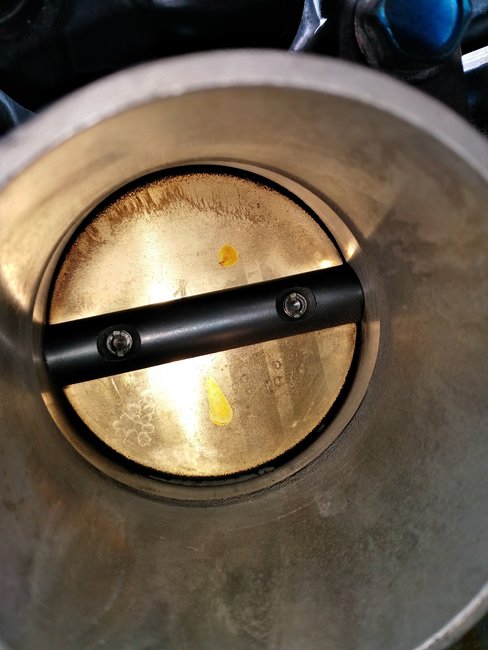

Thanks! Here is a picture of my throttle body. I am guessing it is dirty. Could you please tell me steps to open it and also steps to reset it? Do I need to buy a scanner? Thanks!

The throttle body is not too bad. You need not remove anything. Just get a can of throttle cleaner and spray into it. Let it soak for a while and use a tooth brush to clean it. Do not turn on ignition while doing this and you would need to open the throttle fully to allow the areas where the throttle plate rest when closed to be cleaned. After cleaning, you would have to run the engine for a while to let the Engine Control Module relearns the idling. It could be much higher than normal after cleaning.

Thanks but I still do not understand how to open the throttle plate. Relearning the idle I can do, but how do I open the throttle body when it is electronic? Thanks.

Yes just use your finger and open it with the key off it is spring loaded you can hold it open as long as you want and clean the bore thoroughly.
Here is a guide to help you see what you are in for when doing the job:

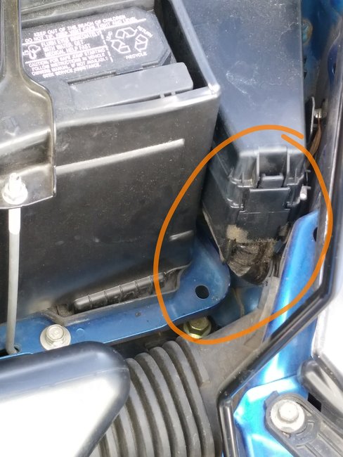

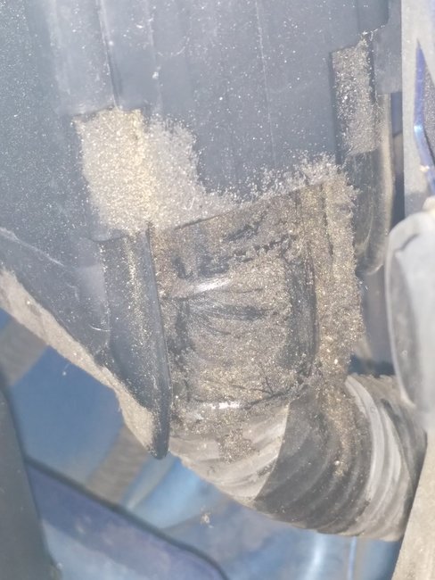

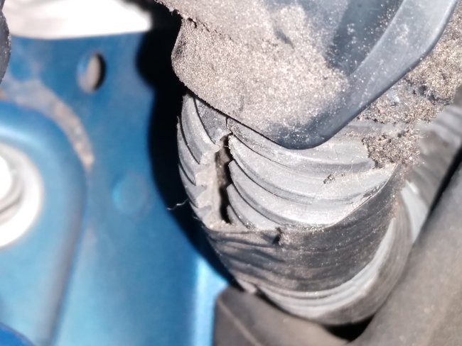

Okay, so the throttle body was cleaned and reset yet the problem remains the same. It seems to only have the idle problem when the A/C is on. It is as if there is a jerk every few seconds when it is on. I found a split hose on something beside my battery. I have no idea what it is attached to nor what it leads to. Picture shows it. Any ideas? It is getting hot and I would like to be able to use the A/C.

That is a wiring harness cover which has a spit down the center which is normal there are wires inside of that conduit. The only time the engine has a problem is when the air conditioner is on? I am thinking you have a problem with the compressor. Does it make noise when it clicks on like it drags the engine way down? Can you make a video?

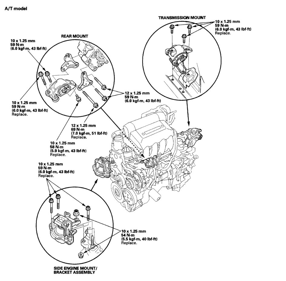

I am guessing I have two separate issues. One being the car randomly shutting off right after a start when in D or R. And 2. The shaking once the A/C is on but only when in D or R, not P. So confusing. Video shows engine action while switched between D and R. Thanks for any and all advice.

Thanks for the video. The engine is moving way too much like you have a engine mount or torque mount out. See the diagram below its the lower rear mount I would look at.
https://www.2carpros.com/articles/replace-motor-mounts
I noticed the engine did not stall and seems to be running okay, I am right to assume this?
If you stress the engine when driving it will move more which can make it stall.
