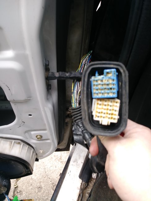

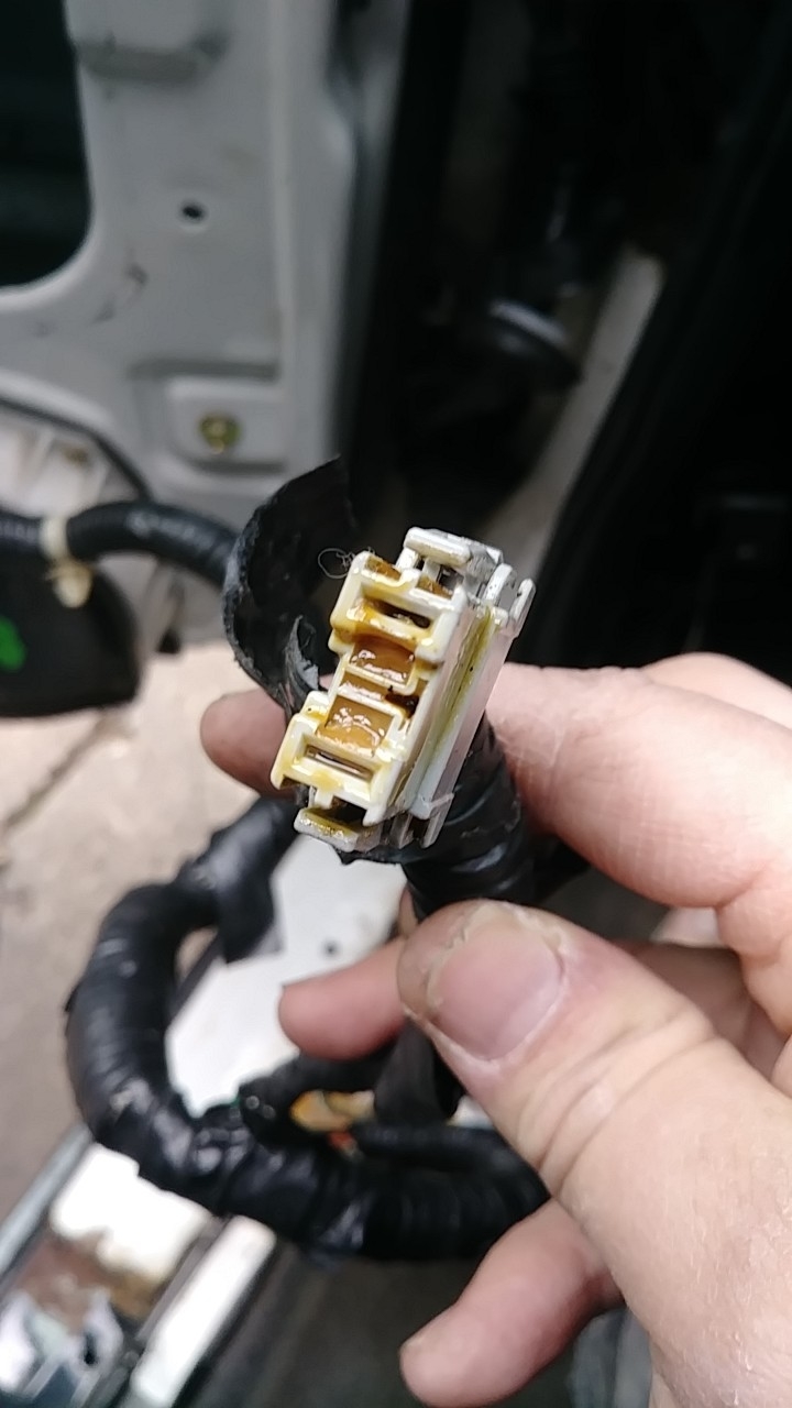

We are having problems with our driver door. Windows wont work and door locks aren't working either. The wire harness that connects to the wire harness that goes into the fuse box has a massive amount of i am assuming grease. Would that mess it up and make it not connect right? The one picture is the connector is for the speaker and the double one is the one that goes through the door to inside the van to the fuse box.

Got it fixed. just replaced the whole harness.
