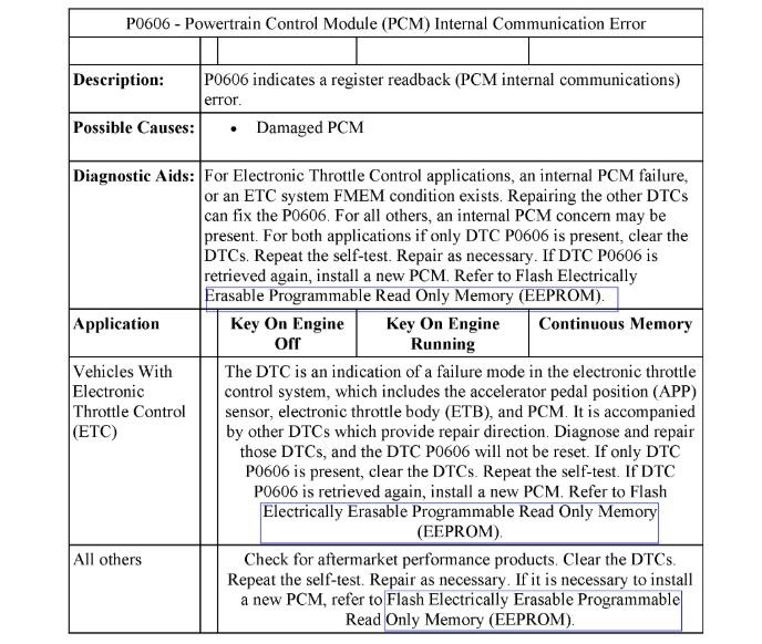

Codes P0606, P0733, and P0745
2005 FORD EXPLORER
60,000 MILES
JBGOLDLAMP
I have the SUV listed above VIN number 1FMZU73K05ZA77144 and I had a diagnostics test done.There were three things all transmission related. P0606-Processor Fault Code. P0733- In Correct Gear Ratio #3. P0745- Pressure Control Solenoid. In which order would you recommend in repairing and would replacing one eliminate the others?
May 5, 2018 at 4:03 AM
Good afternoon.
The 606 is the start. That a bad PCM. it must be replaced.
That may be the whole issue.
You need a new not used PCM, flashing to your truck and then test again and see.
