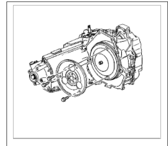

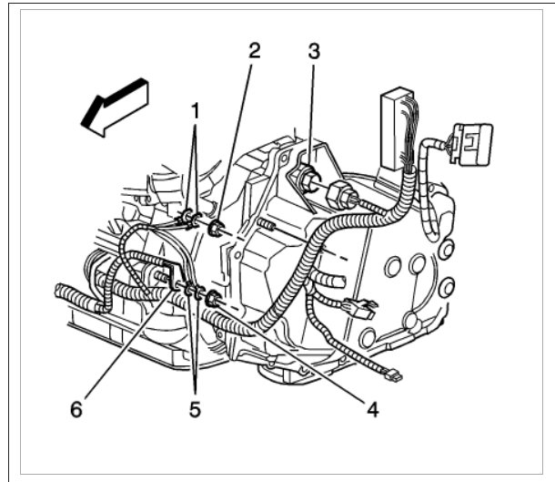

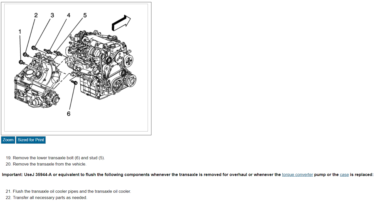

I am looking for a step by step instructions for the transmission removal and replacement.
Apr 26, 2018 at 6:54 AM
  • 55,224 POSTS
You will need to have the battery disconnected to start and put the can up on jack stands.
Here is a guide to help see what you are in for when doing the job:
https://www.2carpros.com/articles/transmission-replacement-removal-manual
This video will help you as well.
https://youtu.be/3vJAojsrfuU
Is rear wheel drive but you get the idea.

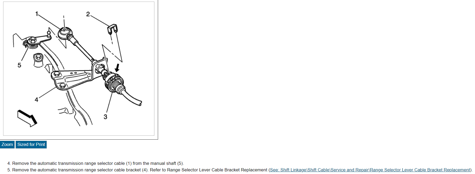

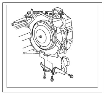

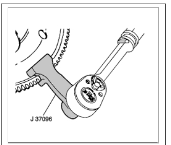

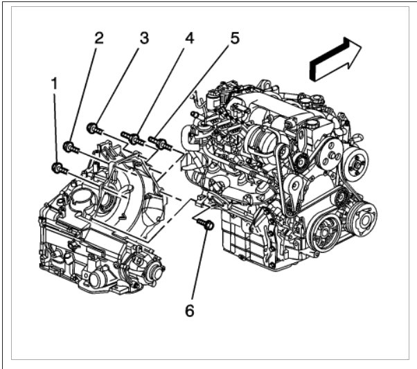

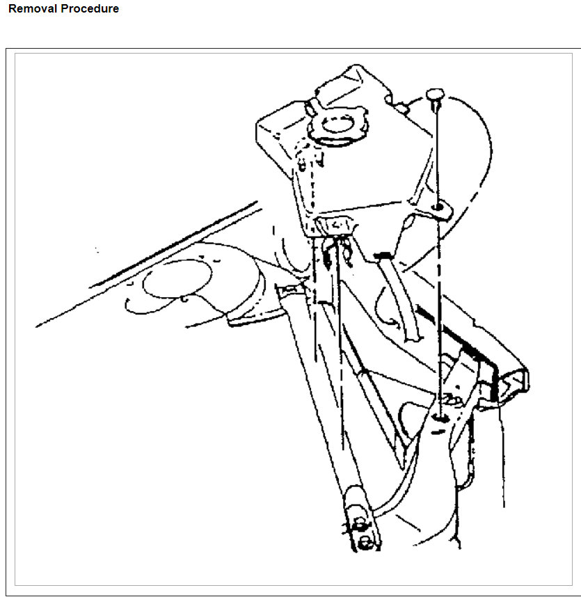

Here are diagrams of how to do the job on your car.
