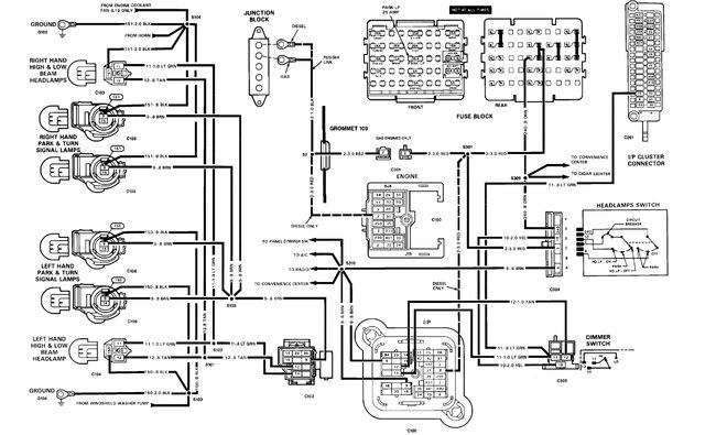

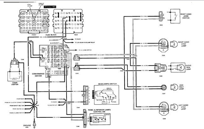

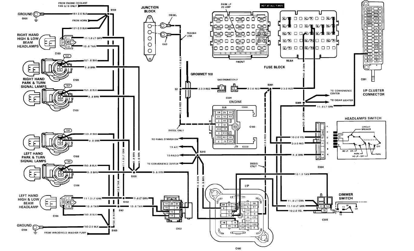

On my truck the gauge lights do not work. I have looked at the fuse and it is not that. I have put a new radio in and I had to rewire the radio so. The radio works but not the gauge lights.
Nov 8, 2018 at 10:41 PM
  • 55,224 POSTS
It sounds like the headlight switch is not working but to be sure here is a guide and the dash light wiring diagrams so you can see how it works and run some tests. Check for power.
