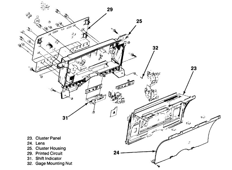

Instrument panel doesn't work.
Apr 3, 2019 at 4:42 AM
Good afternoon,
If you remove the connector from the cluster, does the fuse still fail?
If it does, it has a short in the harness.
If it does not then the cluster is the issue and it will have to be sent out for repair.
REMOVE OR DISCONNECT
1. Instrument cluster, refer to Instrument Panel / Service and Repair.
2. Lens retaining screws and lens.
3. Cluster panel from the cluster housing.
4. Speedometer mounting screws and speedometer.
Apr 3, 2019 at 4:55 AM
KATHERINE SCHMIDT
How do I remove connector from cluster?
Apr 3, 2019 at 6:17 AM
Once you remove the cluster as I gave you the procedure, you remove the connector at the back of the unit.
