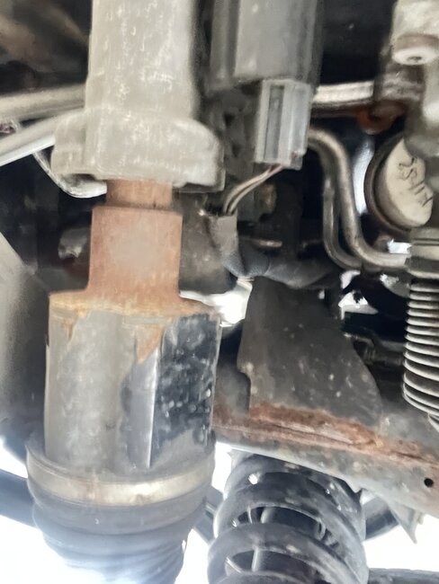

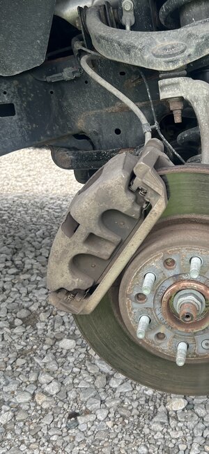

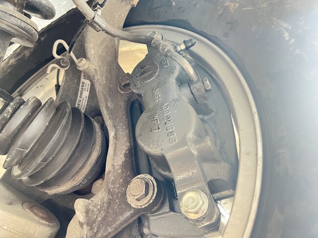

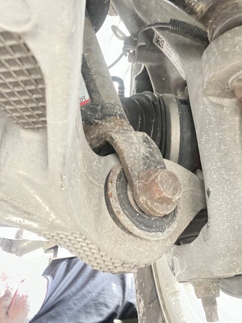

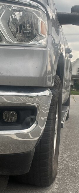

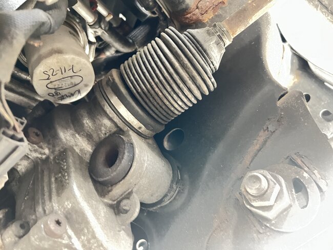

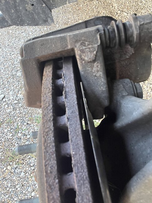

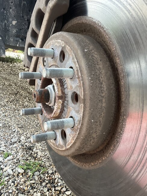

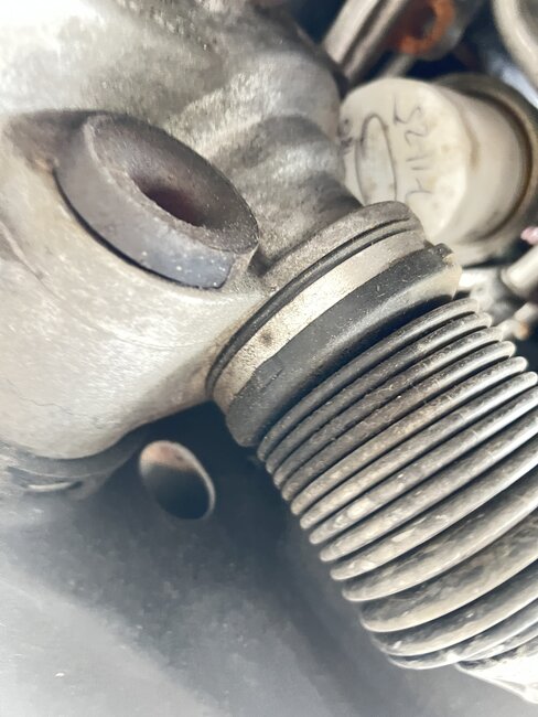

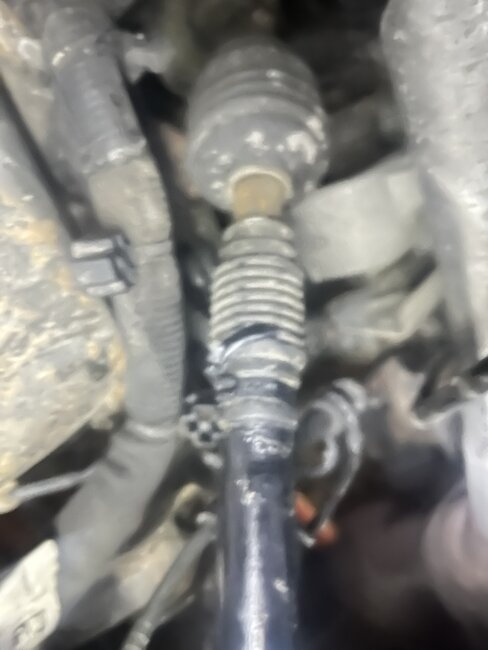

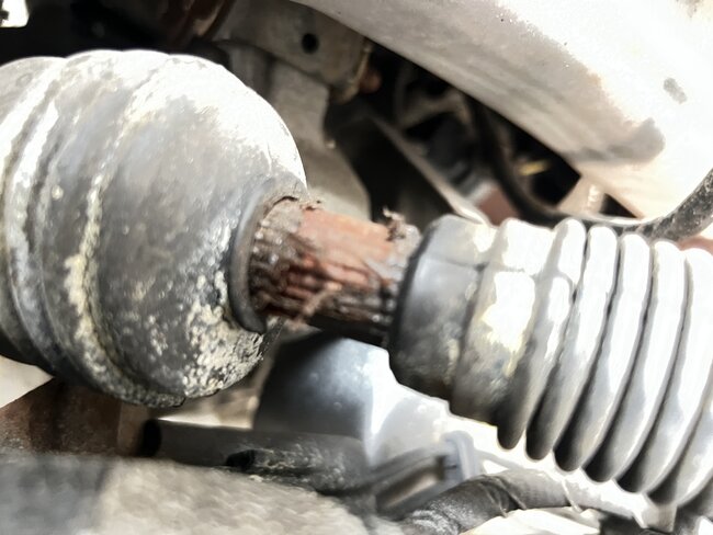

I bought this truck three months ago and nothing but problems. After a few weeks I had grinding/grabbing/binding problems in yhe front, more so on the passenger side. I replaced the calipers and brake pads on both sides. Then I took the pads out on the passenger side and filed a bit of the ears for an easier fit. After all of that, after driving 6-8 miles the grinding gets worst along with steering performance…it gets lose. But after parking it overnight when I get back in it the next day it feels semi normal fir about 2 mikes then I start all over again. Can’t be certain but it looks like the intermediate steering column spindles look damage and maybe a result of the grabbing. It does not feel safe to drive. I took it to one shop to check illignment, any frame damage, and gave them all the same info yhat Im giving you. They said bleed the brakes. I did. Brakes work a little better. My truck still isnt driving right. Ive owned three other Rams and I know how they drove. Some of the pics, theres no editing function before sending. Please disregard.

I would not drive the truck until the cause is found, especially since the steering starts feeling loose. I would check the caliper slides first. Here is a guide to help us.
https://2carpros.com/articles/discover-why-automotive-brake-pads-wear-unevenly/
I would be best if we can get a short video of the noise. With the front wheels safely off the ground, grab the tire at 12 and 6 o'clock and check for movement, then at 3 and 9 o'clock. Any noticeable play needs to be traced to the exact component while someone watches the hub, ball joints and steering linkage. Let us know please
