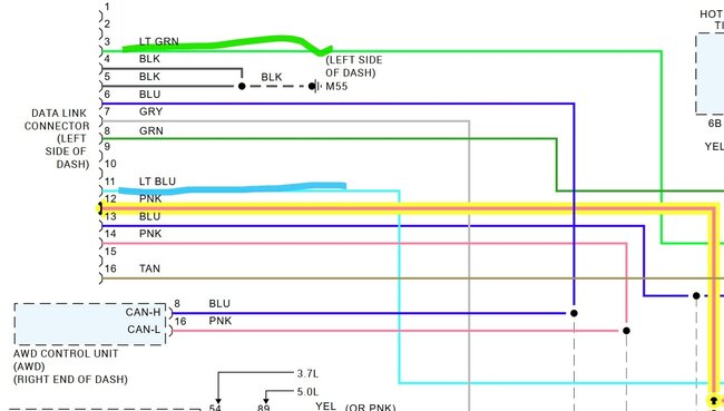

Hello there hope all is well!
-I know this is old but I came across this thread from you and a fellow QX70 owner discussing CAN bus signals:
https://www.2carpros.com/questions/pin-digram-for-speedometer-cluster
-I've been questioning all day what this person did here:
https://www.reddit.com/r/CarHacking/comments/1goavn8/nissaninfiniti_can_bus_reverse_engineering_to/
-He was able to modify the firmware on the nav unit to get the GTR MFD, and then get any available CAN bus data to transfer into the MFD tab on the now "modified" unit. There's more videos on his YT channel of him testing it if you can check it out.
-Here's where everything started:
(Guy from the first reddit link above perfected the MFD menu and translation into the united that this person "unlocked")
https://www.myg37.com/forums/audio-video-and-electronics/301371-modding-the-oem-navigation-head-unit-gaining-gt-r-mfd-and-other-functions.html
They have confirmed that it should work on every unit from 2010 - 15 I believe, but he is perfecting it on his G37 first.
Now, my question is, where is he pulling/tapping into to get CAN bus data from to translate it into the MFD to be viewed on the unit like he shows on this videos?
He doesn't really go in depth except for what he uses to data log for testing purposes on a dummy unit, plenty of instructions online on how to do that.
Sorry if this is too much to read, I just got really intrigued from all the diagrams, and detailed info you were giving on that old thread. Pretty similar but different situation here.
I'd appreciate any info you can provide and what are your thoughts on this project. For reference I have a fx50 2013.
Thank you!!
Feb 20, 2026 at 12:18 PM
STEVE W.
  • 15,295 POSTS
The CAN bus connects to the AV unit directly so that is likely where he is getting that data. Then it looks like he used blue tooth to intercept the physical sensor data from the engines sensors directly at the engine harness before they are input into the data stream to the ECM, that way you just write code that says what signal voltages represent. IE- 5 volts = 100 psi or 3.4 volts = 180 degrees, to get those values you could use a scan tool that gives you the temperature as well as the signal voltage and write a table similar to the OE tables in the ECM. Then you would write some code into the nav unit showing how to display the data as gauges. It looks like they are pretty much just using the nav unit as a display, similar to using it to control an ipod or phone using blue tooth.

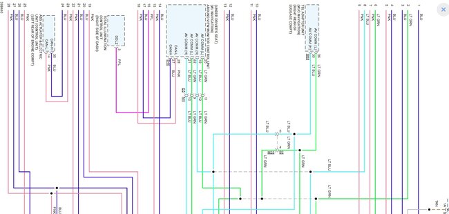

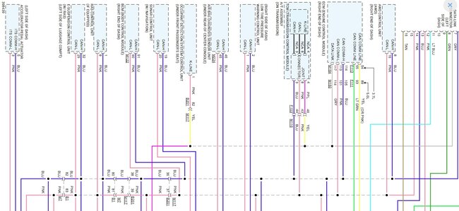

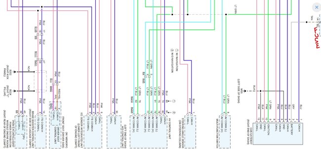

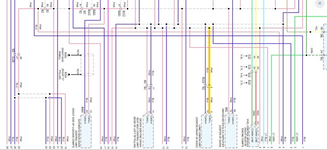

STEVE W.
  • 15,295 POSTS
They both use the same data lines and signal types. However some of the data may be different in terms of how each vehicles code is written. That is one of the reasons scan tools are $$$$ they have to be able to translate all the different protocols and data streams.
These are the various network lines in an FX50 that you listed, the DLC has most of them available. Pins 3 and 11 are the AV network, that covers nav as well. The other lines are there as well but if you look at the diagram, on the far right side you will see the CAN gateway, it is the network security guard, it's job is to prevent anything from accessing the network unless it's a recognized item, like an approved scan tool. However if you get your data before it gets to the gateway, it's fair game. The AV data doesn't go through the gateway however the AV surround view unit (for the birds eye and camera views) does connect to the primary CAN bus, that is the data line he is using to get the signals from. It is also why the "network gateway" doesn't really pose any real threat to thieves, if you could send the correct signals through the open AV unit network you could compromise the vehicles systems. That is why I'm against having all the wireless networking items on modern cars. It's like having a bank vault with the combination and release codes painted on the outside of the door, and the vault is in the lobby!
