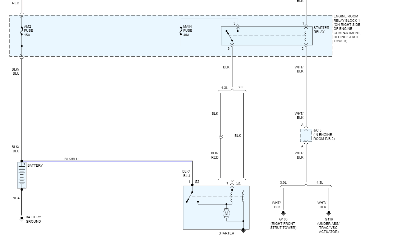

 Guys, tried to look around for the issue but did not found any thing related . The problem is that the car was not cranking at all (no sounds from the starter) in the morning after turning the key multiple times the car started and this kept happening for a few days. Finally i took it to the garage where they advised it could be a faulty starter and may be the starter solenoid was not working occasionally. They recommended for replacing the starter which was changed. Following morning again the car wont start. I tried to check the current in the relay and it seems that the relay is not receiving signal when the key is turned to crank the motor.. i then tried to direct the wires in the relay box and the car started immediately... has any body had this issue.
this only happens when the car is not warmed.. once warmed it starts in first go. Also checked the 5A starter fuse which is also fine.

If it started with a jumper wire, have you checked the relay itself. Here is a link explaining hot to test a relay:

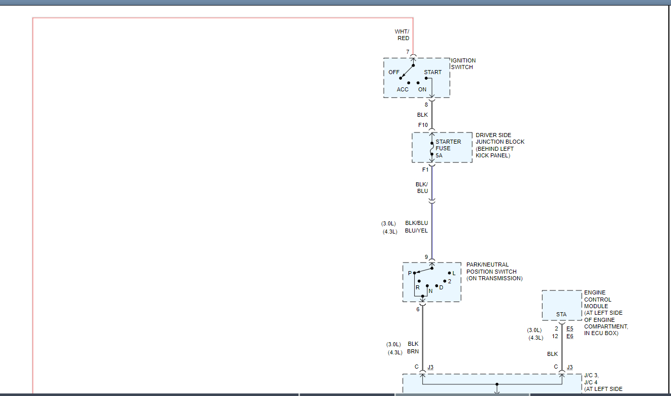

I attached two pics below. They provide the entire wiring schematic for the starting system. Have you tried starting it in neutral when this happens? It could be related to the neutral safety switch. It's odd that it only happens cold. It sounds like a relay issue.

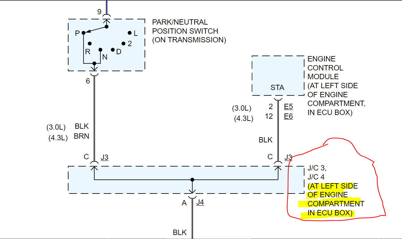

Hi Joe, relay can be ruled out as pin 1 is not receiving any signal when the car is cranked while pin 2 is constant and i yes i did try to start in neutral as well but it starts occasionally.. I do have doubts on NSS switch and want to be sure.. can you help me locate the J3 connector where the NSS ans STA signals meet. Have been trying to locate this connector but no success..

No problem. See the attached picture. If you aren't getting power to pin one, I understand why you wanted this. LOL I have a feeling it is the NSS.

Hi Joe, it was the Neutral Safety Switch. Got it diagnosed from a mechanic. Replaced it, let see if it fixes the issue. Appreciate your support.
