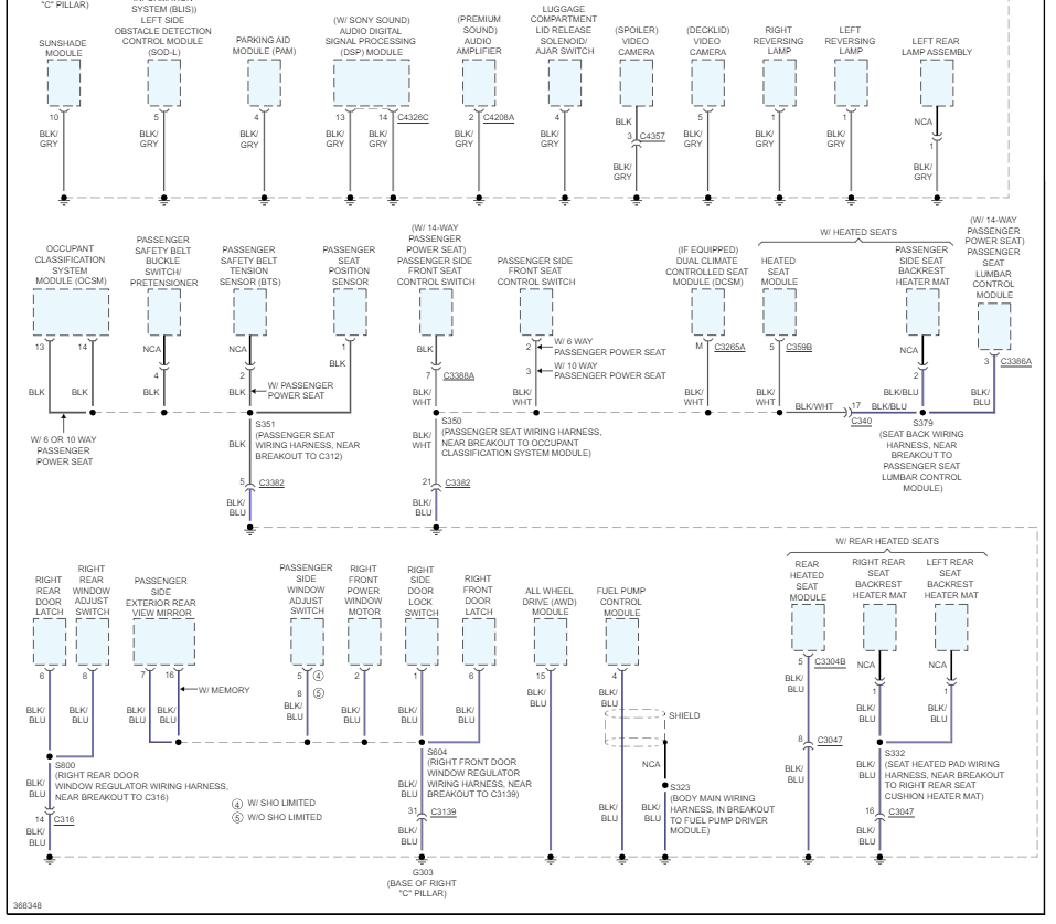

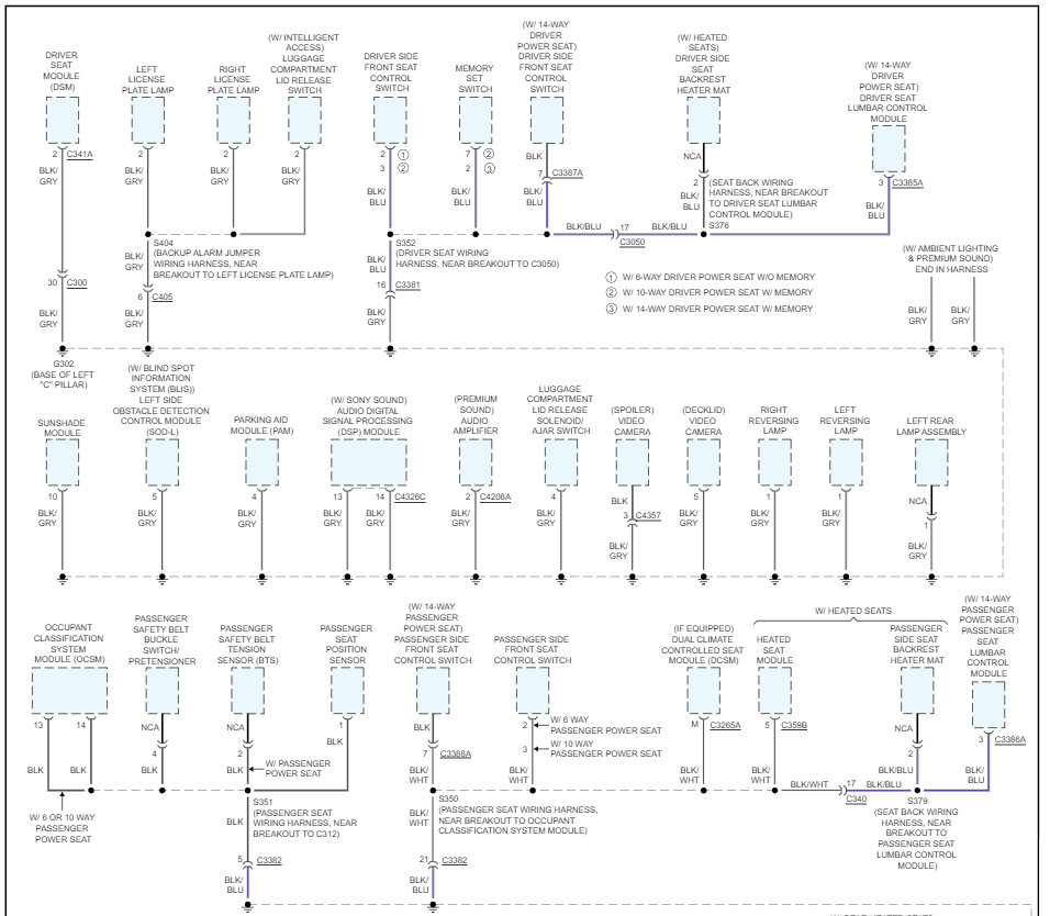

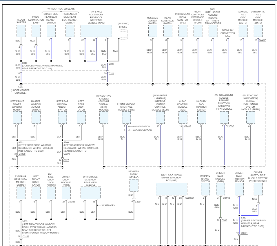

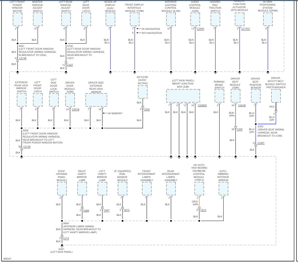

Where are interior grounds located, specifically? ignition is trying to go off/on by itself, radio won't go off, heat is stuck blowing on high?
Sep 10, 2023 at 7:52 AM
  • 55,423 POSTS

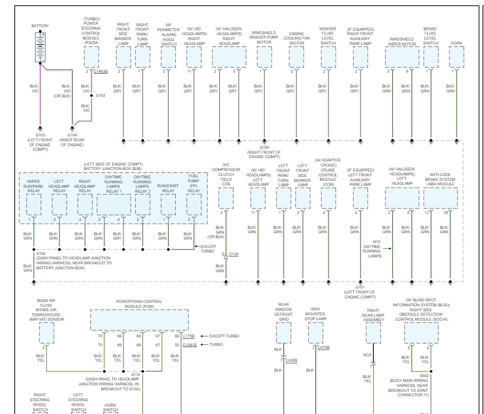

For what system do you need the ground location for? Here are the locations of the grounds for the entire car. I can narrow it down for you if you give me the system in question. Check out the images (below). Please let us know if you need anything else to get the problem fixed.
Sep 11, 2023 at 6:47 AM
RIBERT2431
Looking for grounds on climate control, radio, and sync system.

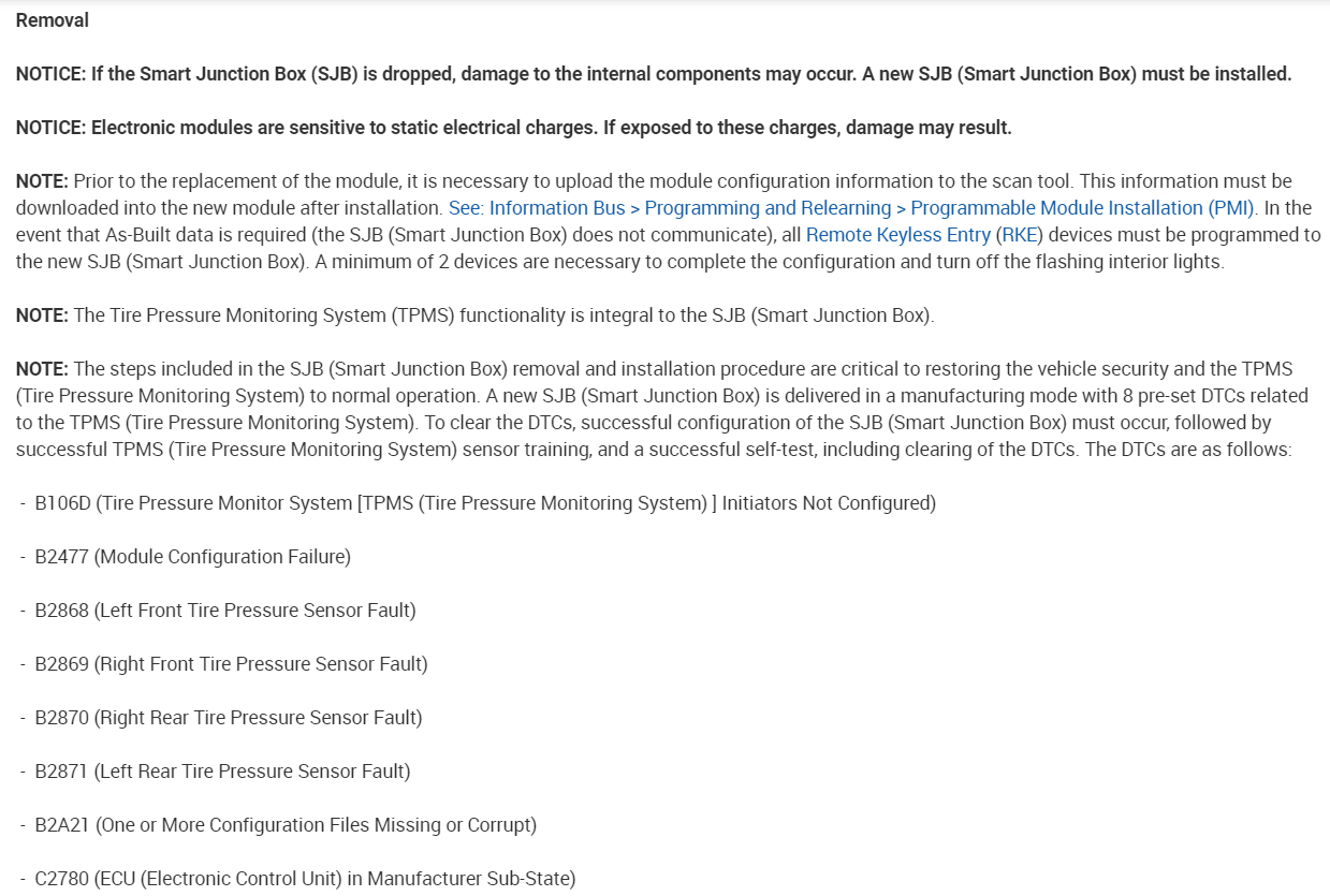

The ignition is trying to go off/on by itself, radio won't go off, heat is stuck blowing on high. When I was trying to remove the center console these things were starting and stopping. I’ve tried resetting the main computer multiple times, but it didn’t help and I’m not blowing fuses. Any advice you can give is appreciated.
Thanks for your help.

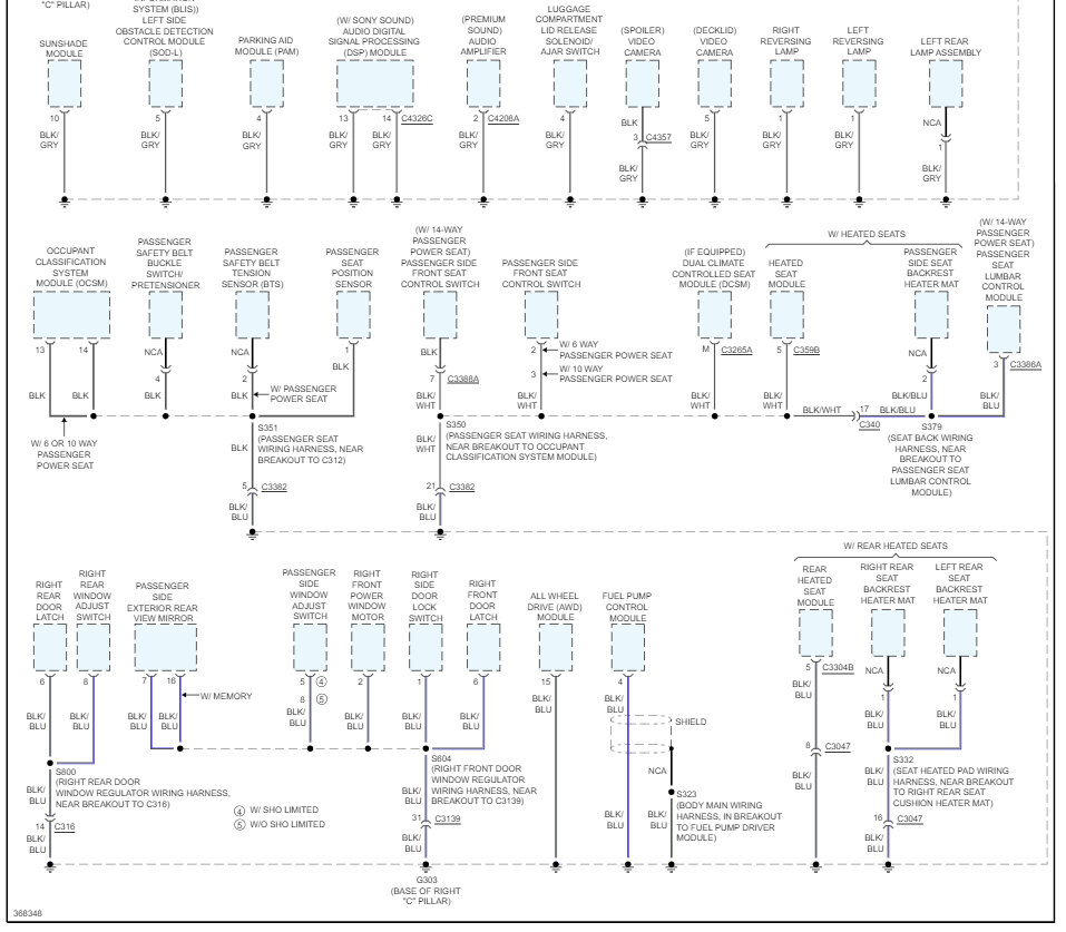

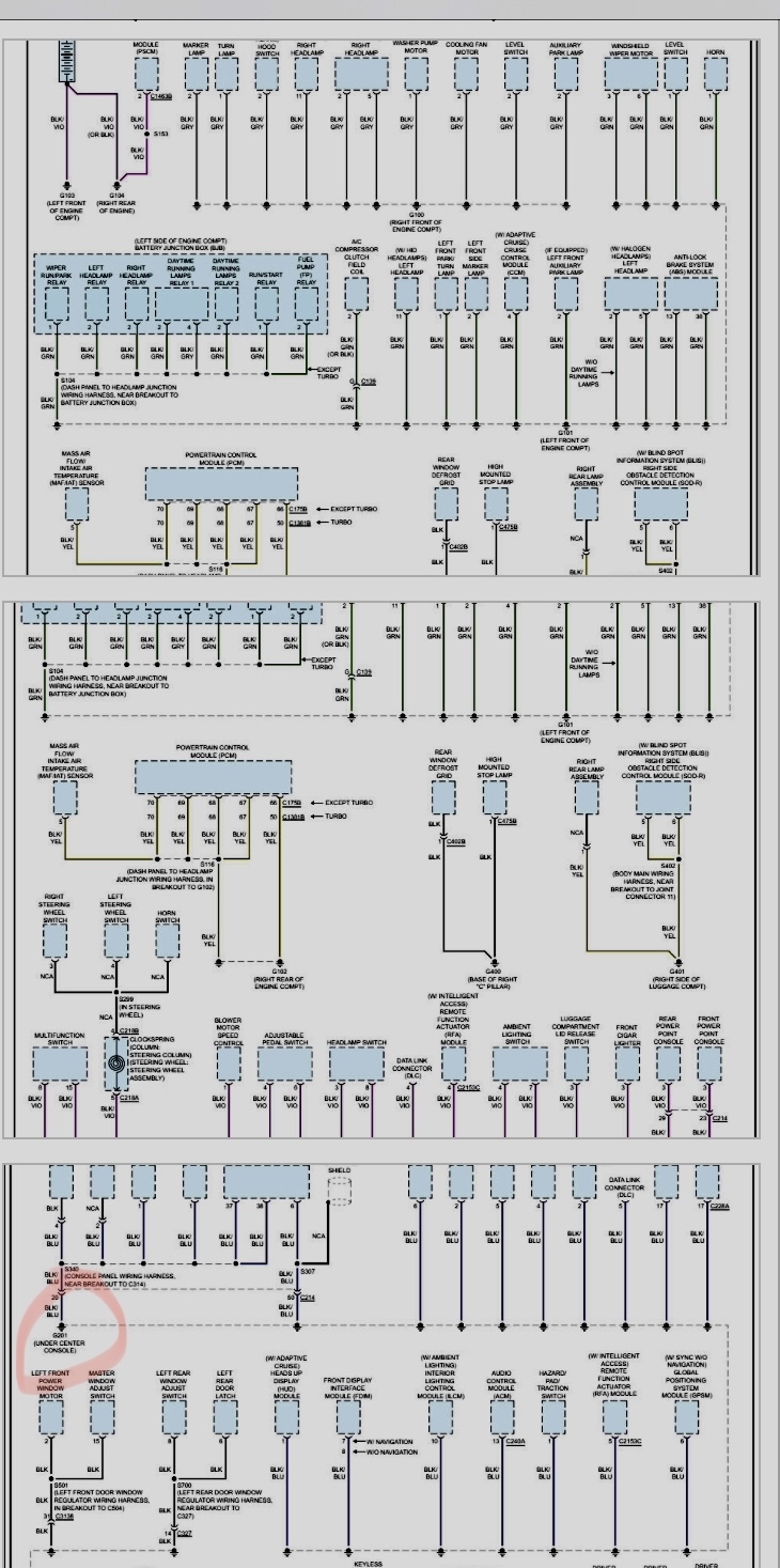

RIBERT2431

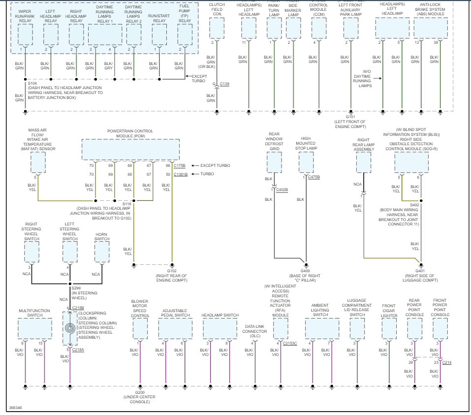

Also, I cannot physically find the ground circled in the attached picture. Any guidance is greatly appreciated.

  • 55,423 POSTS

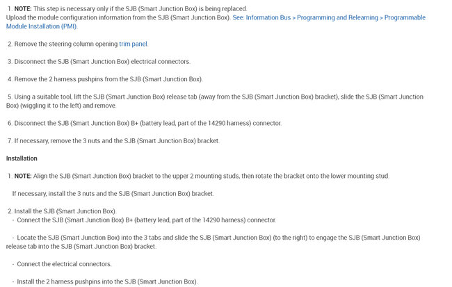

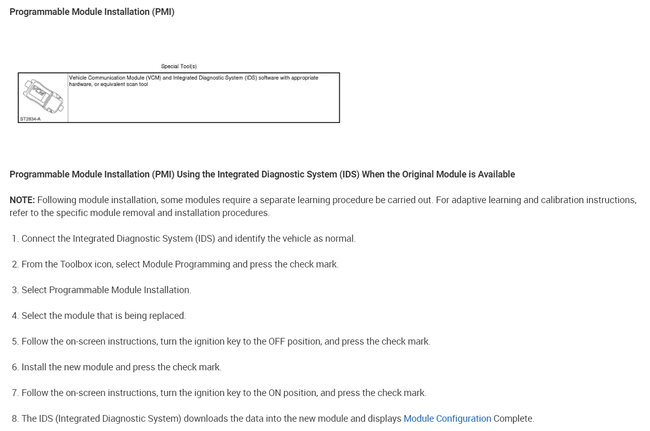

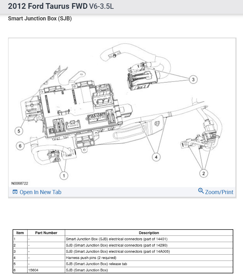

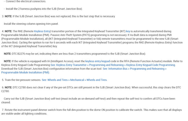

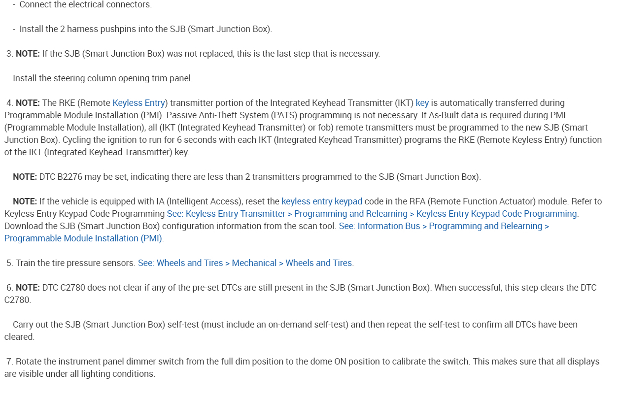

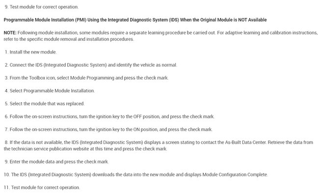

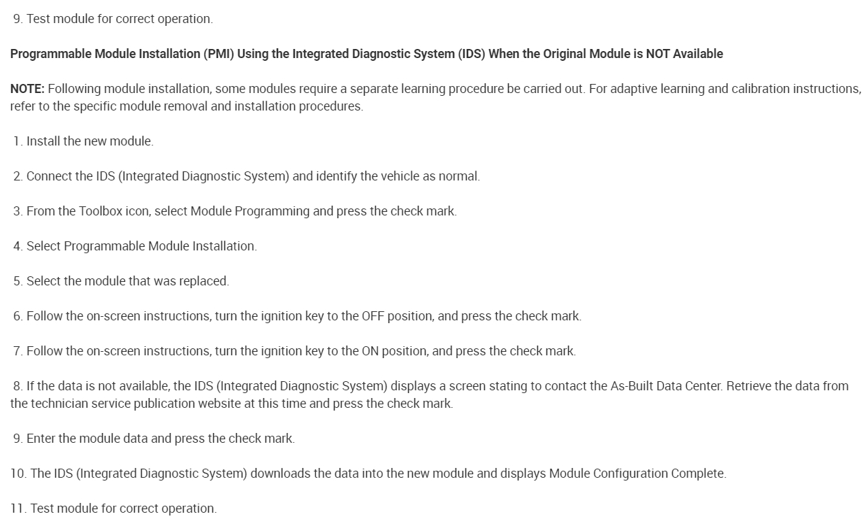

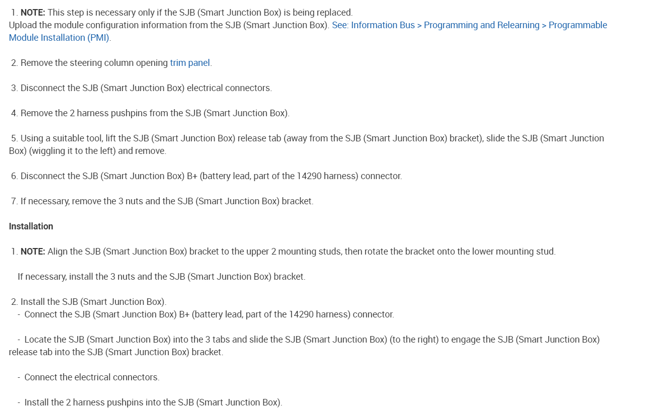

I have seen the SJB go out causing the problem you have described, to be sure let's do a CAN scan. You can get a CAN scanner (Controller Area Network) which will work on most cars from Amazon.
https://youtu.be/u-4syLc-ifQ
The C3138 ground I believe is in the door on the driver's side. Here is how to change the SJB out, you can get a preprogrammed unit by searching Google or Ebay. Check out the images (below). Please let us know what happens.
