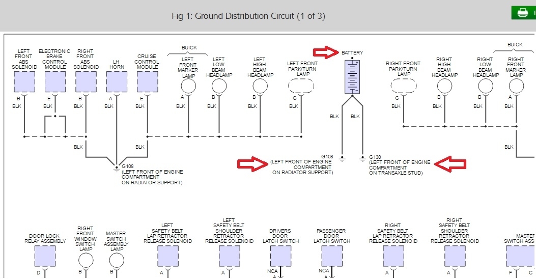

Where does the ground wire under the hood mount to comes from the battery cable?

I was surfing the questions. (Really looking for a Jeep to answer)
(No broke Jeeps today)
Although I'm ignorant of your vehicle, I was able to look it up in "Prodemand"
This is of a 3.1 Liter (You may have mis-posted your engine size) in a '95 Buick Century
Below is a partial diagram of the 'grounds' that you can click on
Lemme know if it helps
