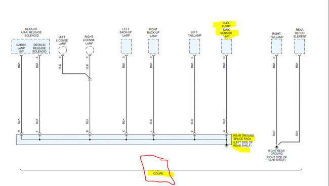

Ground strap at fuse panel has disconnected and fuel pump won't kick on. since I can't find where to reconnect it I need diagram or pictures please.
Jul 29, 2021 at 5:48 AM
  • 110,240 POSTS

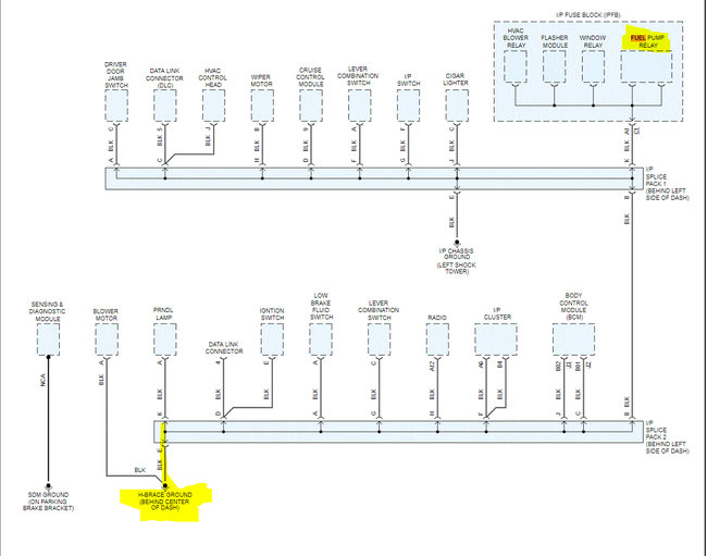

The fuse box isn't grounded. I'm not sure exactly what has happened.

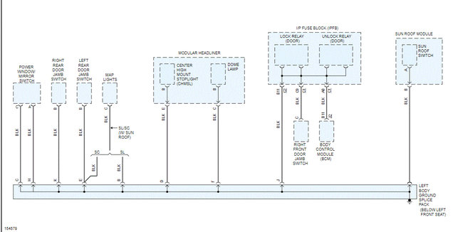

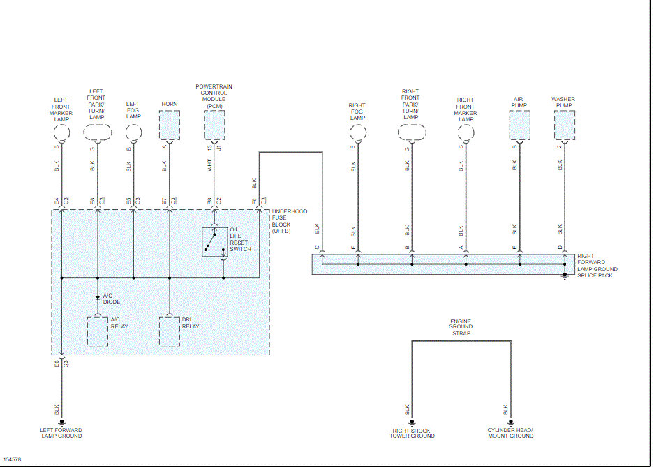

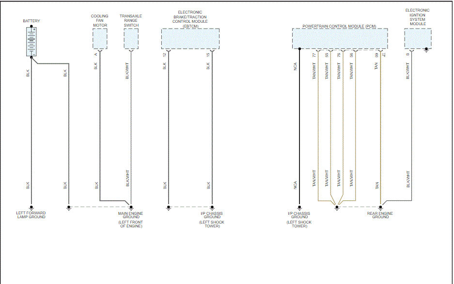

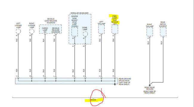

As far as the grounds, I attached the ground distribution for the entire vehicle below. I highlighted everything related to the fuel pump. Let me know if this helps.
Also, let me know if you have other questions or if there is something I can do to help.
