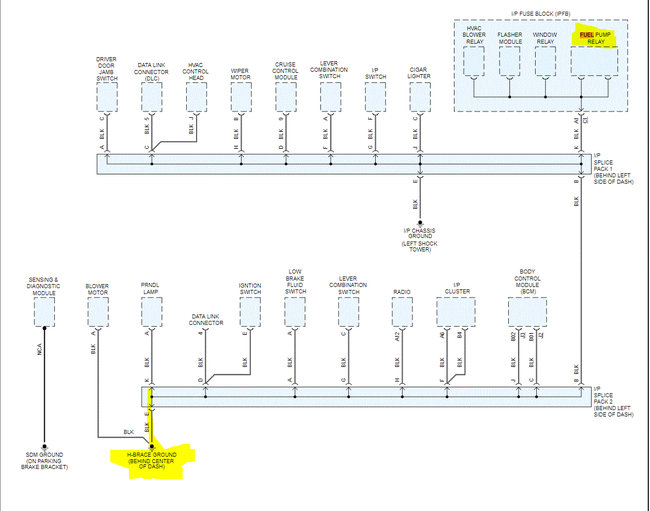

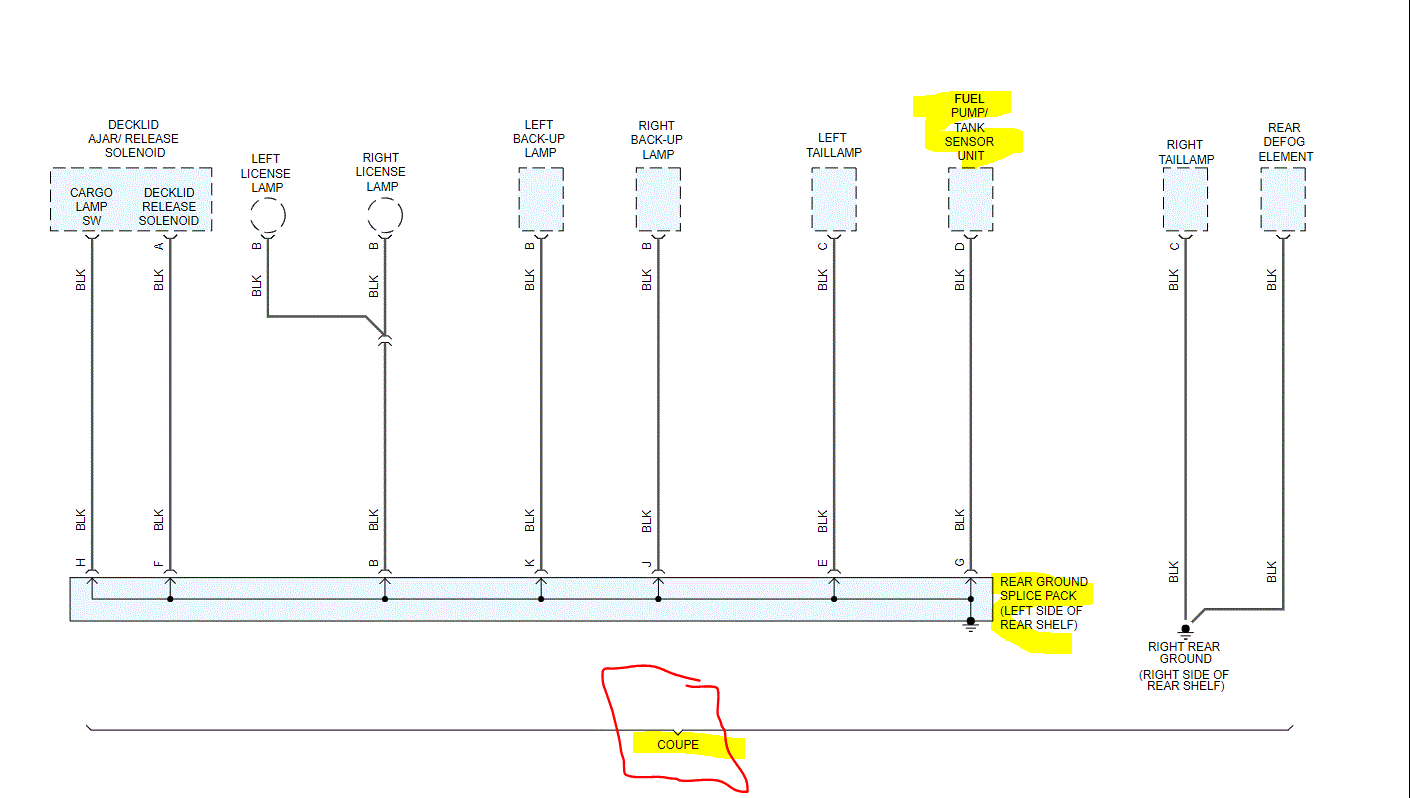

Ground strap at fuse panel has disconnected and fuel pump won't kick on. since I can't find where to reconnect it I need diagram or pictures please.

The fuse box isn't grounded. I'm not sure exactly what has happened.

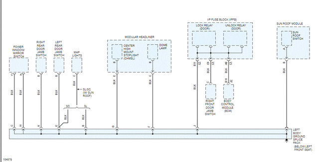

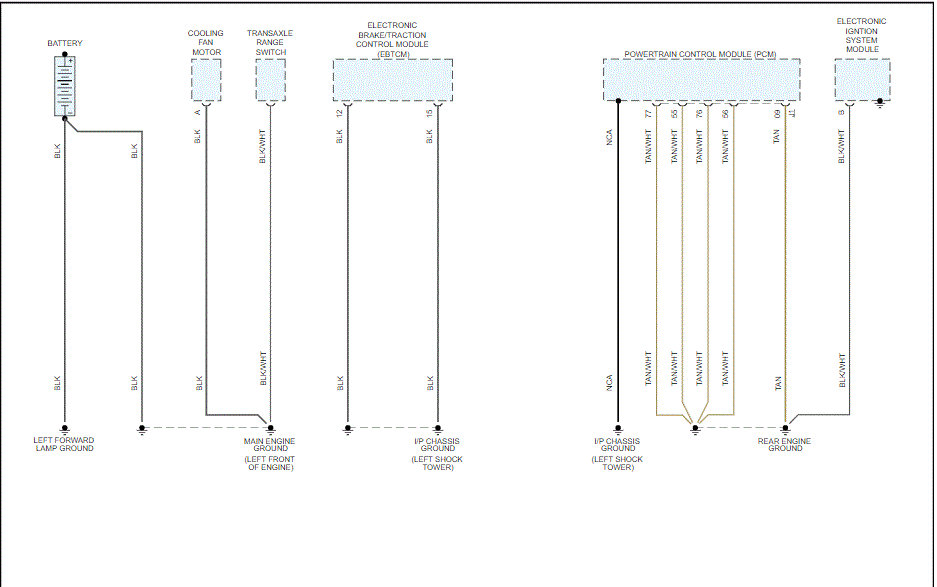

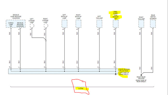

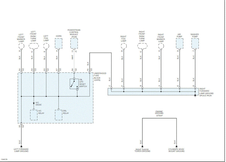

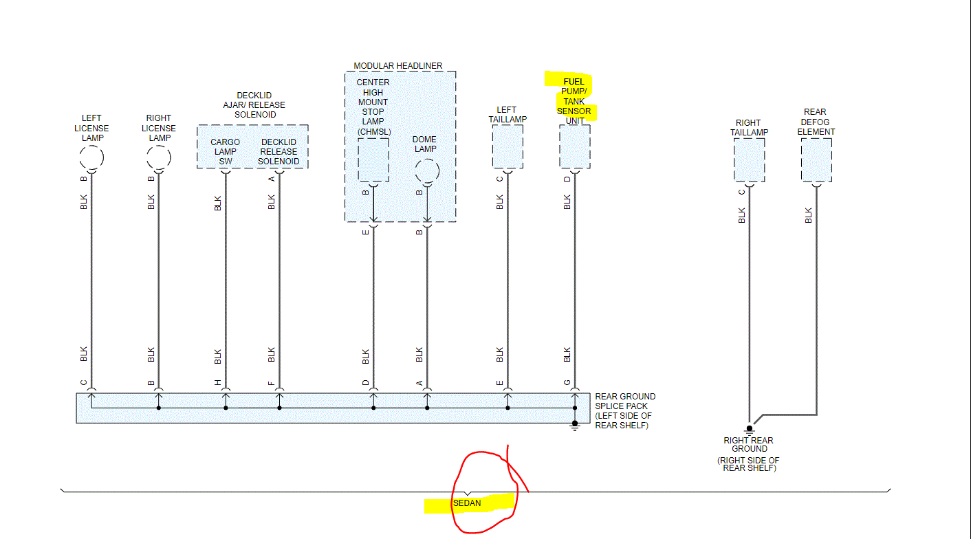

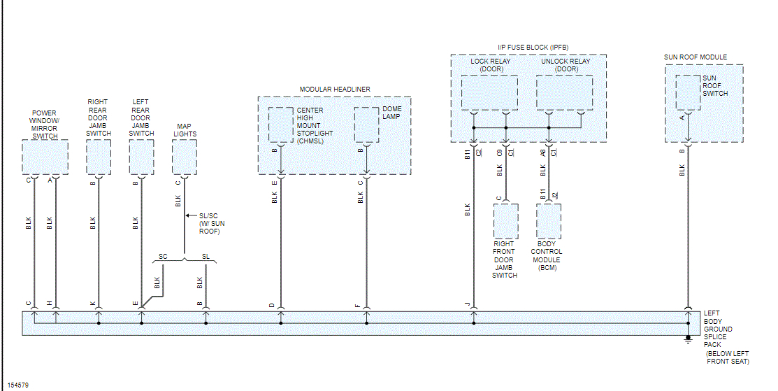

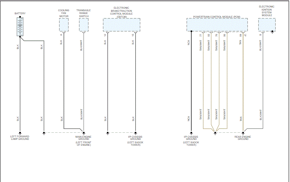

As far as the grounds, I attached the ground distribution for the entire vehicle below. I highlighted everything related to the fuel pump. Let me know if this helps.
Also, let me know if you have other questions or if there is something I can do to help.
