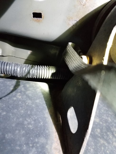

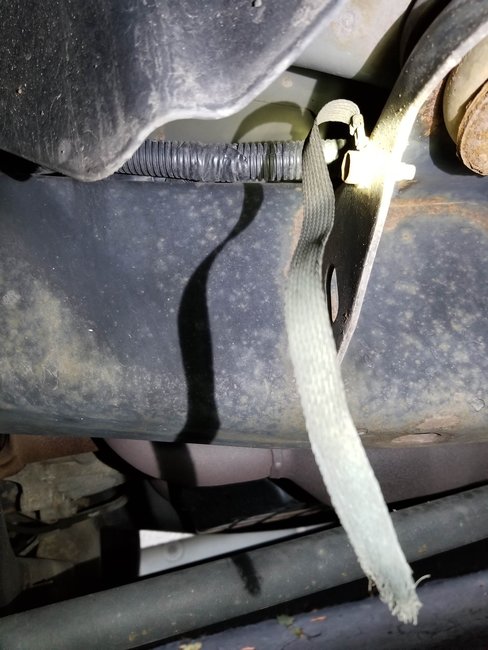

There is a ground strap hanging loose in the left front wheel well. The end has been sheared off so I don't know what kind of connector it had. I need to know where it should be attached.
I recently had new ball joints and front brakes and rotors installed.

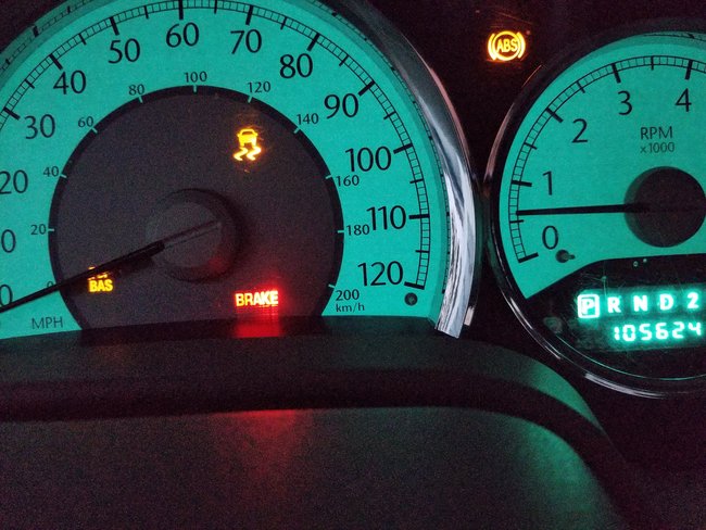

Shortly after this work was done my ABS, ESP/BAS and skid control lights came on and have been on ever since.
I was wondering if they could have broken the ground strap when they were working on the car and if that might be the reason the dash lights came on.

Is it possible for you to get a pic and upload it for me to see? Usually, the ground straps will run to a secure place on the body or frame of the vehicle.
As far as the ABS, they would have been working all around the sensor wiring, so it is possible they left something disconnected or broken. It could be the ground strap, so lets get that fixed first and see if the light goes out.

Thanks for the quick reply. I was a little inaccurate in the position of the ground strap, it's actually just behind the wheel well. I've taken a few photos and will try to attach them to this reply. I'm not really good with this stuff; but, I'll do my best. The one photo is looking straight up at the strap and the other is on a bit of an angle looking towards the back of the vehicle. The photo of the dash shows the warning lights. The brake light is because of a problem with the emergency brake system. I was told by a mechanic that it was probably caused by sensor and didn't affect the function of the EB.

The ground most likely went to the engine block or transmission housing. Check along the side of it for the other end (connector). I don't think that is causing the ABS issues, but anything is possible.

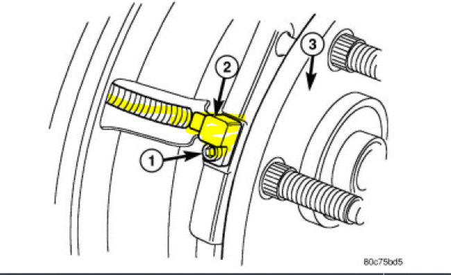

As far as the ABS and traction control lights, it is likely a sensor. Since work was done on the front, check to make sure the wiring wasn't damaged or disconnected. The actual sensor is located behind the brake rotor, but the wiring come through the rear of the backing plate. Check to see on both front wheels if anything happened. See pic 1.

The image is for the ABS sensor. can you see the other end of the ground strap? it will go the body or engine/transmission.

The end that is attached is just before the front strut on the left side (drivers side) and is attached to the frame. Freezing weather here in N.E. PA, haven't been able to get back out to look at it. When I checked in September I couldn't find where the other end was supposed to go. Did Joe post the picture with the idea that it should be connected to the ABS sensor?

The grounds strap it does not go to the ABS sensor, you will need to look around to find the other end. if you can upload more image of the area we can help you better.

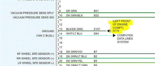

The ground comes from a black/dark green wire (left front of the engine compartment). Take look at pic 1.
It is indicated by G114. You have a loose wiring harness. See if there is a black/dark green wire in it.

Thanks for your help. It turned out to be the ABS Control Module. The problem with that is it costs between $550.00 and $750.00 to buy a new one and then you have to have it reprogrammed. I'll have to live without the ABS.
I foolishly tried to take it apart to see if there was anything that could be fixed and made things worse.
After messing it up I found out that there are places that would have rebuilt it for between $200.00 and $300.00 plus shipping.
It was an expensive lesson.
The problem is there were only about 60 some thousand of these Aspens made; so it isn't worth it to the rebuilder's to make the parts like this.
Again, thanks for trying to help.
P.S. the ground strap was originally attached to the top of the engine. It took a bit of searching; but, I finally found a piece of the strap still attached at the top.

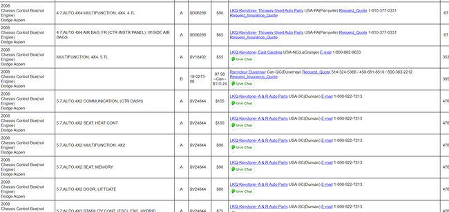

Good morning,
I attached a website for you to view for the module.
www.car-part.com.
They have pages of used modules for you. You will still need to have it programmed but it costs a lot less than what you were looking at.
https://www.2carpros.com/articles/how-to-replace-a-abs-controller
