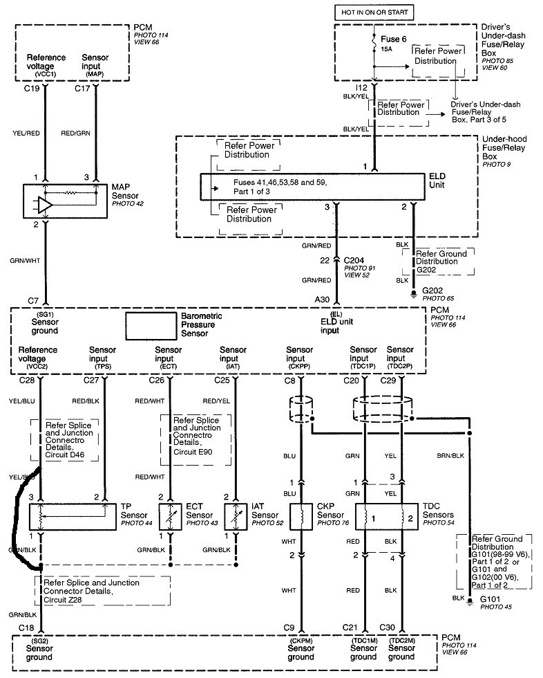

Hello! I have a very interesting problem that might just be the end of me. Various sensors around the throttle body are receiving high voltages according to the OBD (P0108, P0118, P0123, P0113, and P1498). The previous owner of the car created a temporary solution by running a ground wire from the driver side fender and tapping that wire into the green/black wire of the harness that connects to the throttle position sensor. I'm not sure why/how this works, but it eliminates the high voltages to other sensors as well. After talking to a mechanic about it, he told me that there is a "short-to-power" problem, which is why the previous owner created this ground rig, instead of locating the root cause.
I want to eliminate the rig and fix the problem but I'm not entirely sure how!
Here are images of the white ground wire that is tapped to the throttle position sensor: https://imgur.com/a/1wovPmY?s=sms

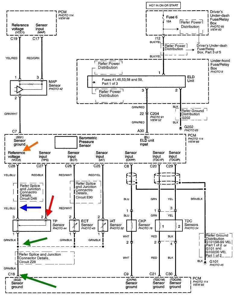

This break, or "open circuit", can be anywhere from the terminal inside the sensor, all the way back to a defect inside the PCM, but we can narrow it down by the fact it is affecting other sensors too. We have to look for what they all have in common. The first diagram is the part that shows some of the sensors in question. The second one is the same thing, but I added some nifty arrows to help explain this.

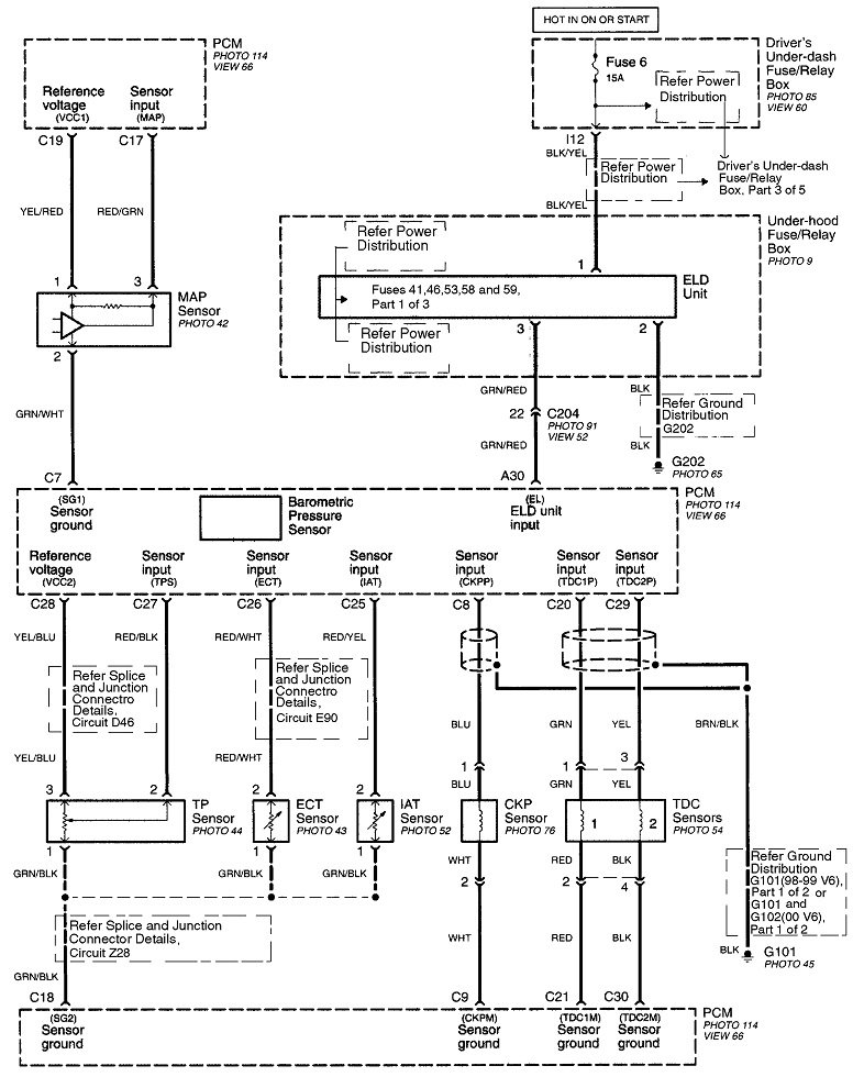

Your mechanic suggested there is a short to power. That is what is shown in the third diagram where I added the heavy black line. In fact, that can not put voltage on the green / black wire. It draws the 5.0-volt supply down to 0 volts, so if your mechanic was right about the short to power, you'd be seeing 0 volts for all the sensor readings, and your fault codes would all refer to "Intake Air Temperature Circuit Low Input", for example, not high.

There's three more important points of great value I should add. The first one has to do with throttle position sensors. You see where 5.0 volts is applied to the terminal with the yellow / blue wire, (blue arrow), and the terminal with the green / black wire is grounded and will have 0 volts. Inside the sensor is a carbon strip with one end connected to each of those terminals. The closer along that strip you get to the 5.0-volt terminal, the closer the voltage will also get to 5.0 volts. In the middle of the strip, it's halfway between 5.0 volts and 0 volts, so you'll see 2.5 volts. The signal terminal is a movable contact that slides along that carbon strip, and it sees the voltage at the point it's touching. That contact is tied to the throttle blade, so as the throttle is opened more and more, the voltage seen on the signal wire goes higher and higher. That voltage is what is seen on the red / black wire, (red arrow), that is the input to the PCM.
When the green / black ground circuit is open, (broken), as with the air flow blocked at the air tool, 5.0 volts is seen all through the TPS wiring and sensor, including on the signal terminal. At this point I have to add one more critical tidbit. The TPS has mechanical stops inside it that prevent the movable contact from going lower than 0.5 volts or higher than 4.5 volts. Those numbers are for training purposes. In actual practice, you could find the range from idle to wide-open-throttle might be 0.72 volts to 4.24 volts, for example. The actual values are irrelevant, but the important point is the signal voltage will never reach 0.0 volts or 5.0 volts, . . . unless there is a break in the circuit.
If the 5.0-volt feed wire is open, you'll have 0.0 volts everywhere in the TPS. If its ground circuit is open, you'll see 5.0 volts everywhere. Those two voltages can only occur when there's a defect in the circuit, and those are the values that trigger the diagnostic fault codes. This is why you see 5.0 volts on the ground wire at the TPS. You'll find that on the signal wire too.
For my next comment of great value, you'll notice all the ground wires for all the sensors do not actually go to ground. They go back to the PCM, then they go to ground on one of the computer's multiple ground wires. They do that so current flowing through the sensors can be monitored by circuitry inside the computer. As a result of some of the electrical pressure, (voltage) being dropped across that circuitry, you will actually read close to 0.2 volts on the sensors' ground wires. When the previous owner added his external ground wire, he got the sensors working properly, but he bypassed that monitoring circuit in the PCM. That would confuse the PCM, and while there might not be a fault code available for that defect, it could stop it from running some of the other hundreds of tests it runs continually while you're driving. That means it might not detect certain other defects or set fault codes for them, that is, until you repair the circuit. That's when those tests will resume, and any previously-undetected problems will be seen, and new fault codes will set.
If your eyeballs aren't spinning by now, this can all be boiled down to the green / black wire has to have a break in it between the two green arrows. That is the only section that includes the throttle position sensor, intake air temperature sensor, and the engine coolant temperature sensor.
To add some more confusion related to the two-wire IAT and ECT sensors, they too are fed with the carefully-regulated 5.0 volts from inside the PCM, but only the ground and signal wires go to the actual sensors. The 5.0-volt feed circuits include a resistor inside the PCM that drops some of that 5.0 volts. The rest shows up on the red / white and red / yellow signal wires. Temperature sensors have just one component inside them. That is a "thermistor" which is a resistor that changes value with changes in temperature. As temperature increases, the resistance goes down, so more current flows through the circuit, more of the 5.0 volts is dropped across the resistor inside the PCM, and less voltage is left to be dropped across the sensor. To say that a different way, as temperature goes up, the voltage on the signal wire goes down. As with the TPS, the acceptable range of signal voltage is 0.5 to 4.5 volts. It will never get down to 0 volts unless you ground the signal wire with a jumper wire. It will never get up to 5.0 volts unless you unplug the connector or there's a break in either wire.
