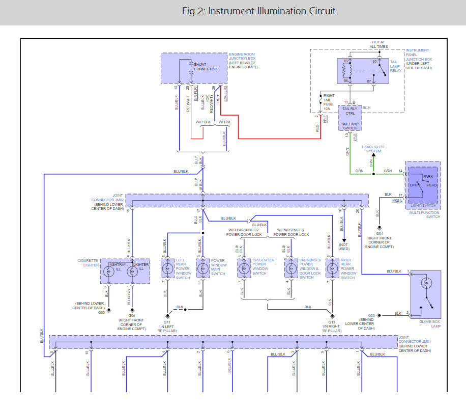

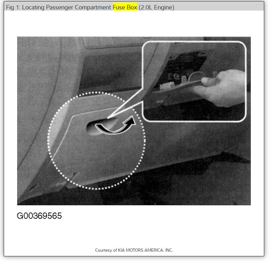

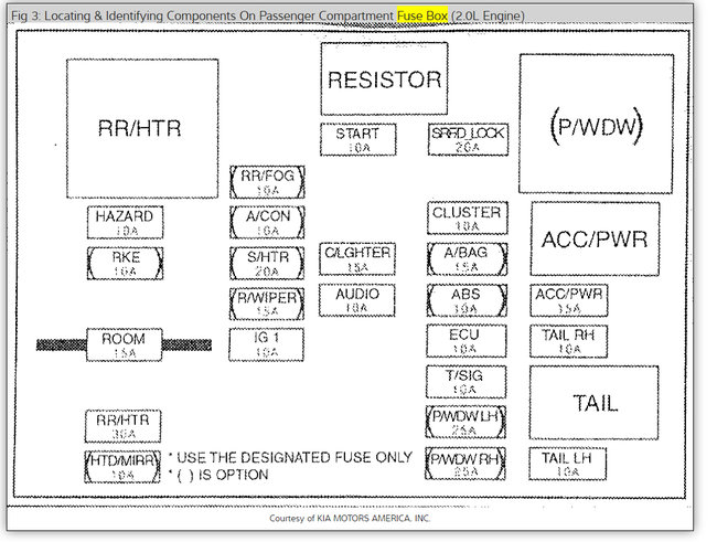

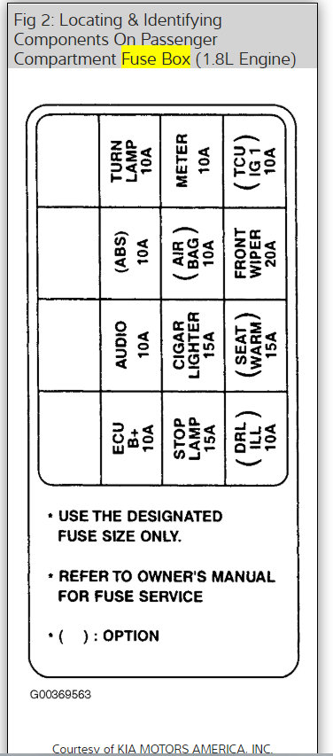

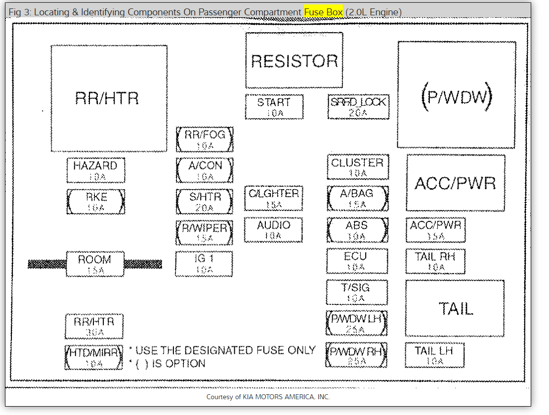

There is a ground behind the lower center of the dash you need to check along with the right tail fuse 10 amp in the interior fuse panel. Here is a guide to help you with the fuse location and I have included the cluster illumination wiring diagrams so you can see how the system works.
Check out the images (below). Please let us know what you find. We are interested to see what it is.
Sep 28, 2022 at 11:26 AM

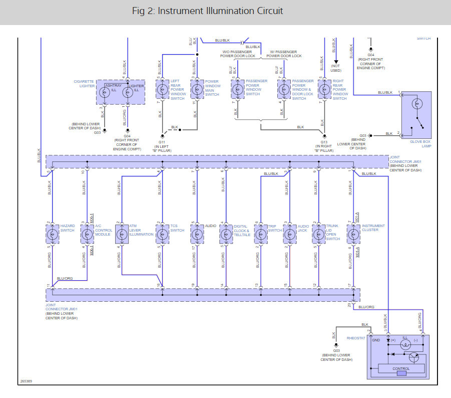

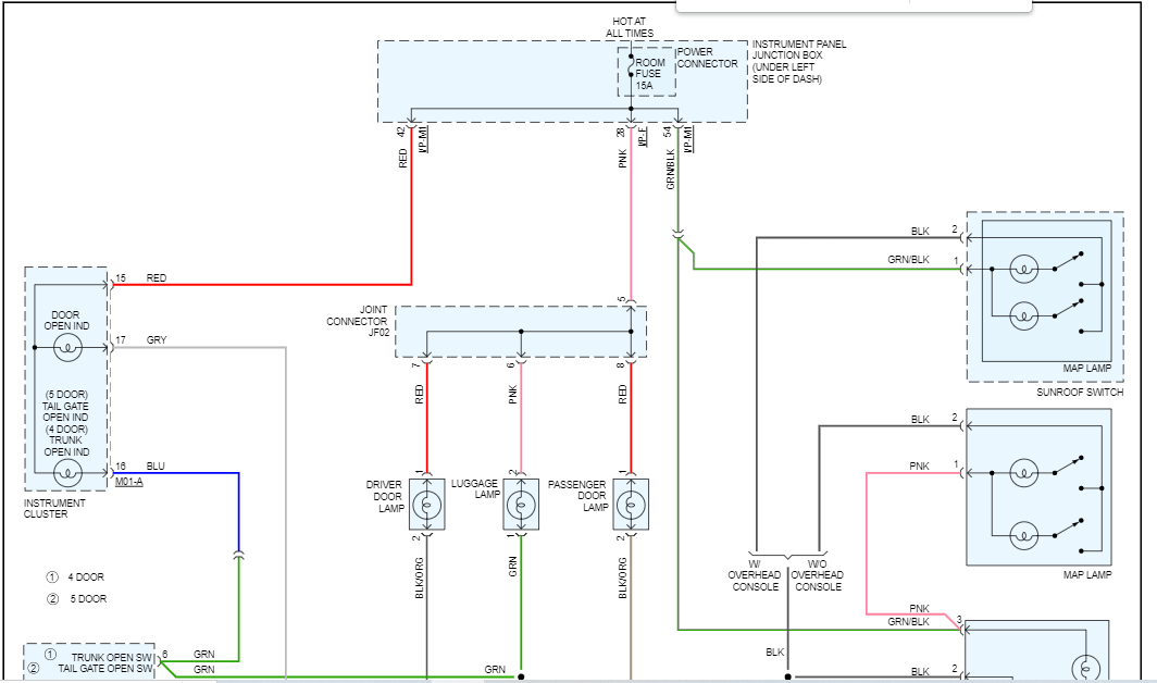

Are these wires going to the glove box light or just near it? Interestingly, I find nothing in the wiring schematic for the glove box light. I attached the schematic below, so you have a reference.
I can tell you that a black wire is most likely a ground wire. Looking at the interior courtesy lights circuits, blue seems to run to the body control module, but again, it is coming from things other than a glove box. That is where I get lost.
Take a look at the schematic and let me know your thoughts. Also, did you change anything as far as relays to compensate for the LED headlamps?
Oct 1, 2022 at 7:11 AM

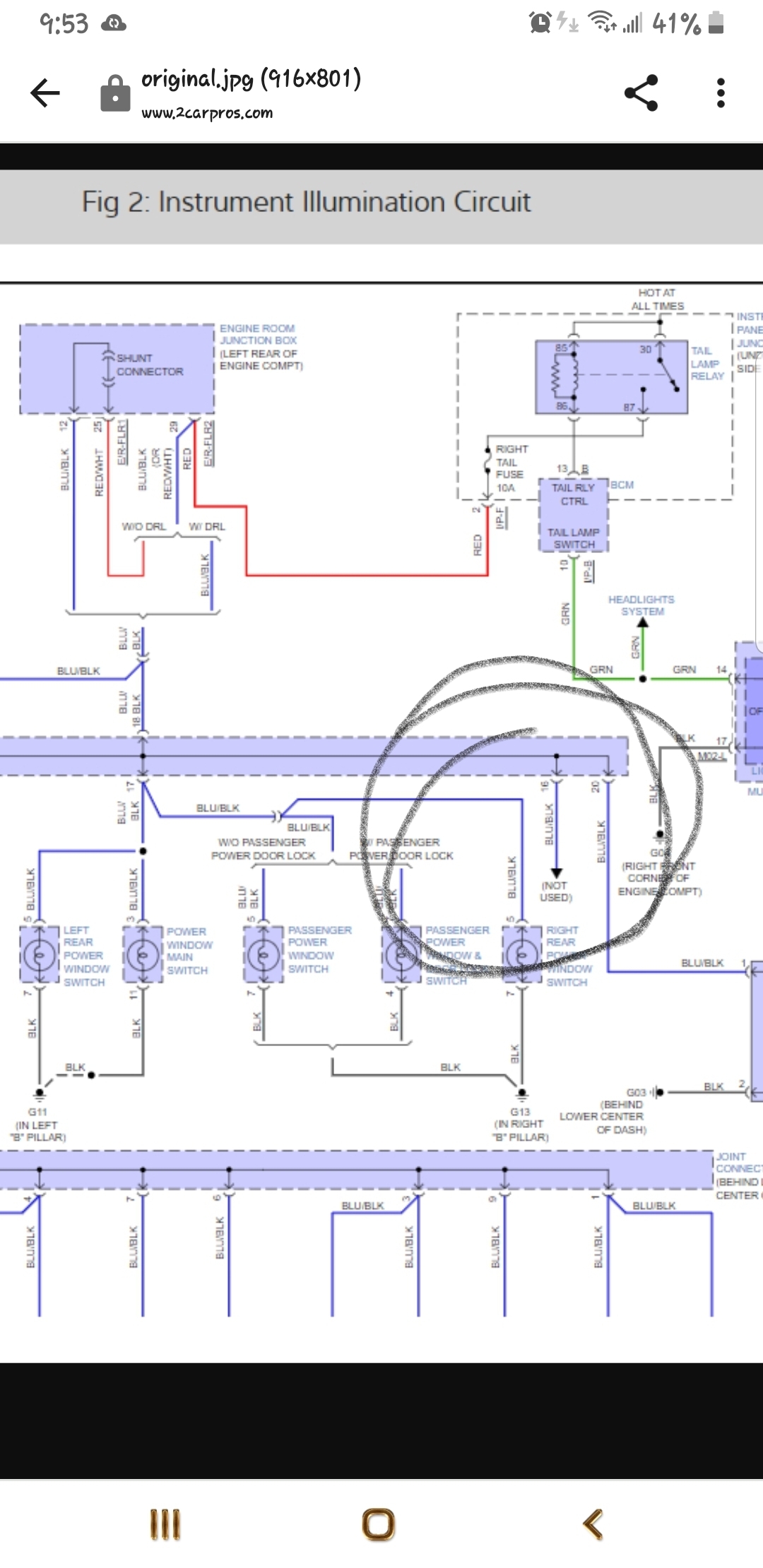

Yeah Joe, Ken sent this instrument cluster diagram. And it says not used.
