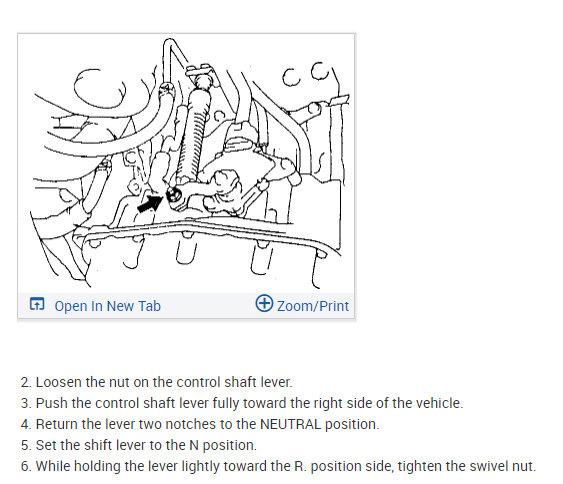

There really aren't any grounds under the dash that would prevent the starter from engaging. Have you made sure the neutral safety switch / cable are properly adjusted?

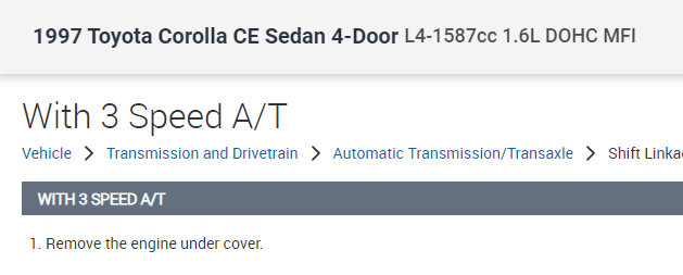

I attached directions below for adjustment. Take a look and let me know if this is what you did. Also, as a test, with the transmission in park and your foot on the brake, hold the key in the start position while you shift through all gears. See if the starter reacts.
