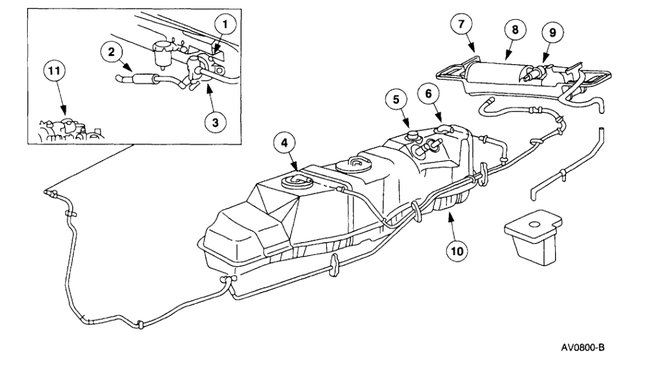

EVAP leak
1999 FORD F-150
240,000 MILES • 5.4L • V8 • 4WD
ROBERT C CRENSHAW
Emissions. I have a gross leak. Replaced gas cap and vapor solenoid. The small lower vapor line coming from the bottom of the solenoid is cut. Where does it attach to on the engine?
May 16, 2019 at 4:17 AM
SCGRANTURISMO
  • 4,897 POSTS

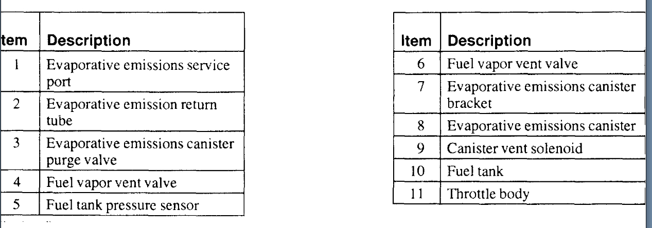

I have included an exploded diagram of your vehicle's EVAP system in the diagrams down below for you. Please go over the diagram and get back to us with what you are able to find out.
