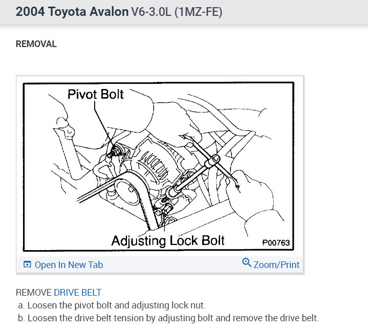

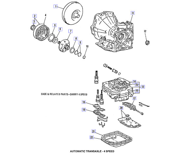

Started out of the blue. The 2nd/3rd acceleration attempt in video you can hear it best.
Sounds bad to me. Any ideas of what this could be?

Thank you for the video. It sounds like the transmission I would service the fluid and filter while taking note the condition of the old fluid. (Burnt?) Here is a guide to help walk you through the steps with instructions below to show you how on your car. It also could be a heat shield on the exhaust system, for this make sure the engine is cold then raise the car up and use a rubber mallet to gently bang on the exhaust system to see if you can duplicate the noise. The last thing I can think of is the serpentine belt tension, lift the hood to check it, I have left how to apply more tension on the belt in the images below.
Fluid type: .................... Toyota Genuine ATF D-II or DEXRON III (DEXRON II)
Capacities
Fluid capacity (drain and refill): .................... Up to 4.75 L (5.0 qt., 4.2 Imp.qt.)
