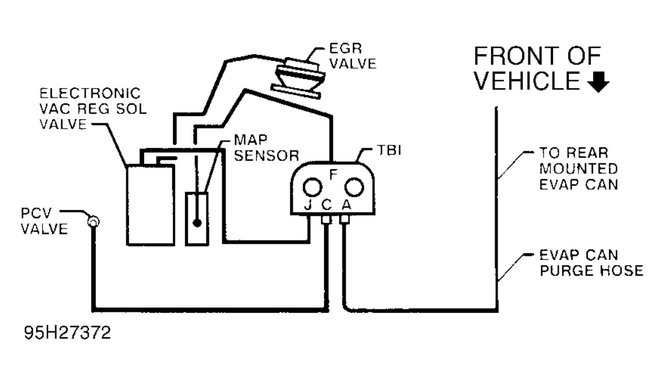

HMAC300
  • 48,601 POSTS
old lines can break , grit from pcv if line was bad , excessive heat, maybe wrong type of tubing this is vacuum schematic for a 4.3L tbi hopefully it is correct

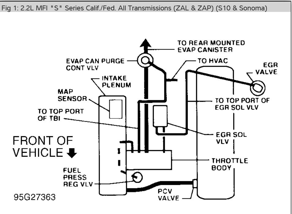

CAJUNGUY1965
  • 39 POSTS
Mine is a 2.2ltr. 4 cylinder. There was grit in one of the "blow holes" where vaccumm pump plugs in. Would broken plastic vaccumm lines cause this? And is it possible for truck to get vapor locked like the older models did
Jan 27, 2016 at 7:42 AM
HMAC300
  • 48,601 POSTS
no it won't vapor lock because of electric fuel pump. broken plastic would do it though here is correct one
