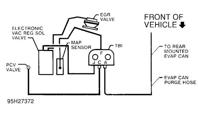

My 1995 Chevy s10 has a vacuum pump which plugs into main air intake cover over the throttle plate. There is 4 holes. Two smaller and two larger. One of each is on the left of throttle plate the other two is on the right of throttle plate. I removed the air intake cover and cleaned carbon build up using carburetor cleaner. I thought I had the problem solved. While driving the engine stalls. The larger hole only on the right of throttle plate had some grit/pebbles like inside the hole. I cleaned hole and could go a few more miles before stalling again. It looks like this is coming from where tps is. The only place I couldn't clean to well. How do I clean this thoroughly and properly?

I have changed cps,fuel pump&filter,tps,iacv,oil pressure switch,cleaned throttle body and plate. The only thing not changed is vaccumm pump harness as and fuel pump regulator. Still having same trouble. Two vaccumm lines that goes to egr and fuel pressure regulator are broken. What can do this?

old lines can break , grit from pcv if line was bad , excessive heat, maybe wrong type of tubing this is vacuum schematic for a 4.3L tbi hopefully it is correct

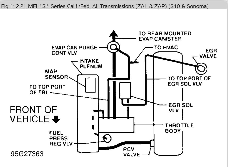

Mine is a 2.2ltr. 4 cylinder. There was grit in one of the "blow holes" where vaccumm pump plugs in. Would broken plastic vaccumm lines cause this? And is it possible for truck to get vapor locked like the older models did

no it won't vapor lock because of electric fuel pump. broken plastic would do it though here is correct one
