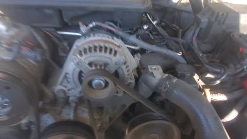

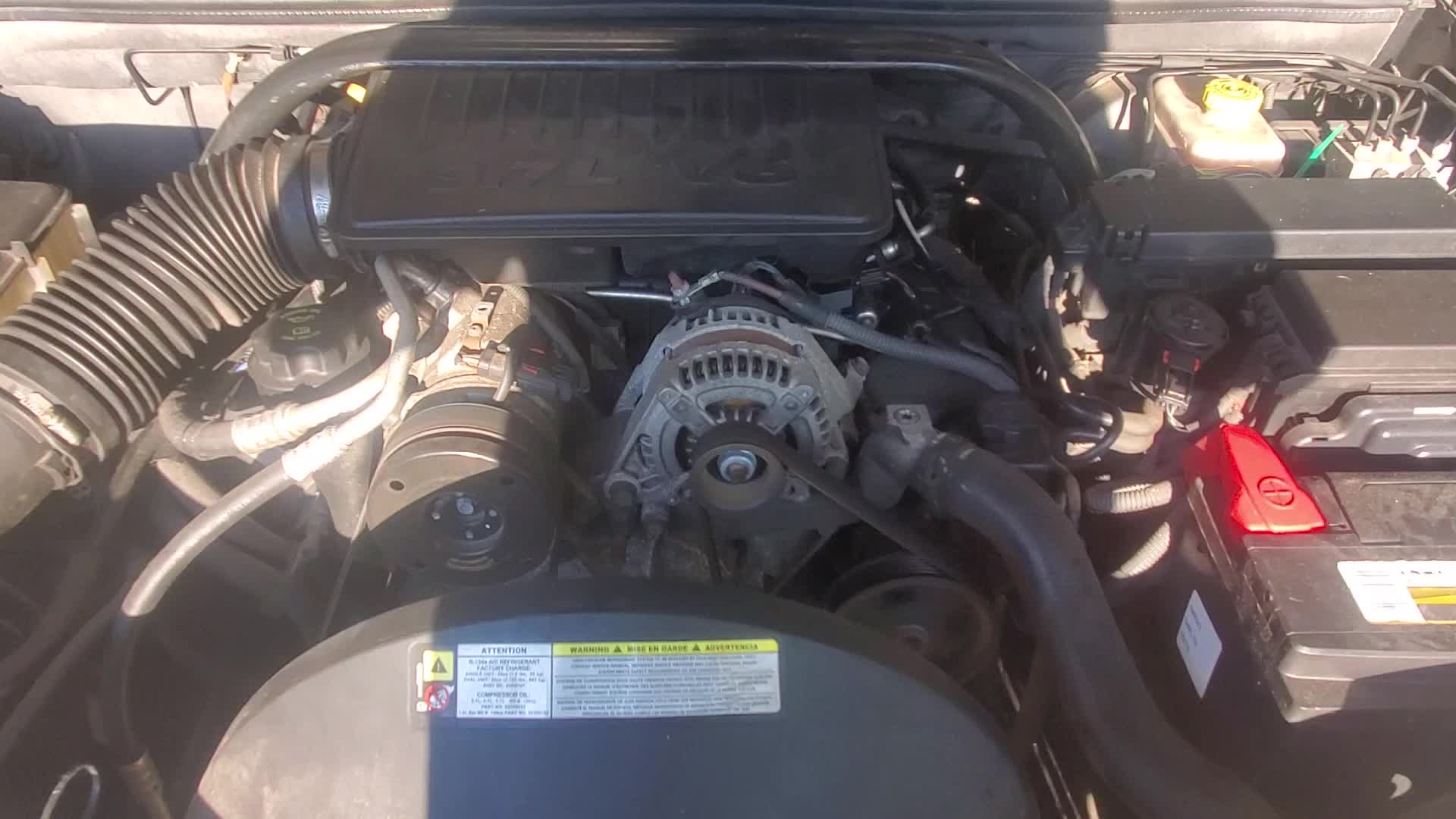

when starting cold engine i hear a loud grinding tapping noise. After 30 seconds or so it dissipates. Had oil sensor replaced because it was bad. Replaced all spark plugs and oil 2 due to misfire in cylinder 2. After replacing plugs and the coil is when the noise appeared. Need help.

Can you upload a video of the noise to this post so I can hear the noise? I need to hear what you hear.

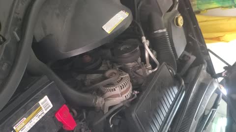

I can but not until later in day after it sits for 5+ hours. Only does it when engine is cold.
Jun 12, 2020 at 5:07 AM
Okay, sounds good.
Upload it when you can. I will be here to help.

This is milder than early this morning it's the like tapping noise right at the beginning.
Jun 12, 2020 at 10:56 AM
That noise is from the lower end of the motor. There is no oil lubricating the bearings on startup.
https://www.2carpros.com/articles/engine-noises
This could be the oil pump that is draining back and the system has to prime all over again after sitting.
https://www.2carpros.com/articles/high-or-low-engine-oil-pressure
You need to get this fixed as soon as you can. Each time you start it like that, you are doing damage to the bearings.
I would have someone check the oil pressure when it is cold to verify.

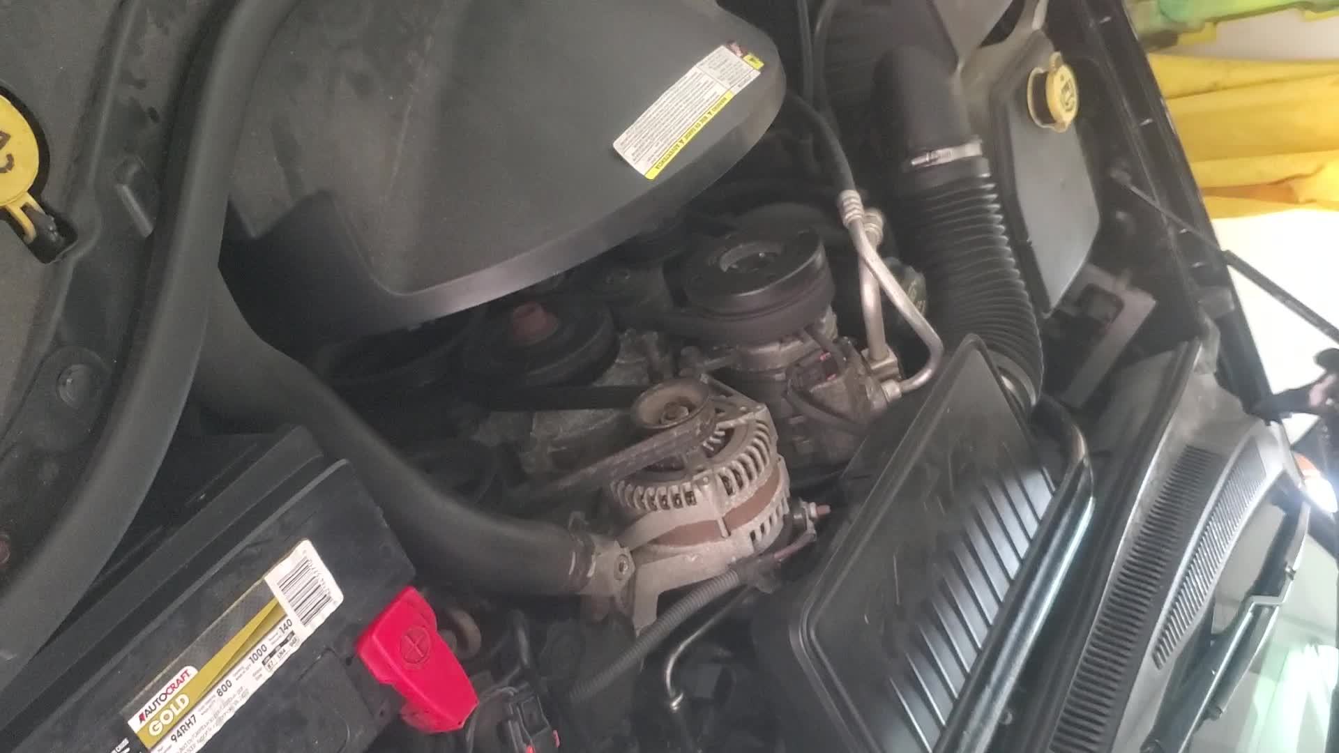

This is after running at a idle which is only 500 rpm's. For 10 minutes, just up and down the long driveway.
Jun 12, 2020 at 4:26 PM
It sounds like there is no oil at the top of the motor.
Back to the oil pump as we discussed.

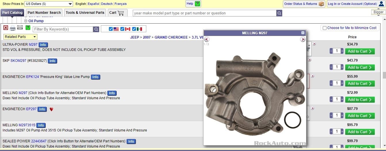

How hard is it to change for someone who has some knowledge around and under a car?
Jun 12, 2020 at 4:36 PM

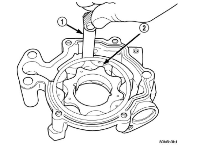

It is a huge project as it requires removal of the oil pan and the front cover of the motor.
The book pays over 8 hours in a shop for this. If you were to do it, it would about 3 times that time and maybe more as the timing chain has to be removed to gain access.
The steps below sound simple but are very involved.
I attached a YouTube video of the oil pump replacement for the 4.7 but is the same as a 3.7.
https://www.youtube.com/watch?v=AAj4DeFtZp0
https://www.youtube.com/watch?v=qfG4mgvWD5c
The second one is for the oil pan which also has to be removed as well.
REMOVAL
1. Remove the oil pan and pick-up tube.
2. Remove the timing chain cover.
3. Remove the timing chains and tensioners.
4. Remove the four bolts, primary timing chain tensioner and the oil pump.
