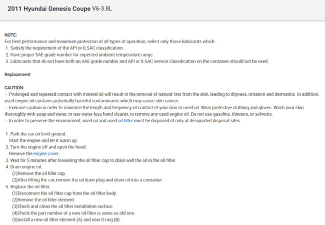

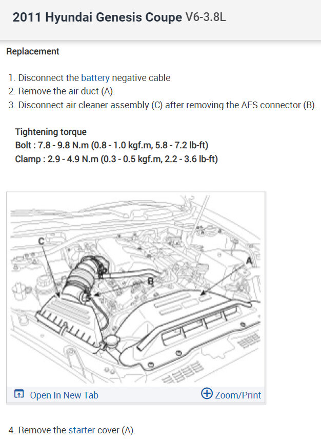

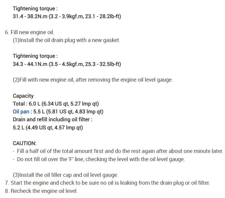

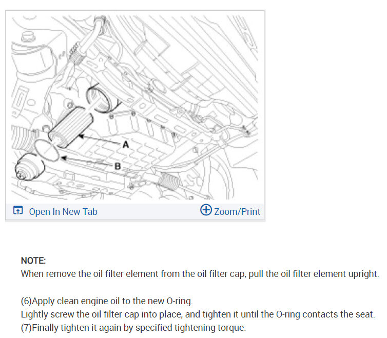

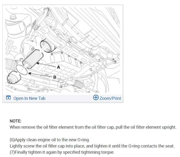

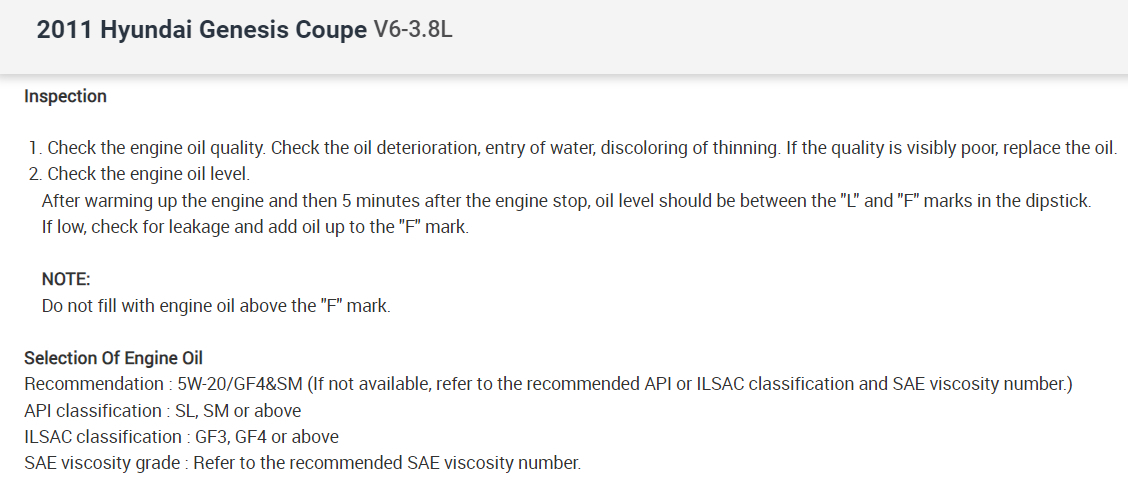

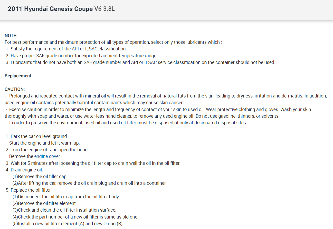

Yes, it does sound like one of the timing chain guides is broken or a tensioner is weak, you might want to try a bottle of Lucas engine oil treatment or change the oil to the next heavier weight. Change the oil filter as well, here is a generic guide to help you step by step with instructions in the diagrams below to show you how on your car:
https://www.2carpros.com/articles/how-to-change-engine-oil-and-filter
Here are the instructions on how to change the engine oil and filter for your car. If this does not help the front of the engine will need to be taken apart and the timing set replaced. Check out the images (below). Please let us know what happens.

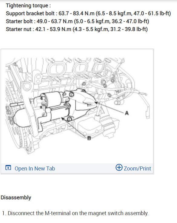

GERAGHTY
Thank you. A friend suggested first changing the starter motor, to eliminate it as a possible source of the grinding sound. If the sound persists, use the Lucas treatment and upgrade the oil viscosity. Does this seem like a reasonable approach?
May 13, 2024 at 10:53 AM
  • 55,412 POSTS

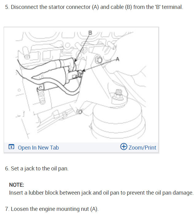

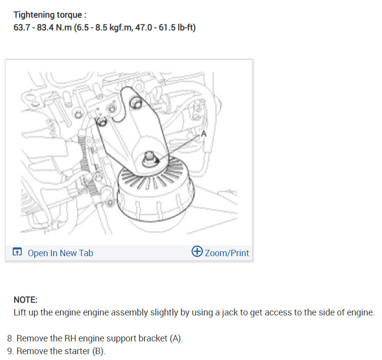

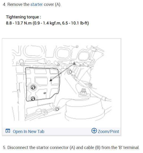

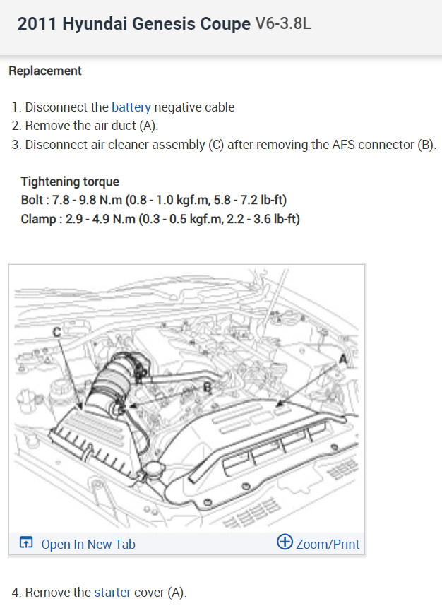

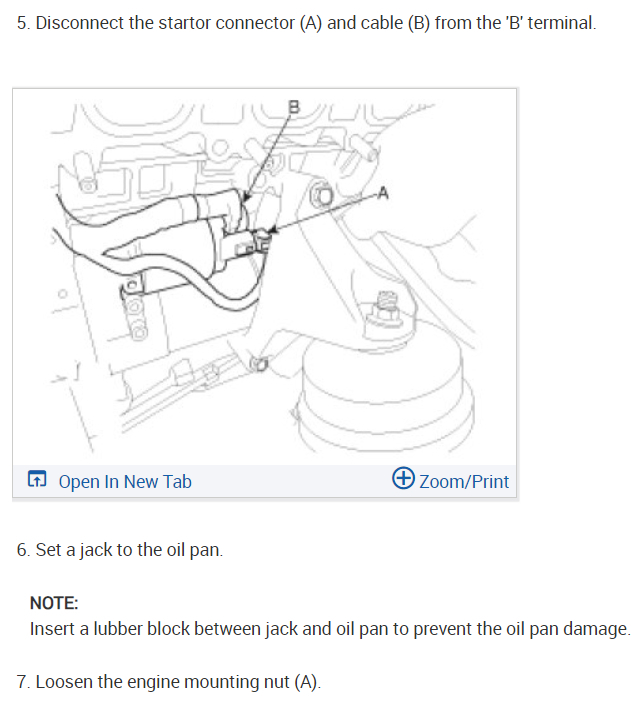

I am not there to hear where the noise is coming from so it might be the starter Bendix being bad, here is how to change it out so we can be sure. Check out the images (below). Please upload pictures or videos in your response to any problems so we can see what to help you with.
