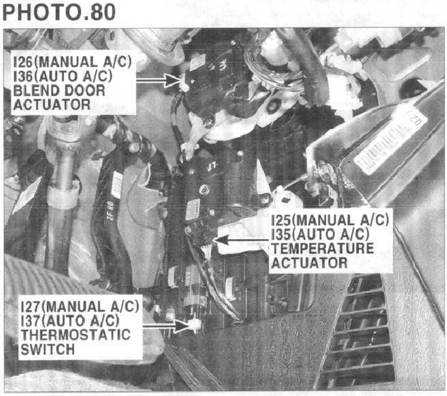

Whenever I turn off the car there is a metallic scraping noise that sounds like something is coming to a stop. Only appears on vehicle turn off and lasts a second. Comes from engine/transmission area.
Feb 20, 2019 at 10:43 PM
SCGRANTURISMO
  • 4,897 POSTS
This could be a blend door actuator which is under the dash near the rear of the and and front of the transmission but is is inside the car. Here is the location so you can check it out. Check out the images (Below). Please let us know how it goes
