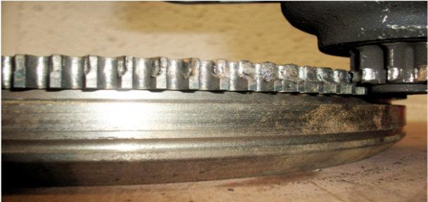

It sounds like the starter motor Bendix gear is not engaging on the ring gear of the flywheel.
Please see below how a starter works.
https://www.2carpros.com/articles/how-a-starter-and-solenoid-works

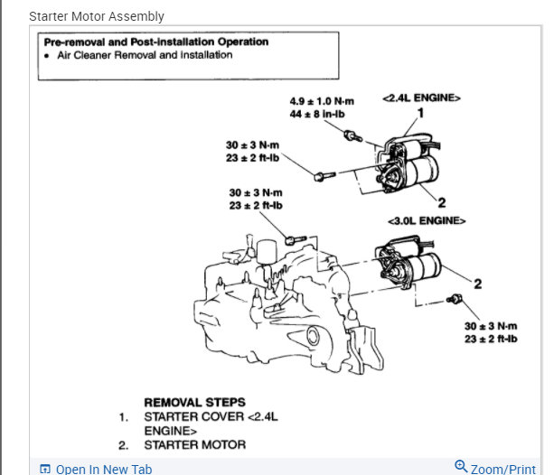

And how to replace a starter.

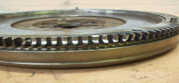

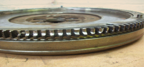

Basically, the starter gear is not messing with the flex plate and so it just grinds or clicks. Unfortunately, the only real way to know is to remove it and inspect the teeth on both gears.
Please see picture below of Bendix.
Please let us know how you get along.
Cheers, Boris

My apologies for the slow reply. This issue ended up being exactly what you said, "It sounds like the starter motor Bendix gear is not engaging on the ring gear of the flywheel.". The starter had not been properly locked down (there was no bolt holding it down) so it got loose and was pointing in the wrong direction. This was a pretty easy fix but required a tow to my mechanic. Thanks again for your help.
