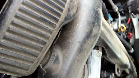

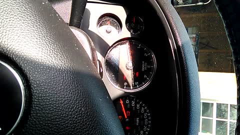

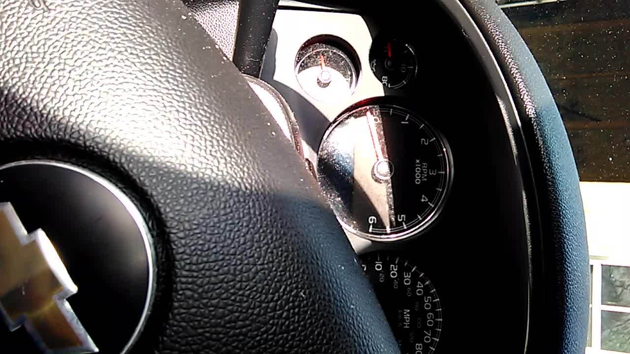

When I turn my key to on, not actually trying to start the vehicle, I hear a grinding noise, it seems to be coming from somewhere near the intake. When driving the vehicle this noise goes in and out as well. My oil pressure gauge is not registering any pressure either. Oil level is full and I just had it changed.

Can you record the sound so we can hear it please?video is fine too. These Chevrolet's have all kinds of strange grinding noises.

Video added.

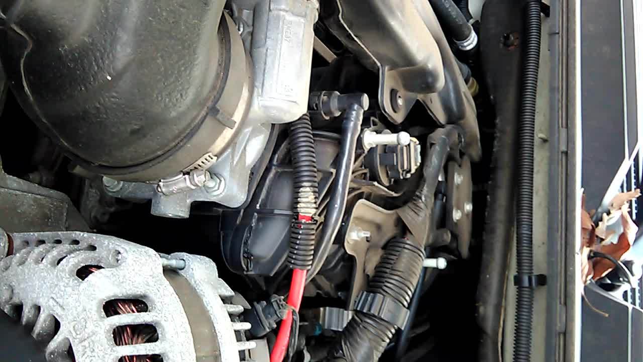

Can you take another video for under the hood if that is where the noise is coming from please? Can you tell where the noise is coming from?

Can you take that plastic cover off the top of the intake? It sounds very close to the throttle body.

Video added, starting it as well.

So what you can do, is start unplugging things and try it with just the key on, not running and see if you can isolate the noise.

Tried disconnecting multiple plugs and couldn't isolate the noise.

Did you unplug the throttle position sensor? And the idle control valve? I've read up on this and it always seems to be the throttle body. And is this drive by wire system? Meaning no cable for the throttle plates, just an actuator that moves the throttle.

Did the throttle body unit, that is what was making the sound.
Dec 8, 2019 at 5:01 AM
SAMIAMINMN
  • 7 POSTS
Replaced the throttle body unit, no more grinding.
