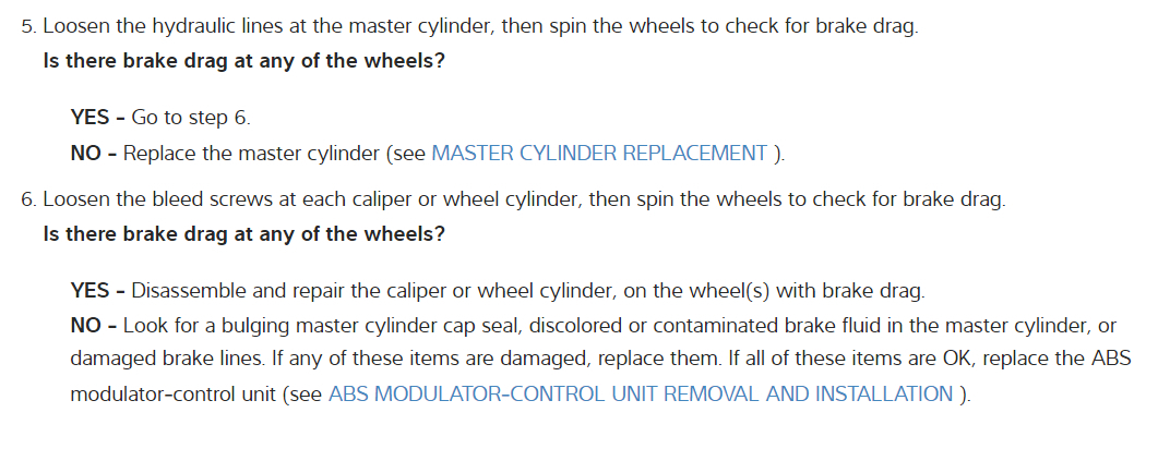

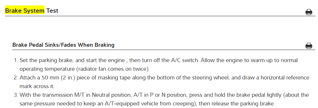

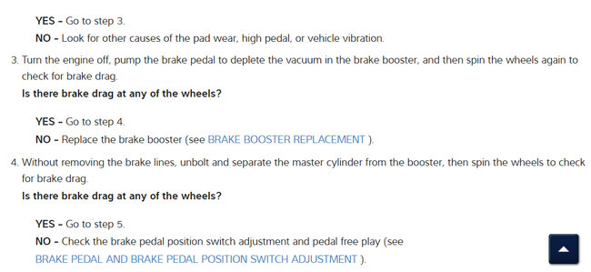

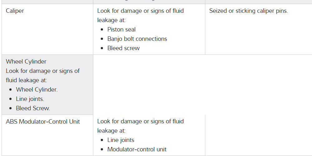

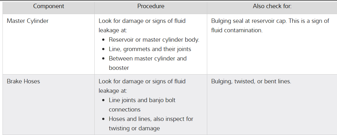

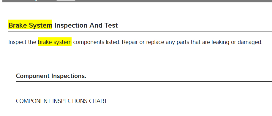

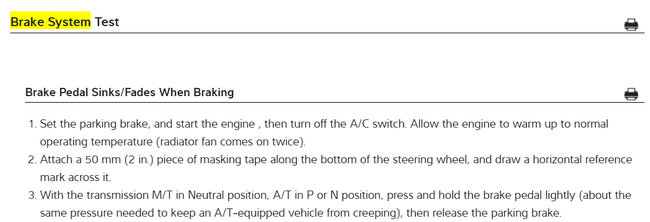

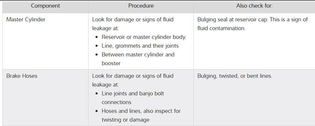

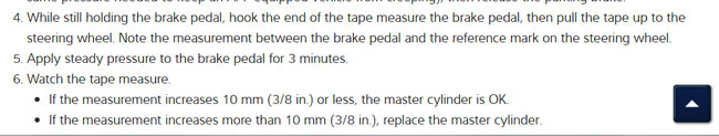

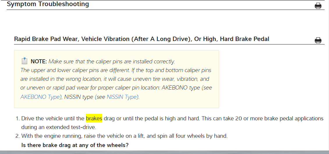

SCGRANTURISMO
  • 4,897 POSTS
Hello again,
I have included in the diagrams down below a factory diagnostic troubleshooting guide for your vehicle's brake system. Please go through it and get back to us with what you find out.
Thanks,
Alex
