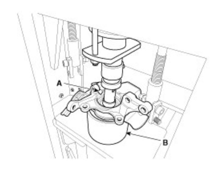

It could be a hub bearing. That is what supports the front wheels at the axle. It is a very common issue for grinding. If it is the bearing, the noise will increase and decrease with road speed.
https://www.2carpros.com/articles/bearing-hub-replacement
As far as the brakes, yes, it could be. Normal wear for brakes is 15,000 to 20,000.
If it were a CV joint it would be more severe while turning.
https://www.2carpros.com/articles/symptoms-of-a-bad-cv-axle-joint

Now, I'm assuming since I'm hearing the noise from the front of the vehicle, that it's the front bearing that's bad. Also, would you recommend replacing hub bearing and a brake service at the same time?
Apr 26, 2020 at 5:02 PM
Not if the brakes are still good. Replace just the bearings.
