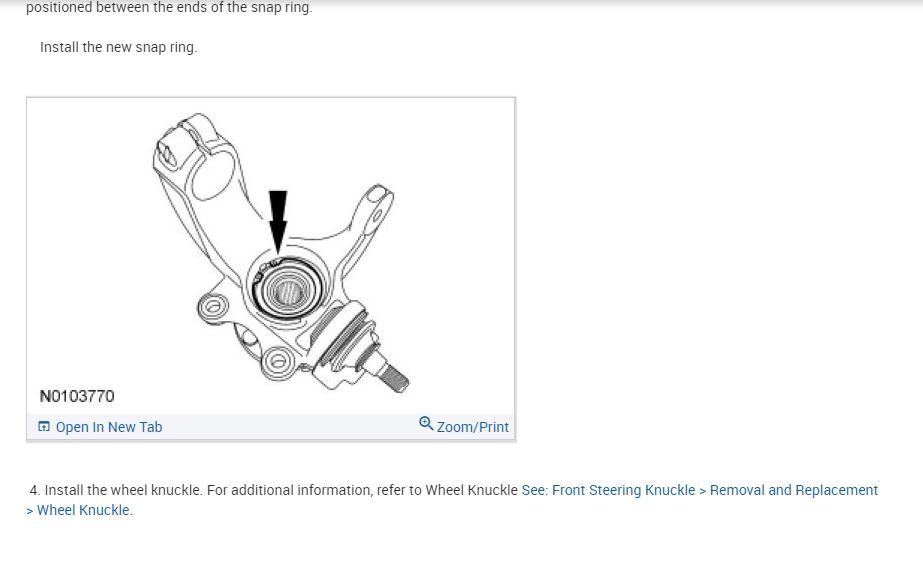

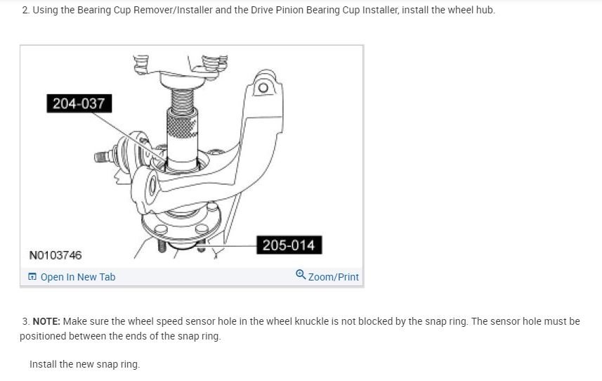

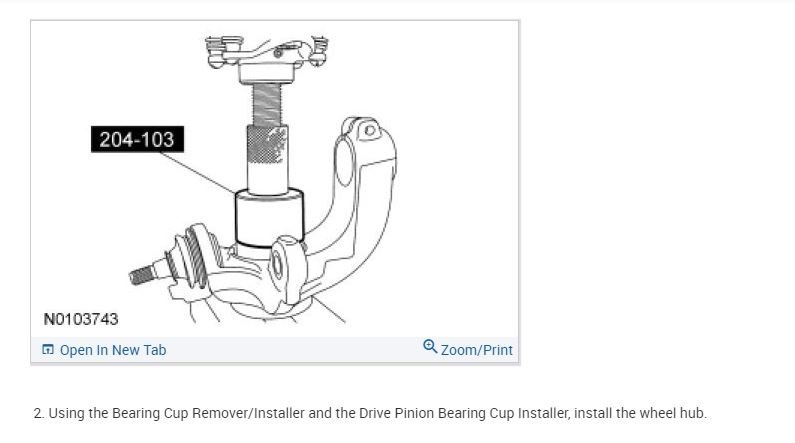

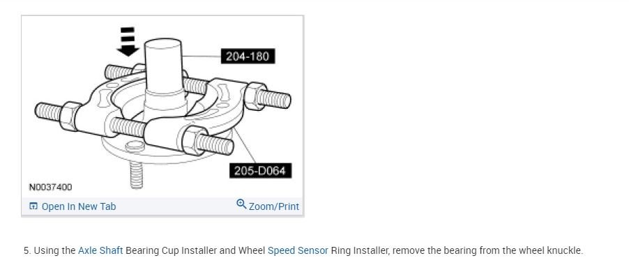

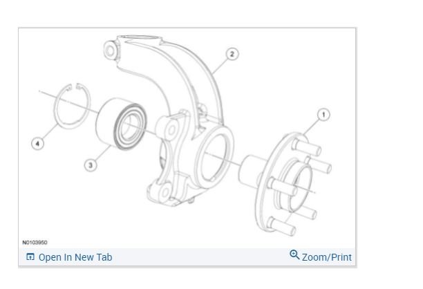

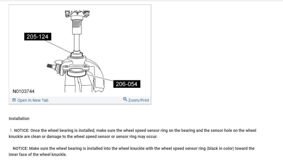

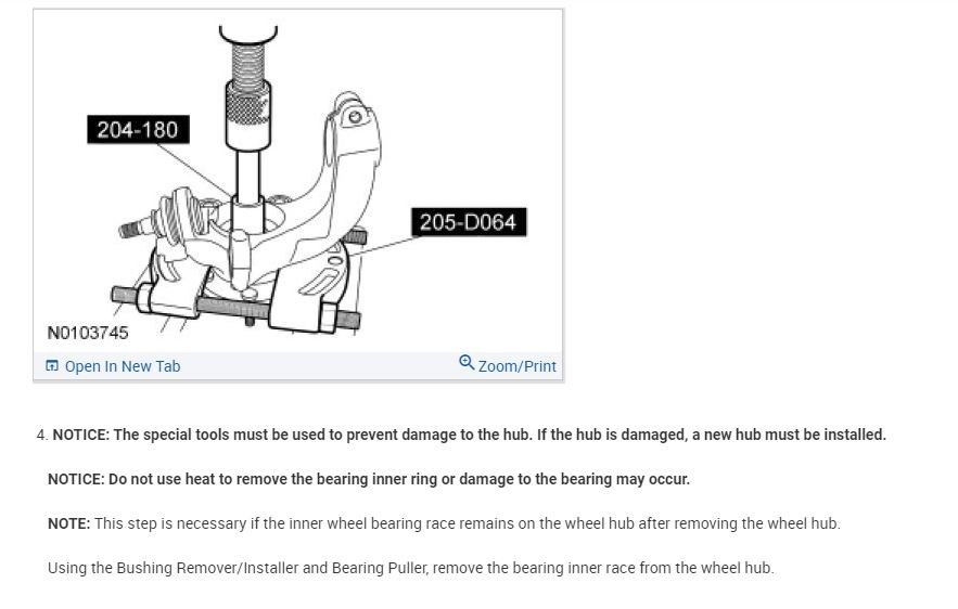

Hello, my 2003 Ford Tourneo Connect makes a grinding noise (the noise seems to come from the right front side) when driving when accelerating it gets louder and when it gets over 100km/h the noise gets not so loud. i've changed the gearbox thinking it was the differential, i've also changed the right wheel bearing thinking it was also that, i've looked at the CV axle it looks good, the bearing on the right CV axle also looks good. i don't know what could it be anymore. what do you think it could be?
Dec 9, 2021 at 3:32 AM
Good afternoon,
This sounds like the wheel bearing is worn out. I attached the procedure for replacing the bearing. I would also replace both sides since one side is bad the other side will fail shortly.
https://www.2carpros.com/articles/bearing-hub-replacement
