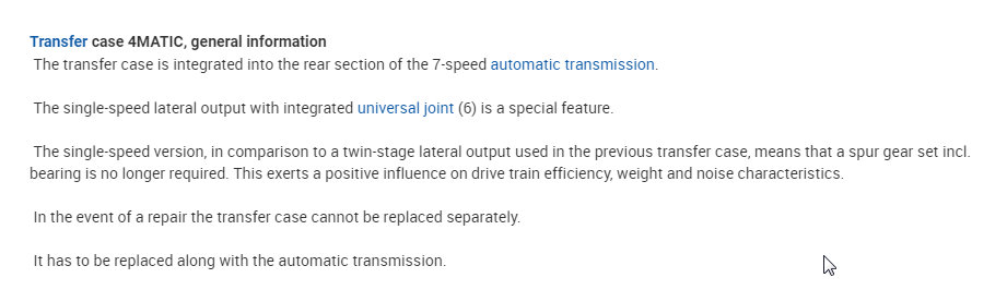

Every time after I brake a little too hard, and then stepping on the gas gives me a grinding noise coming from the center of the car and also a whining noise. It will go away after a couple of miles later. I'm not sure if its the transmission even though it is shifting perfectly fine. I didn't get any error messages.
Dec 14, 2019 at 7:03 AM

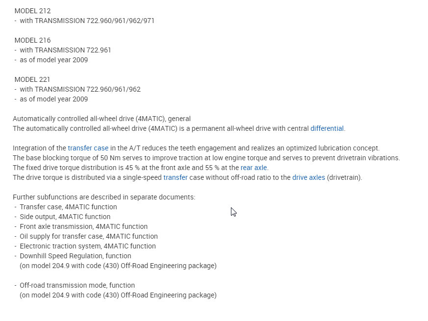

This sounds like it is a transfer case issue. You have what is called a 4Matic AWD system. That means it is normally two wheel drive and then it applies the 4WD system. If there is an issue with the gear or clutch inside the system then it will grind while it is attempting to engage the system. Then it stops a mile or two later when it turns the system off and reverts back to 2WD.
The only way to repair this is to rebuild or replace it.

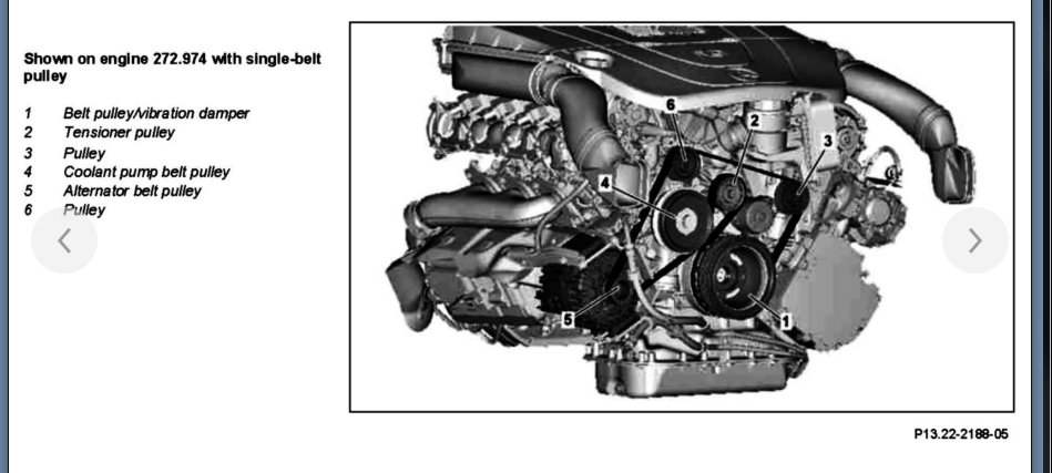

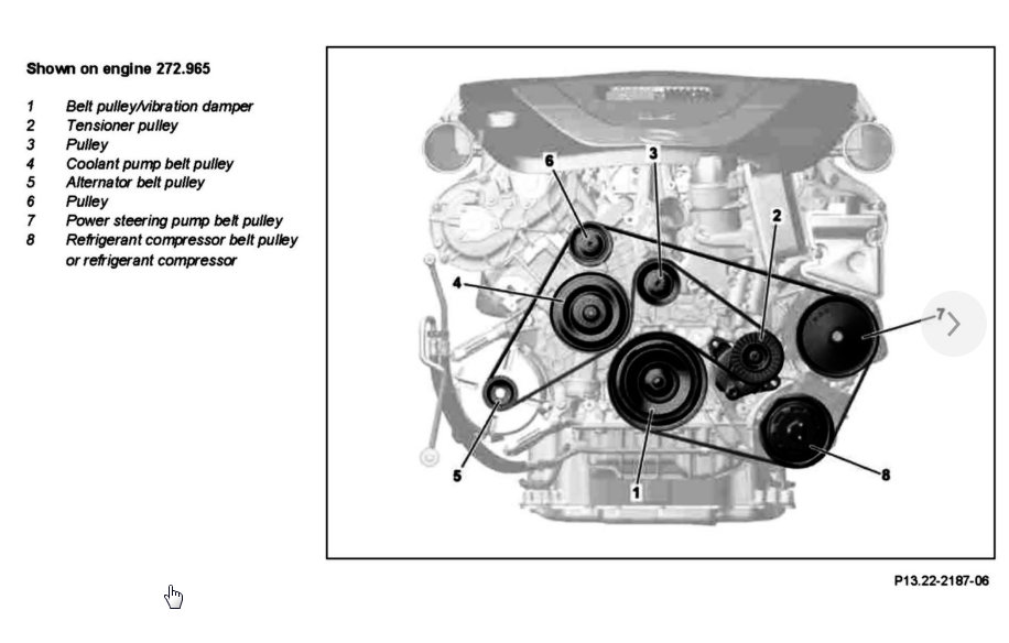

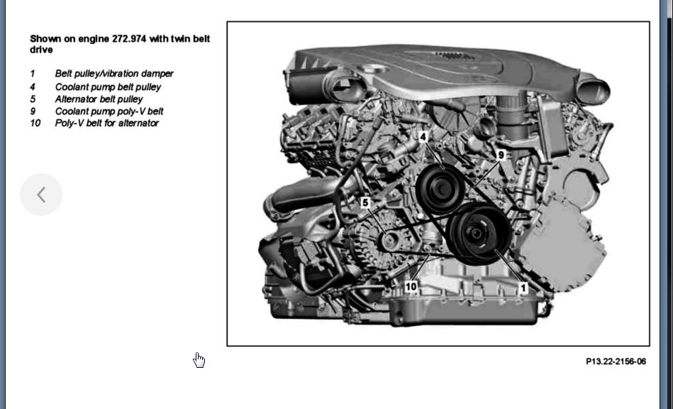

That is what I’m suspecting too, but I could hear that noise even when it’s in park after braking hard. I’m thinking if it’s the alternator bearing.
Dec 15, 2019 at 11:08 AM
Yeah. I would remove the belt and see if it still does it. Let me know what you find.
Dec 17, 2019 at 6:28 AM
JITHIN MATHEW
  • 71 POSTS
I was driving it couple minutes ago and I didn’t brake hard or did anything to make the noise come back. But I made a turn really fast and it made the noise. I’m thinking if it’s the alternator. I will try to take off the belt.

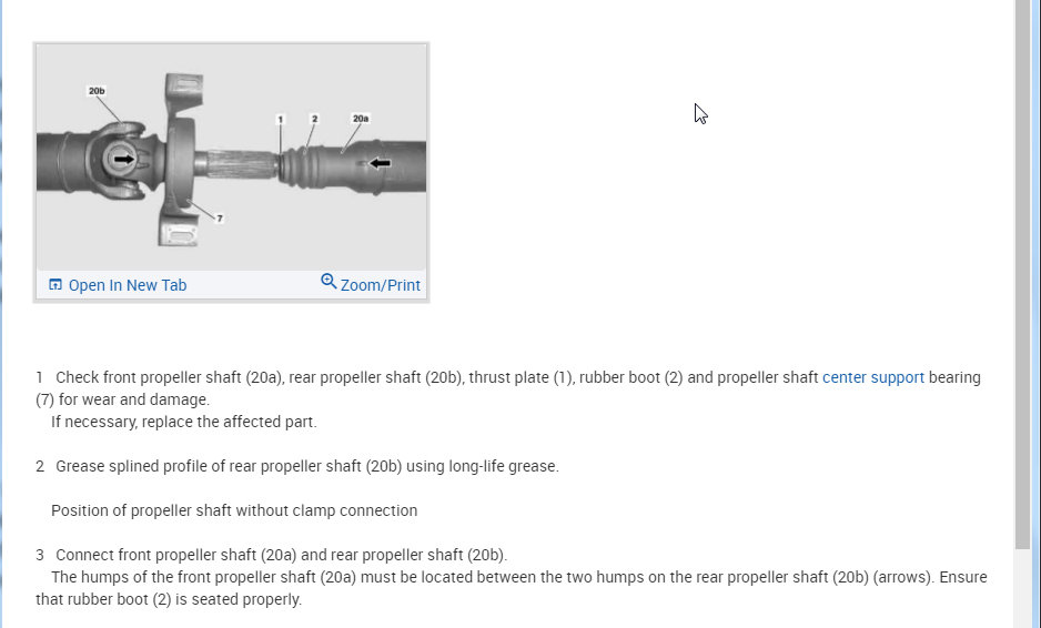

I took it to a independent shop and they said it’s the drive shaft bearing and transmission mount.
Dec 18, 2019 at 7:51 AM
Great to know. However, is there a way they can get a part number to you for the bearing? I just want to make sure we get the info about what that is because I fear that is a little too general and we will get questions in the future about what that part is from others that have this issue. Thanks again.
