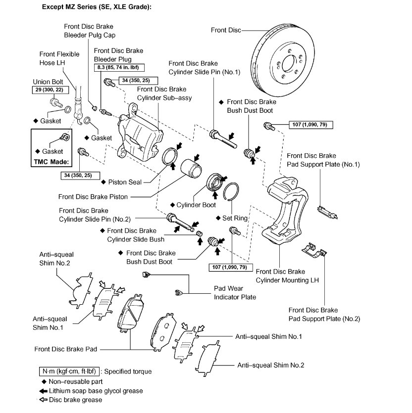

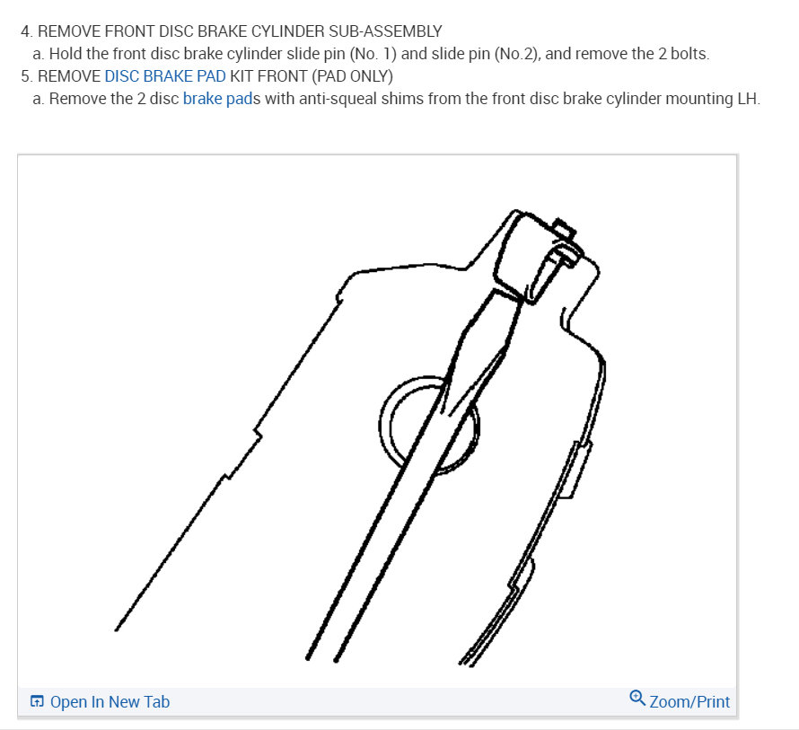

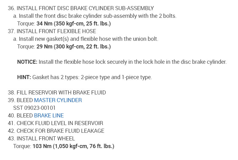

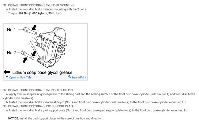

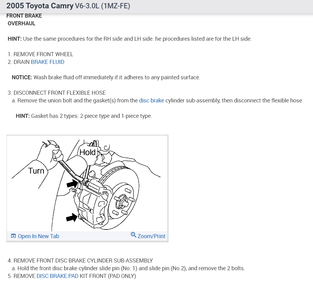

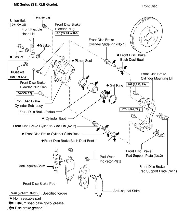

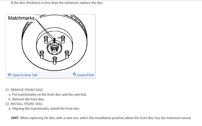

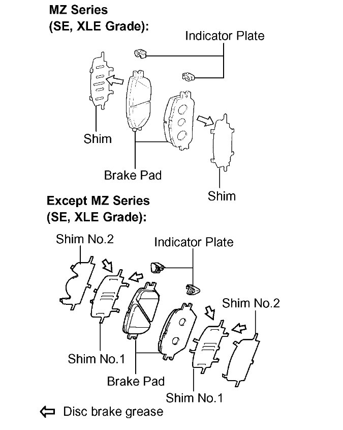

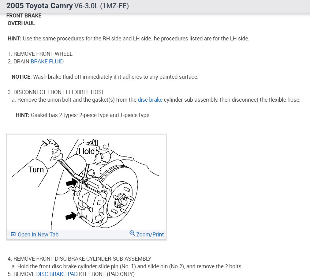

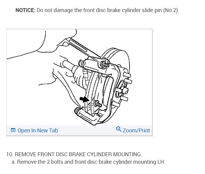

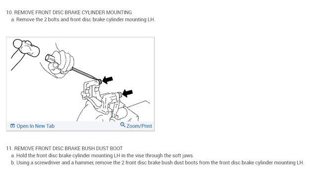

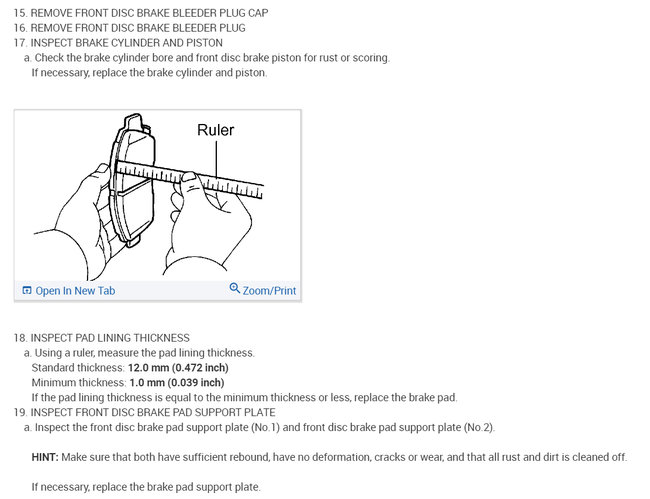

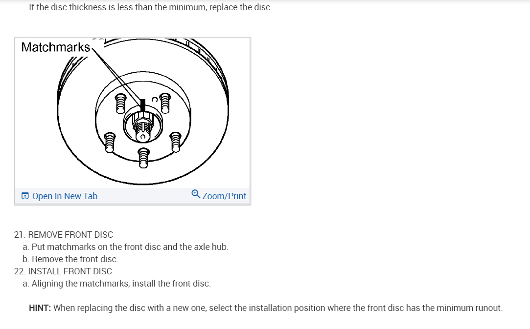

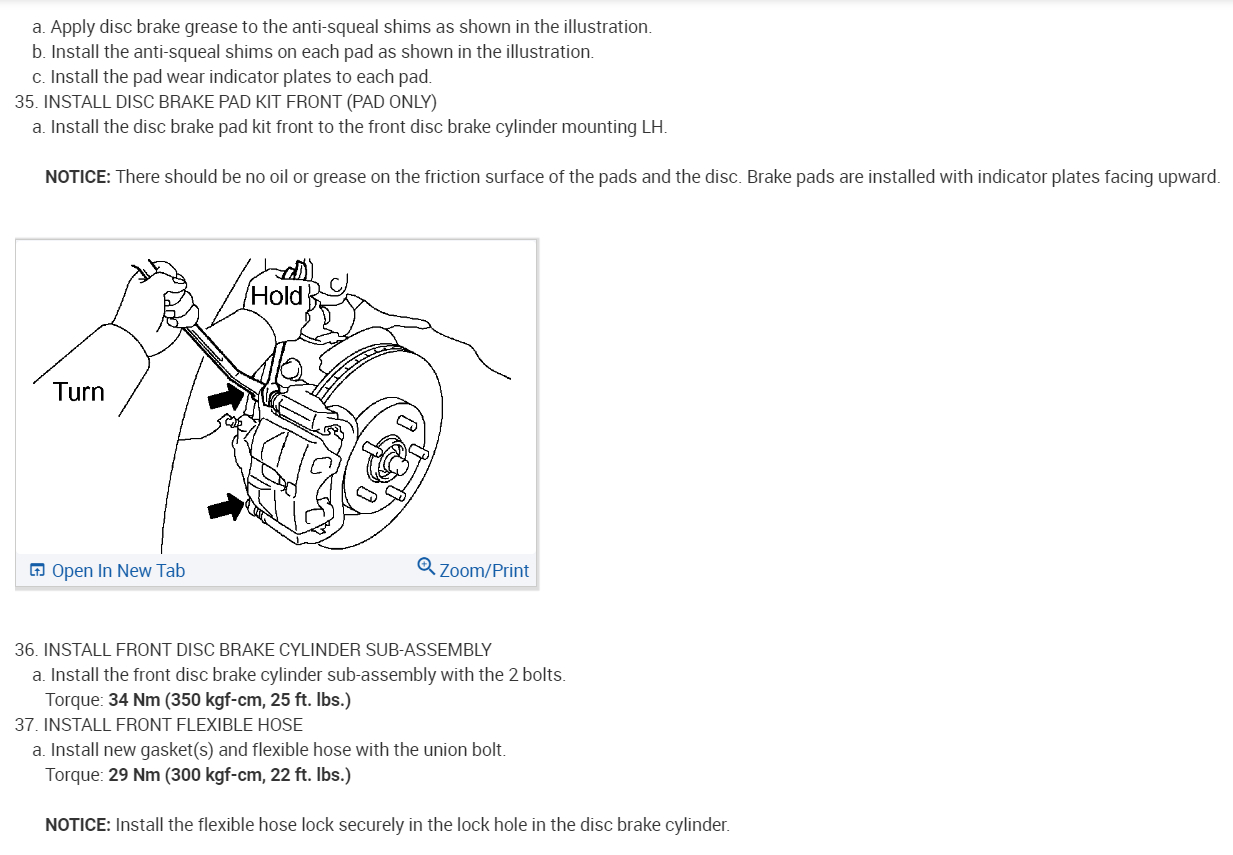

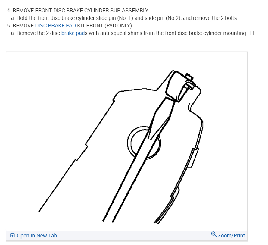

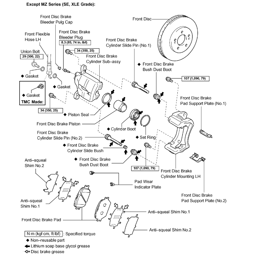

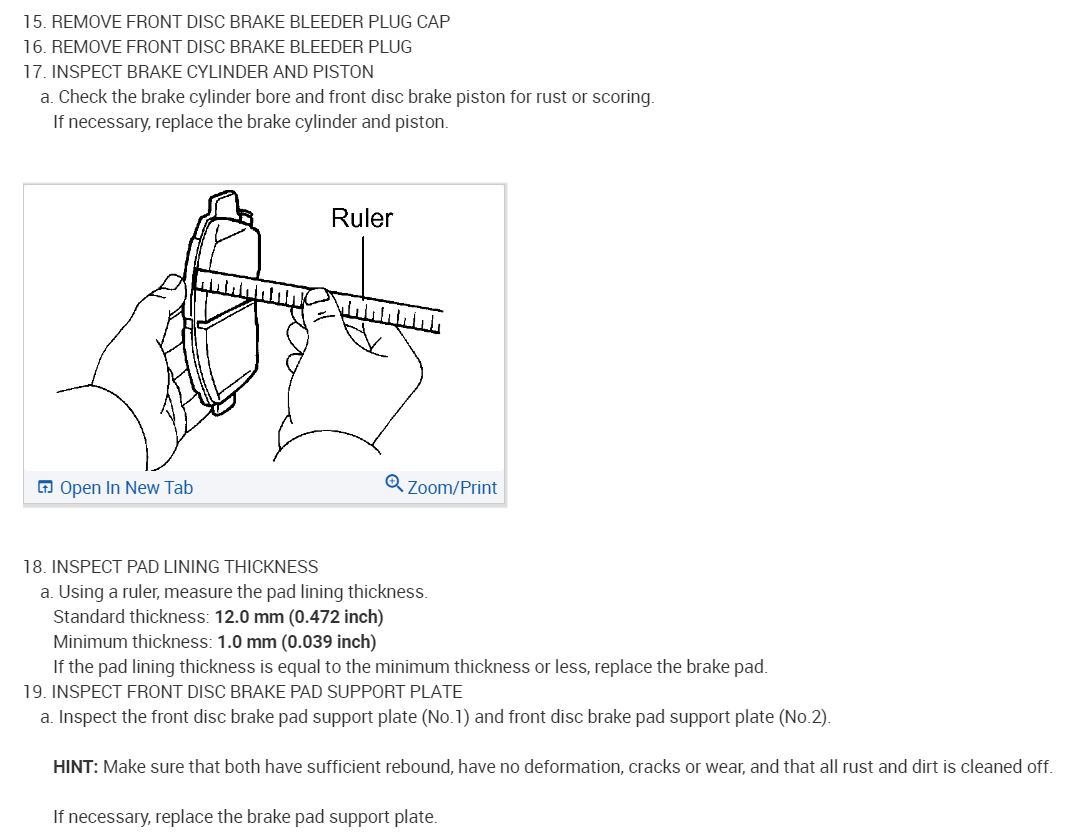

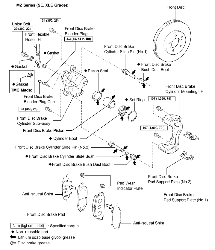

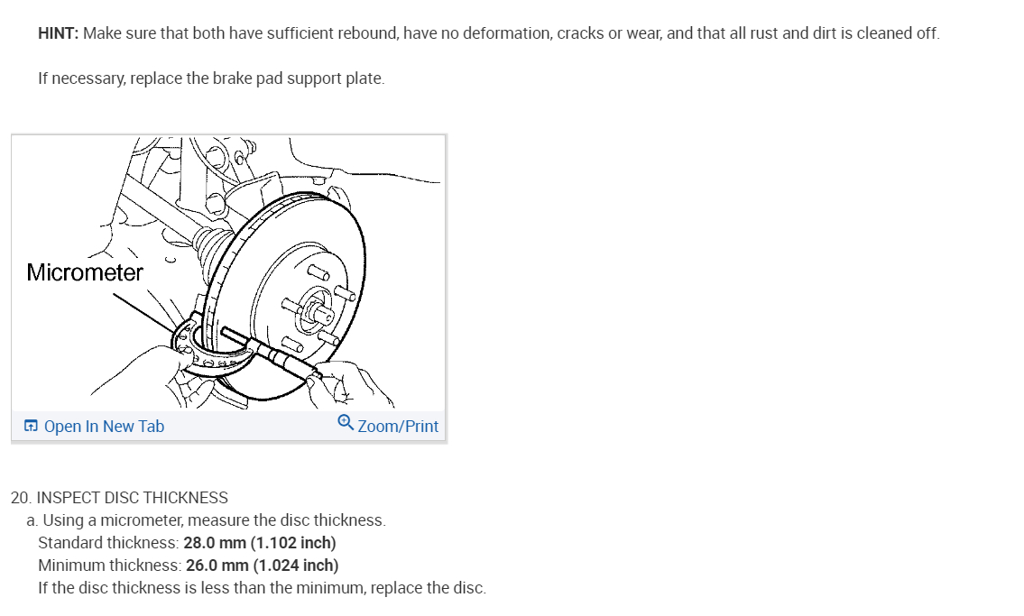

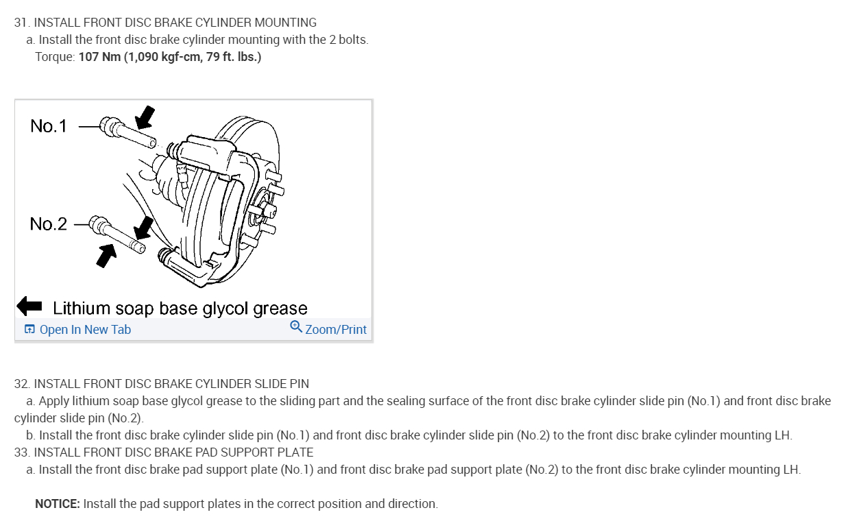

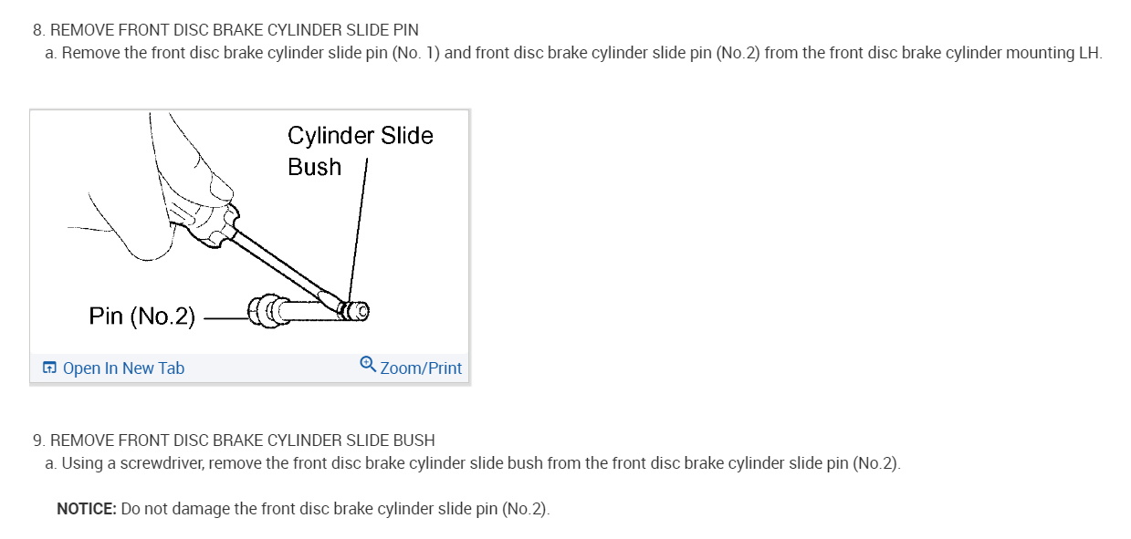

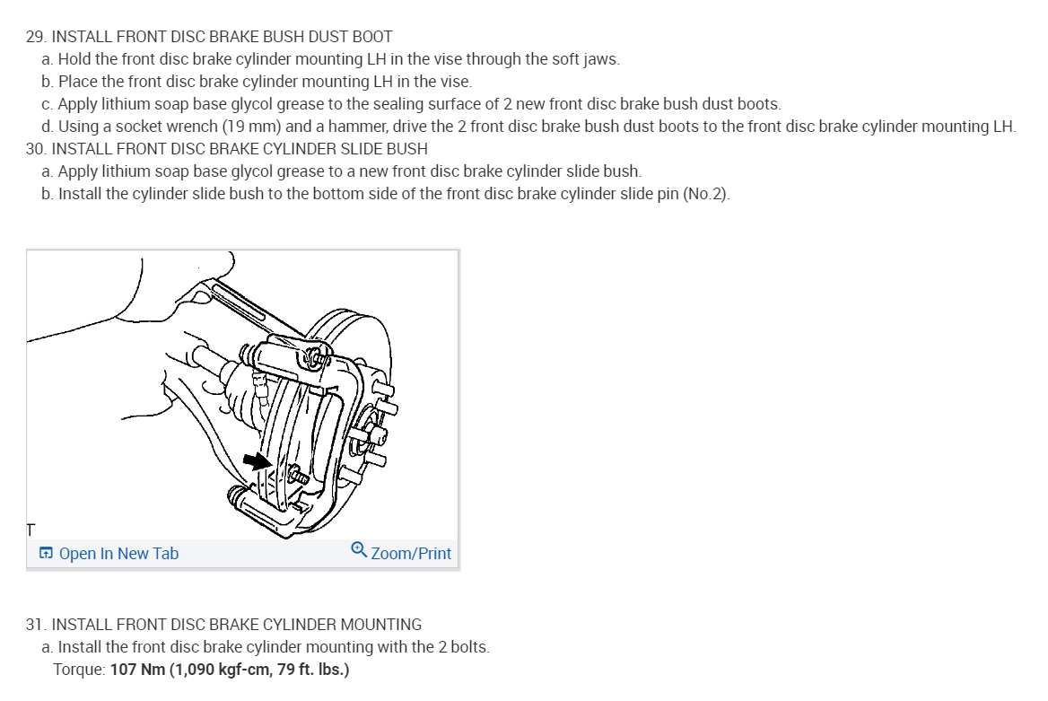

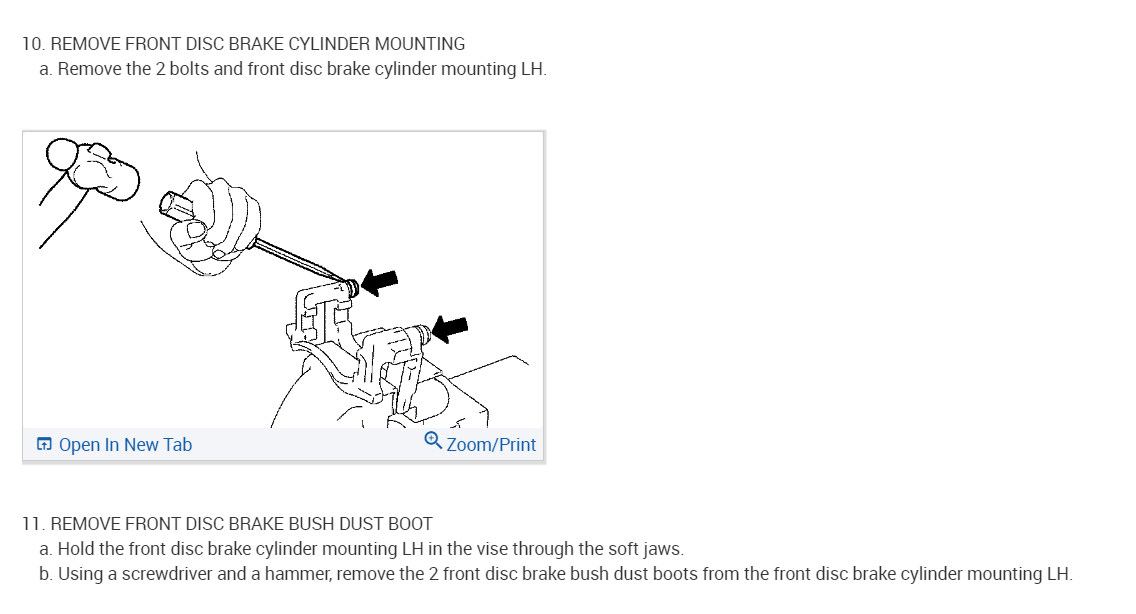

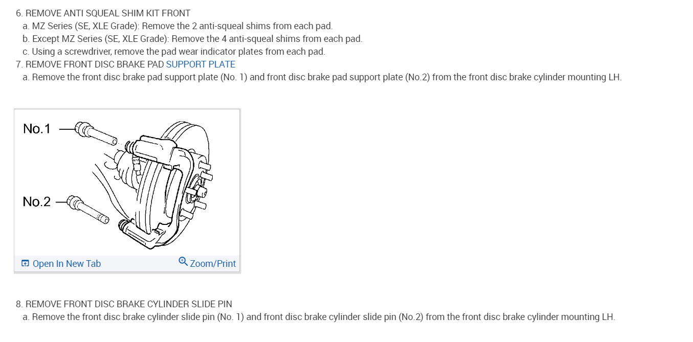

Does the grinding noise change when you apply the brakes? It could be brake pads that need replacement, if you upload a short video of the noise I can tell for sure. Just in case, here is a generic guide on how to change the brake pads out with specific instructions in the diagrams below. This video is the job being done on the same brake system.
https://youtu.be/VtqeB0qgrTs
And a generic guide.
Jun 23, 2022 at 3:20 AM
