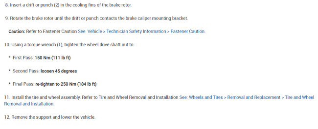

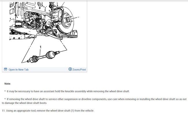

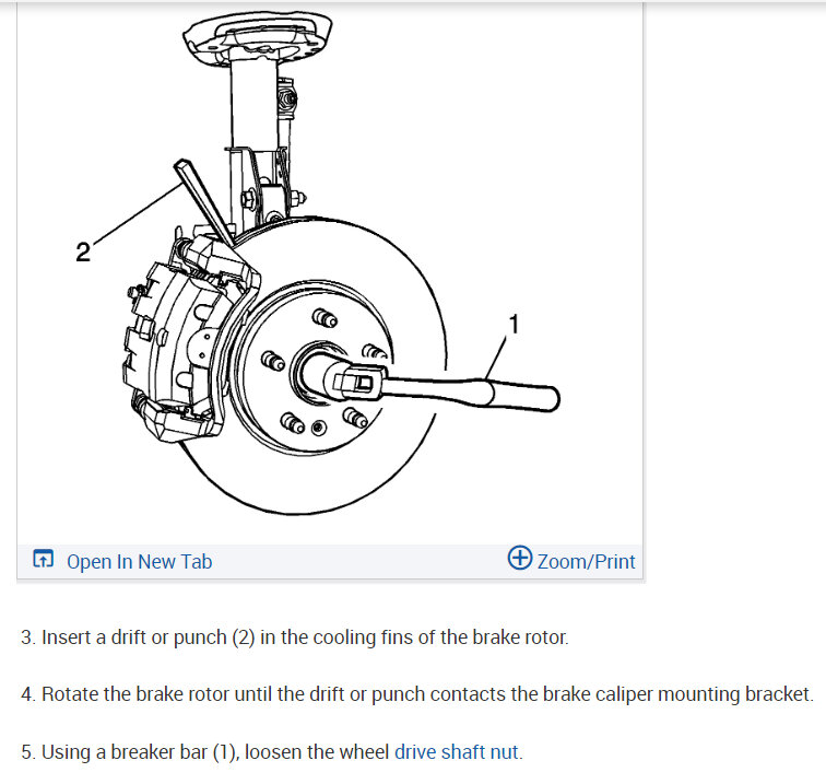

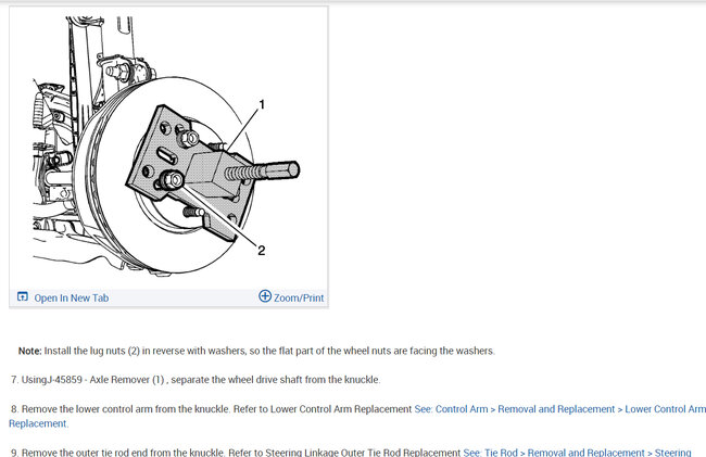

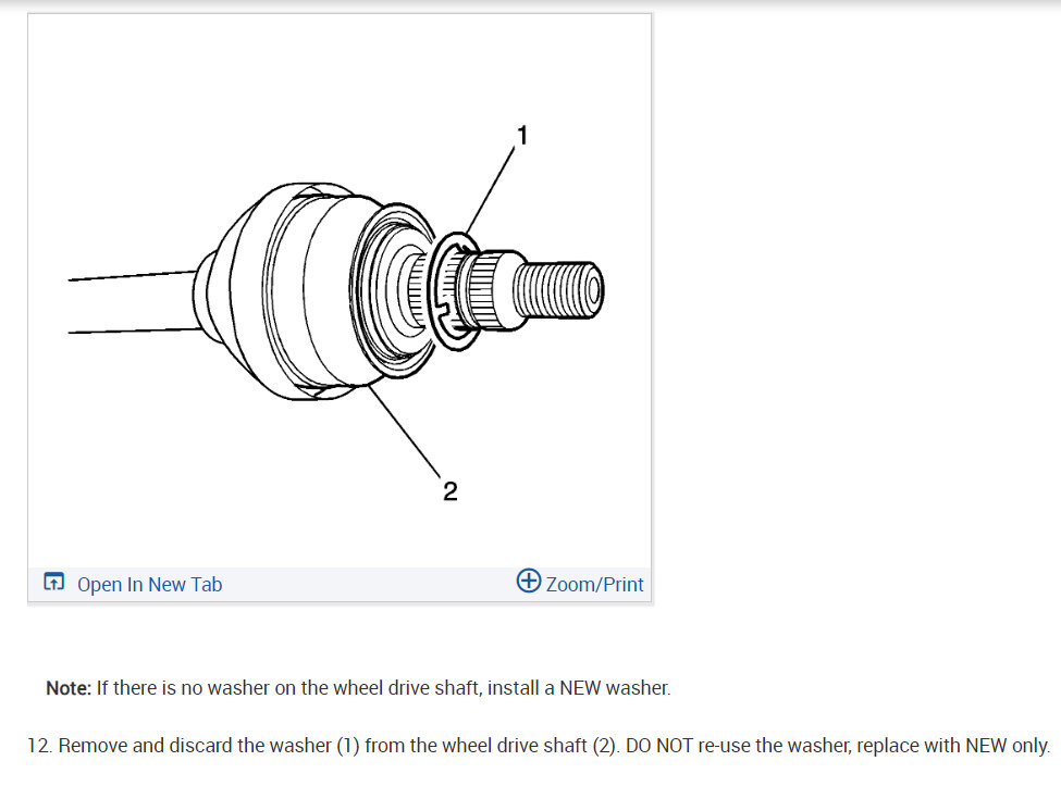

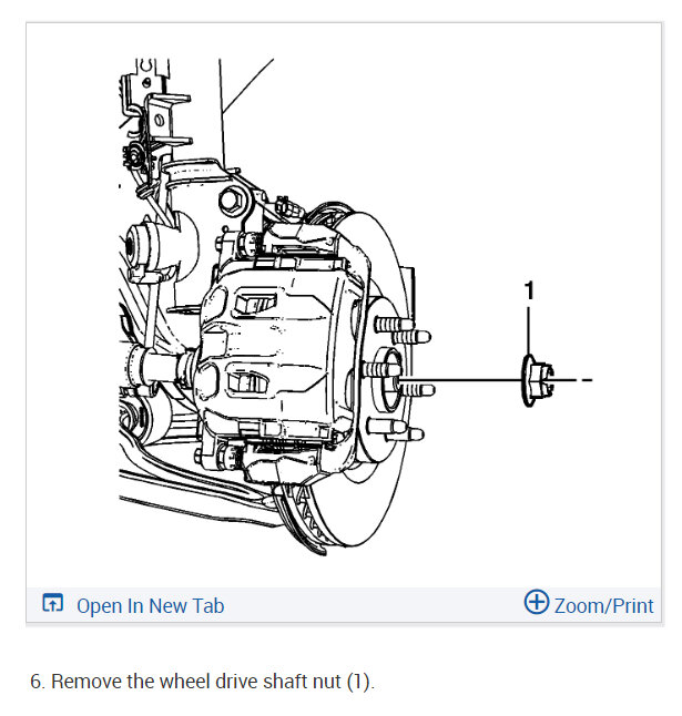

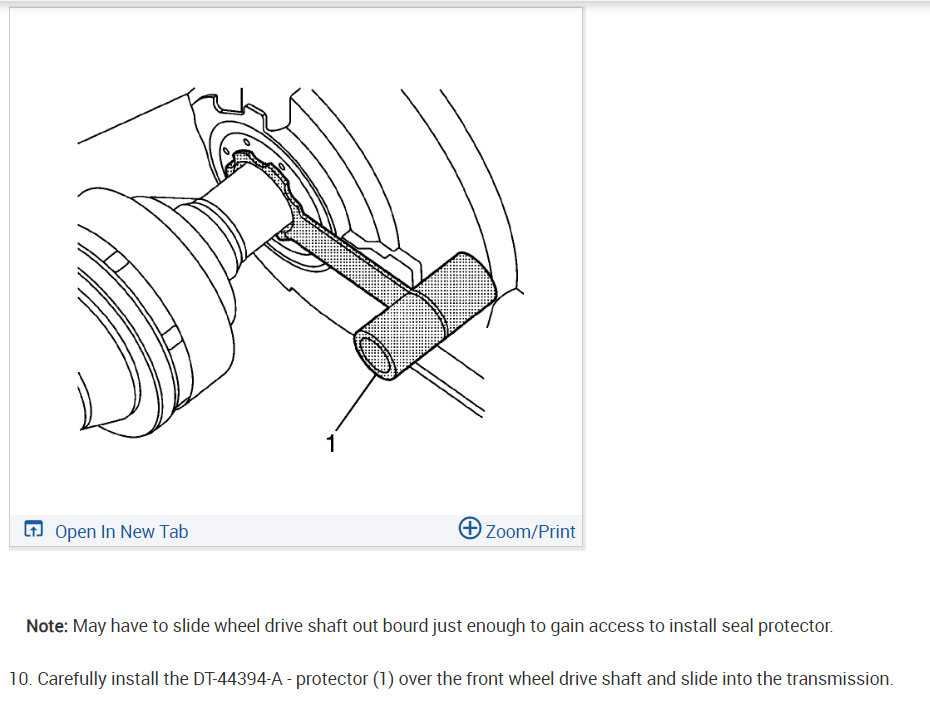

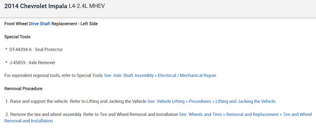

I don't see the video; can you please reload it? It takes a couple of seconds so please allow it to load. To me it sounds like the bearing hubs or CV axle needs to be replaced. To see if the CV axles are the problem they will need to be completely disassembled to inspect the cups for wear. Also, bearing hubs are a common repair as well. You should be able to raise the car up grasp the top and bottom of the wheel and try to move it to check for play (both sides).
This guide can help:
Here is how to remove the CV axles as well so you can see. Check out the images (below). Please upload pictures or videos in your response to the problem so we can see what's going on.
