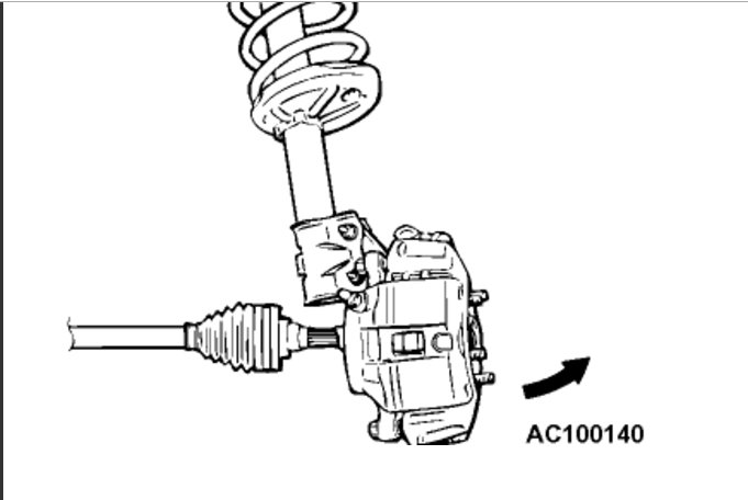

I am getting a low grinding noise when I am going slower speeds! Like five to ten mph. stops when I have foot on gas but as soon as I let off it starts. So if I just coast along in gear at these speeds while having my rpm's about 2000 something grinds. What could this be?
Aug 18, 2017 at 1:30 PM
  • 55,691 POSTS

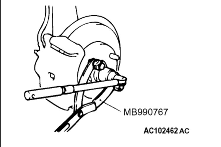

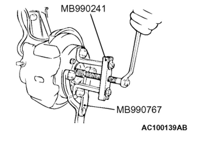

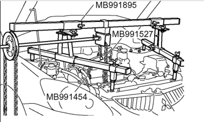

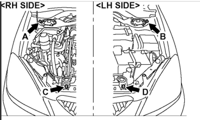

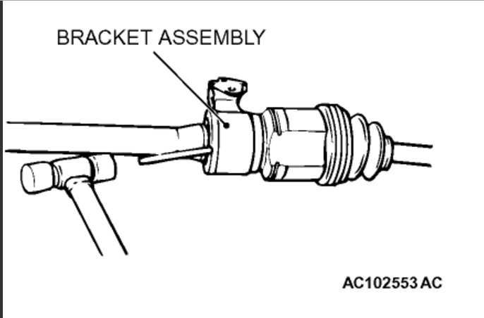

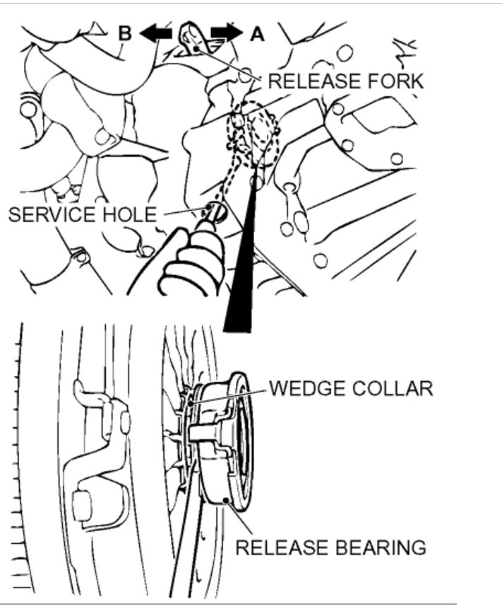

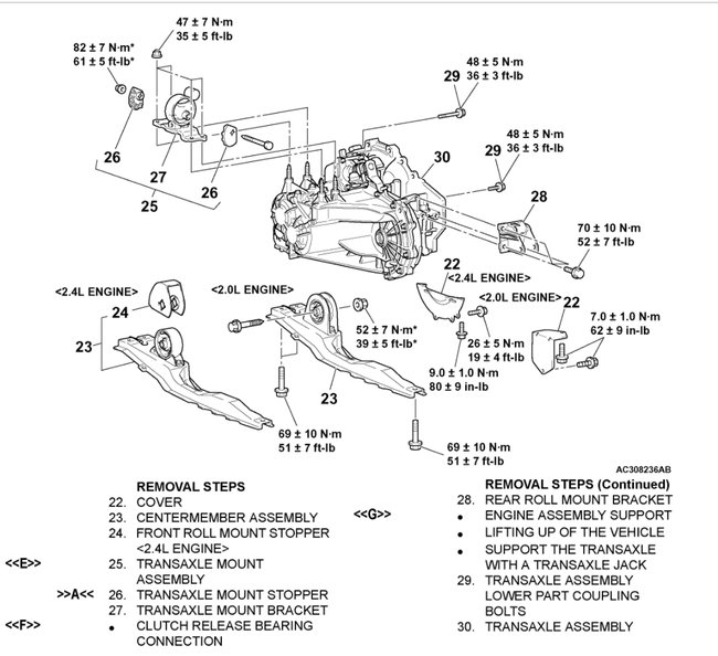

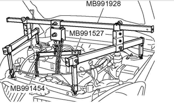

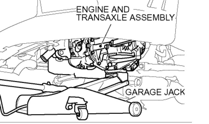

If you can make a video of the noise it would help and send us a link. but, it sounds like the final drive gears in the transmission are no good. In this case you will need to replace the transmission.
This is a guide on a rear wheel drive car but it give you an idea of what it will take
https://www.2carpros.com/articles/transmission-replacement-removal-manual
Here are some diagrams to help you get the job done:
