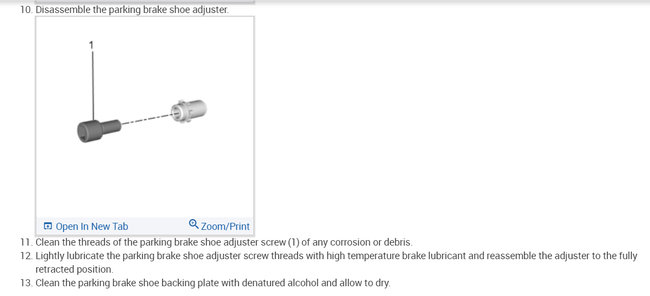

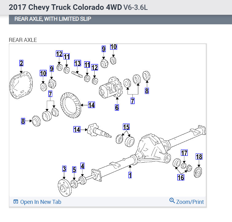

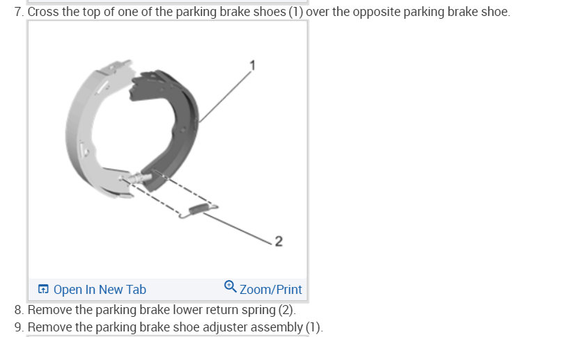

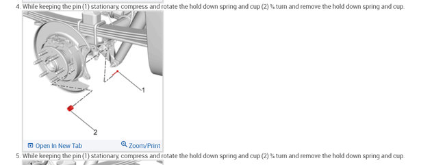

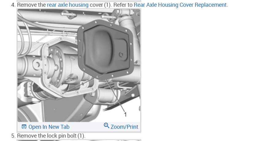

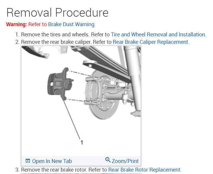

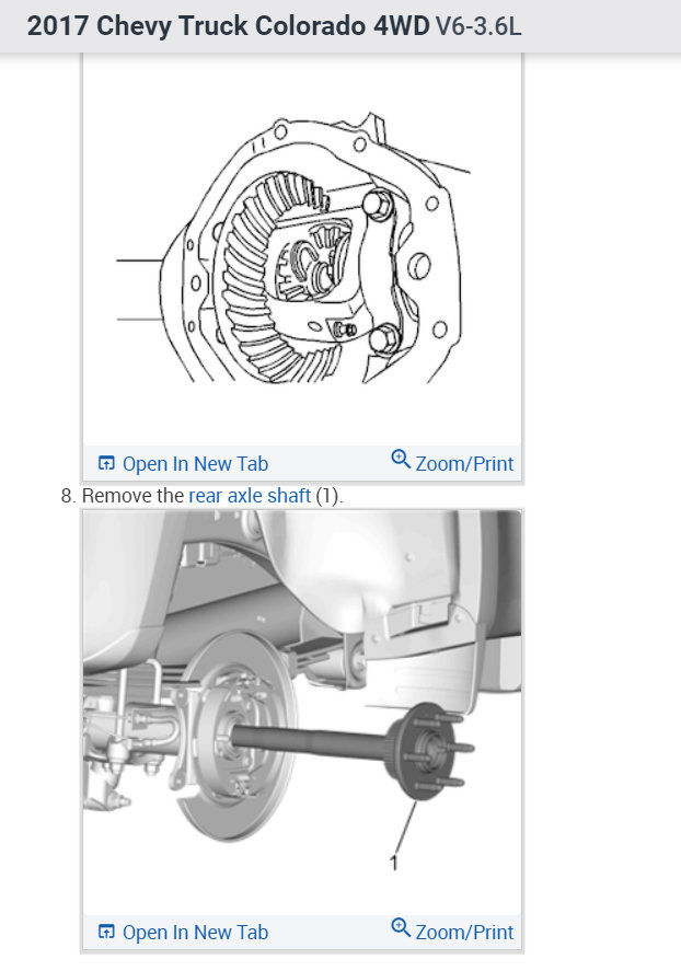

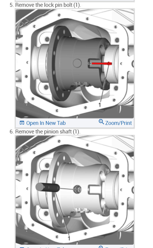

I have a grinding in my driver's side rear end that's started up about 3 weeks ago. I changed the brakes and rotor hoping that would fix it and nothing. It only happens when I'm making a right turn but when I check the wheel bearing it has no play in it. I've run out of ideas on that it could be.
Jul 2, 2022 at 3:39 AM
  • 55,721 POSTS

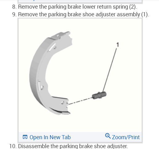

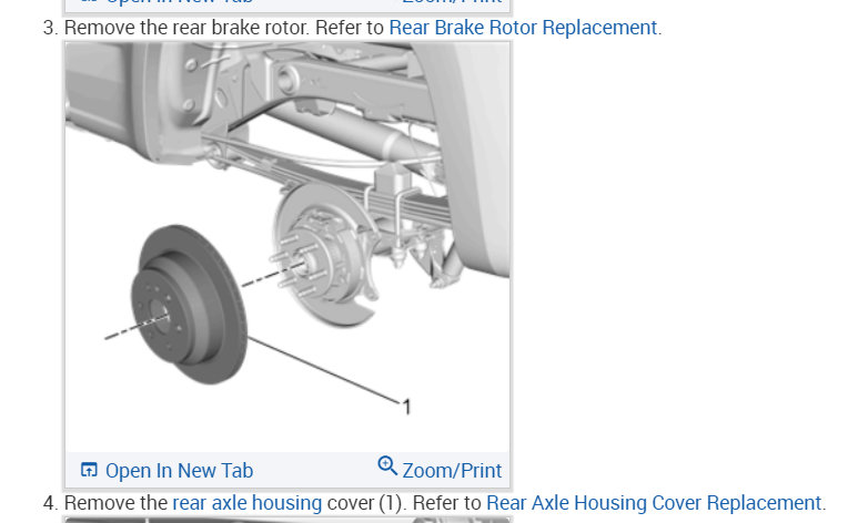

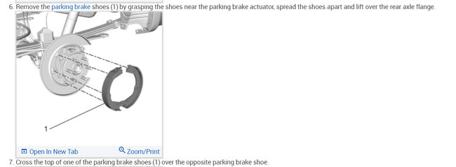

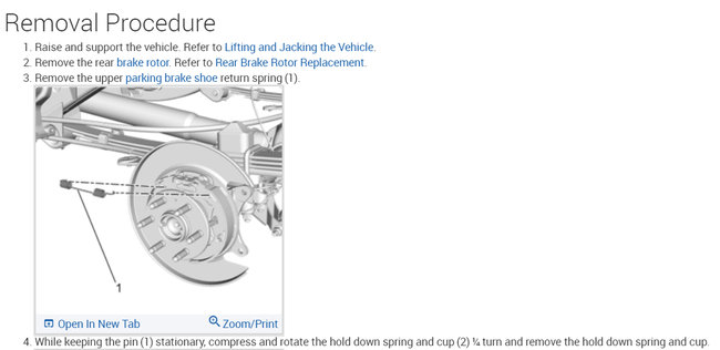

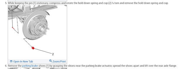

Noises are hard to tell over the internet unless you upload a video of the noise, I know that sometimes when the axle bearings go out it can cause a grinding noise. I would check to make sure it is not the e brake shoes hitting the rear rotor, I have seen that as well. Here are some exploded views of the brakes and axle bearing in the diagrams below to help us see what's going on. This video can help as well:
https://youtu.be/ytqXLSjHNm0
