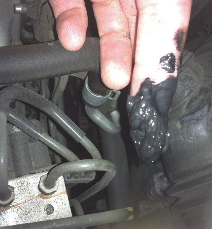

I took my car to brakes plus to get it aligned when they said i needed a new rack and pinion. when they showed me the car, i saw that a portion of the boot on the driver side was wet. but there was no grey sludge at this time. However, when i got home and jacked up the car i noticed grey sludge coming from all over where the input shaft and valve body housing of the rack and pinion would be. Is this coming from the rack and pinion or do I have another issue as well?

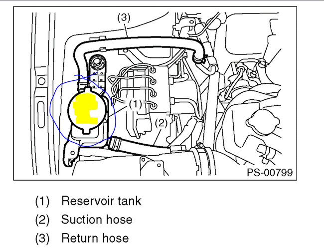

If you have a power steering leak, it would be power steering fluid. Check the color of the fluid in the power steering pump reservoir. Is it gray? It shouldn't be.
I attached a pic below showing the cap of the power steering reservoir. Check it to confirm if it is full or not and the color of the fluid.
Also, if it is possible, take a pic of the leak you see and upload it for me to see.
Take care and let me know what you find.

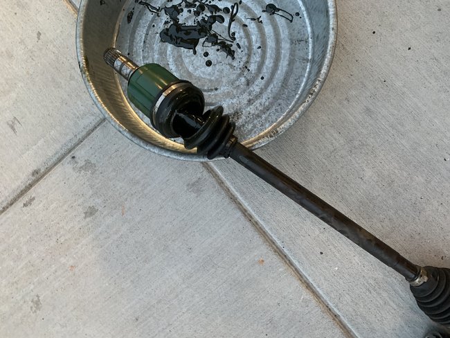

yea, so my power steering fluid is red and i can’t take a pic of my car now but i can upload what it looks like which is the image you’ll see. the only thing is it has been splashing back and reaching the near rear of the car with this thicker liquid or grease. it looks as though it starts right next to where the input shaft for the rack and pinion is too.

That looks like grease from the CV joint. Take a look at this link:

You were right. I took it out earlier today and it was nearly torn completely!

I had a feeling that was it. I'm glad they didn't replace the rack and pinion. Ugh!!! I have no idea why they thought grease would come out of the rack. That made no sense to me.

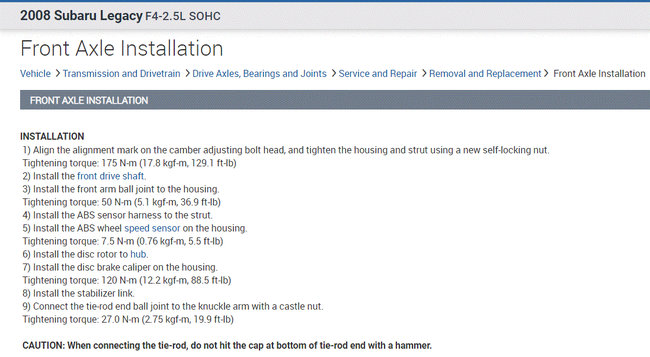

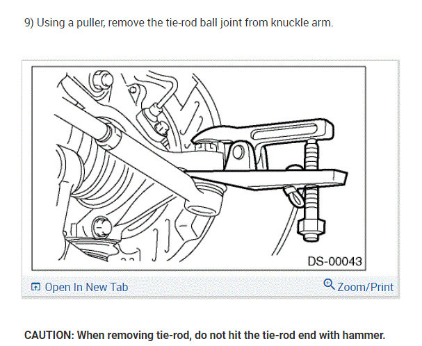

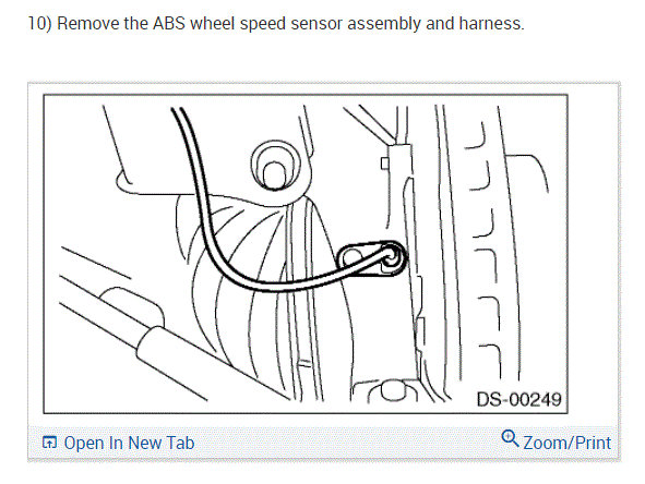

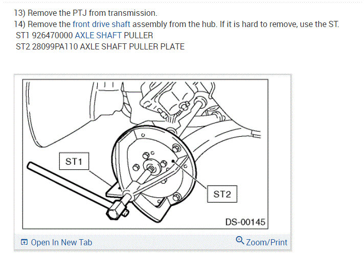

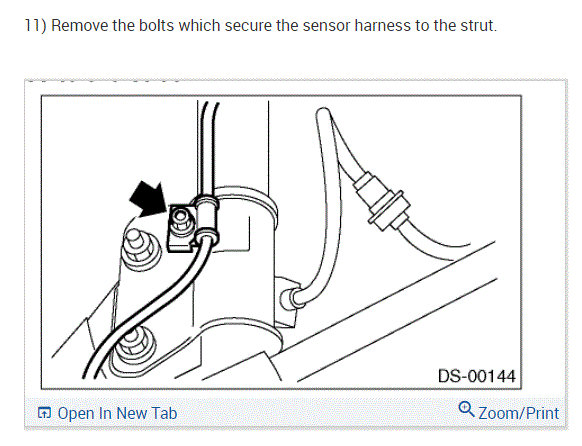

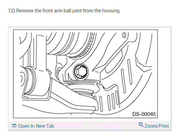

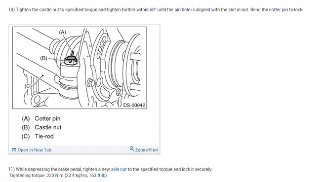

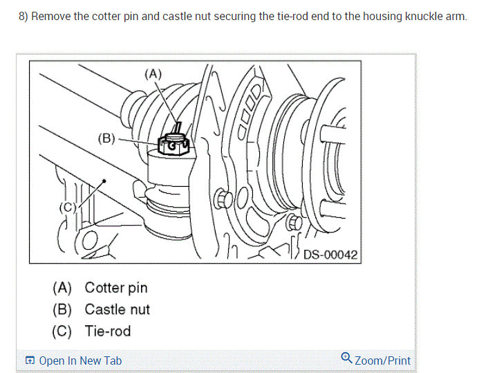

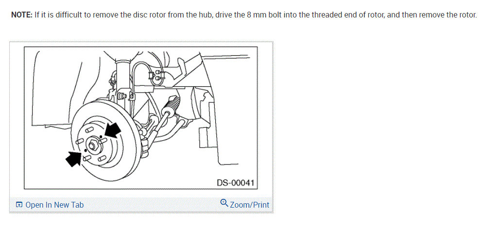

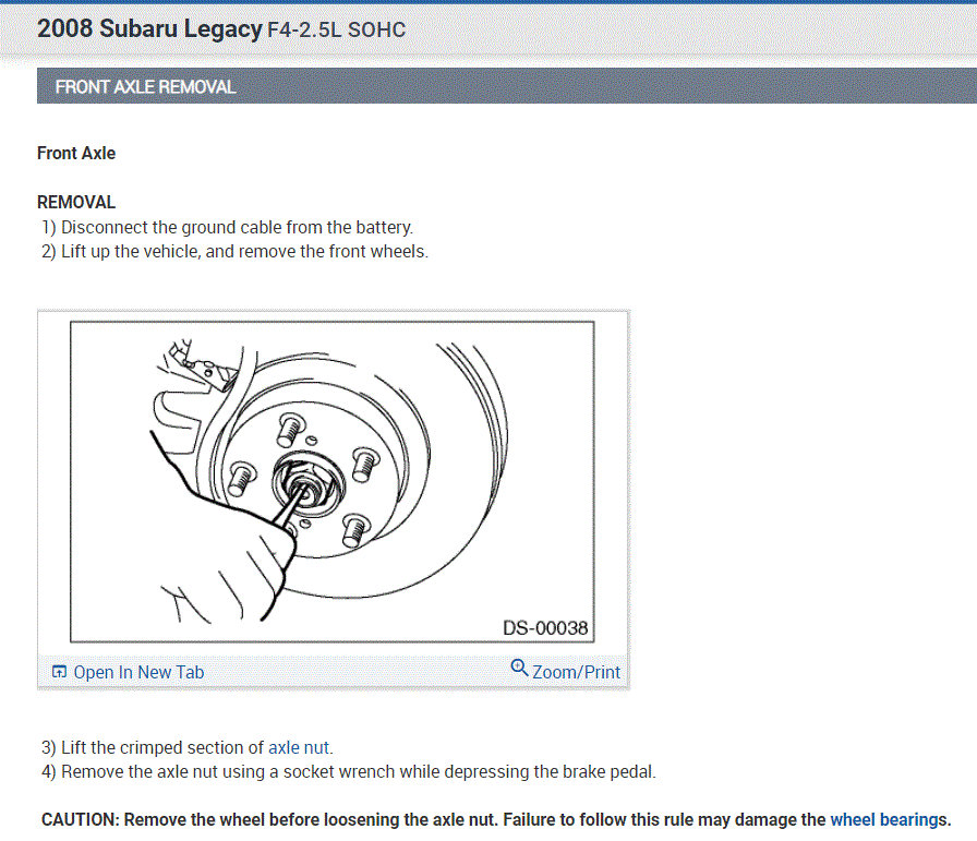

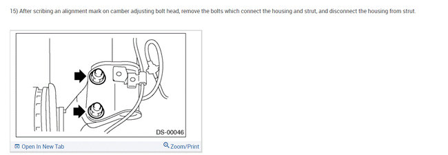

As far as the axle, I'm including the directions for removal and replacement. The directions will include torque specs. I realize you already have it out, but thought I would add them in the event you need to reference something. Also, here is a link that shows in general how it's done:
https://www.2carpros.com/articles/replace-cv-axle
Take care of yourself. Let me know if there is anything I can do to help and feel free to come back anytime in the future.

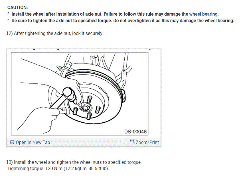

When you installed the axle, was it fully seated? Also, did you properly torque the axle nut?

I do believe it was fully seated. we test pulled on it just enough to make sure it was all the way in, and heard it click in as well. i do believe we torqued the axle nut all the way (to 162 ft-lbs). it was the drivers side and it makes the noise when i turn left. it happens on bumps sometimes but more so when i turn slightly left.

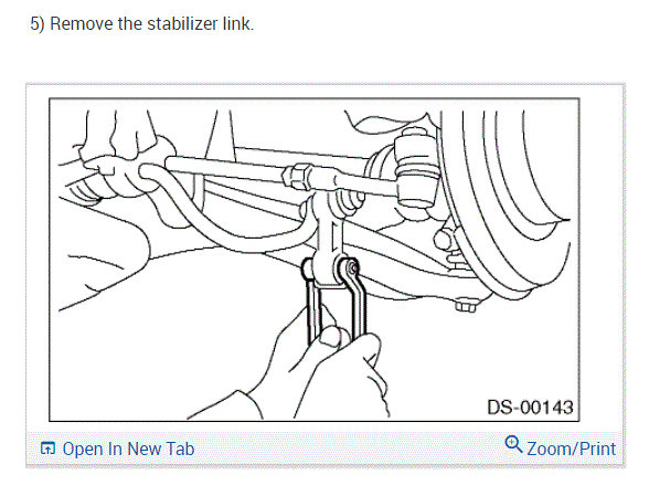

If it seems more likely to happen when you hit bumps, something must be loose. Did you recheck the stabilizer link to make sure it's tight?

yea. we never loosened the stabiliser link from what i remember, but i will check.
